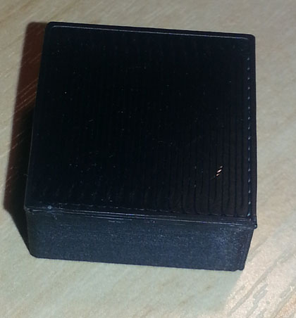

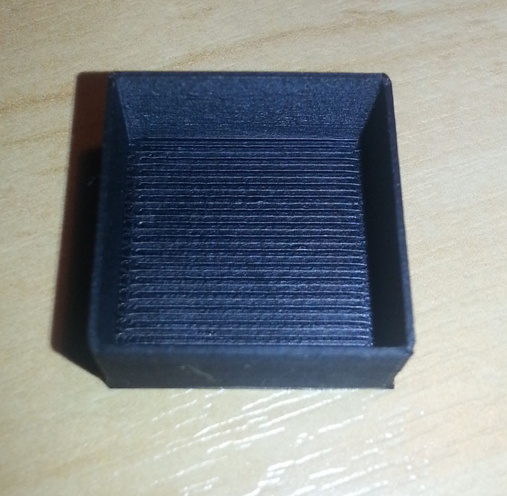

Re: calibration issue
Ok here are the results after calibration; Multiplier is 0.917. The wall thickness is 0.55mm and the size of the box is 19,93 x 19.93 x 10.08 mm. Below 2 pictures of the printed box after calibration. Seems to me quite well. what is your opinion?
Hi Guys, Yeahhh that was the solution. I printed the box with the parameters all set to 0.55 and the multiplier to 1. The wall thicknes is now 0.61 and the sixe of the box is 19.93x19.98x10.08 mm. Also the bottom layers looks much better. Thank you all:) I will continue the calibartion and will let ...

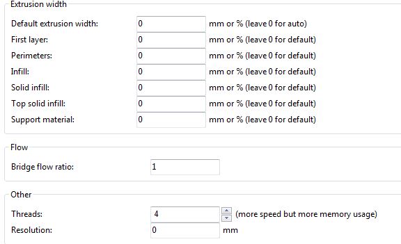

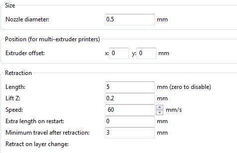

They are alle zero, see screen print and also the extruder settings
Hi Cleveralias, I am using Slic3r version 0.9.10b. I see only a raft parameter at the support material and it is 0 layers. Where can I find the settling for the first layer extrusion width? But the main issue is the wall thickness when I print a calibration box. I have to set the multiplier to 0.618 ...

calibration issue
Hi, I finished my rostock build and made a few prints which were looking quite oke. I started to calibrate the extruder. The first step calibrating the e-stepper; heat the extruder and feed 5 cm ABS and measure the actual length en change the e-steps, feed again until the actual movement is also 5 ...
