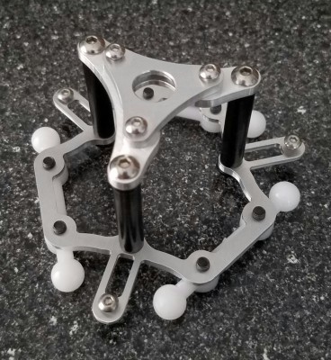

Aluminum Ball-Joint Platform for E3D Hot End available NOW
New version in stock now. Designed specifically to mount the E3D v6 Hot End on your Rostock MAX Precision machined aluminum effector platform and Groove Mount. Includes correct length carbon fiber stand offs for the E3D Includes ball joint bar-bells. Center has been opened up to provide clearance fo...
