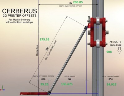

She isn't as busty as I wanted, but she has some nice legs! lol
And picked up a new Mega and it recognizes and uploads.
Working on firmware now. Results not inspiring....

Is there a formula for the arm length that I need to conform to? I read in the arduino marlin/repetier firmware that you have to input the arm length. I'm sure there is some type of optimal ratio.... Right?

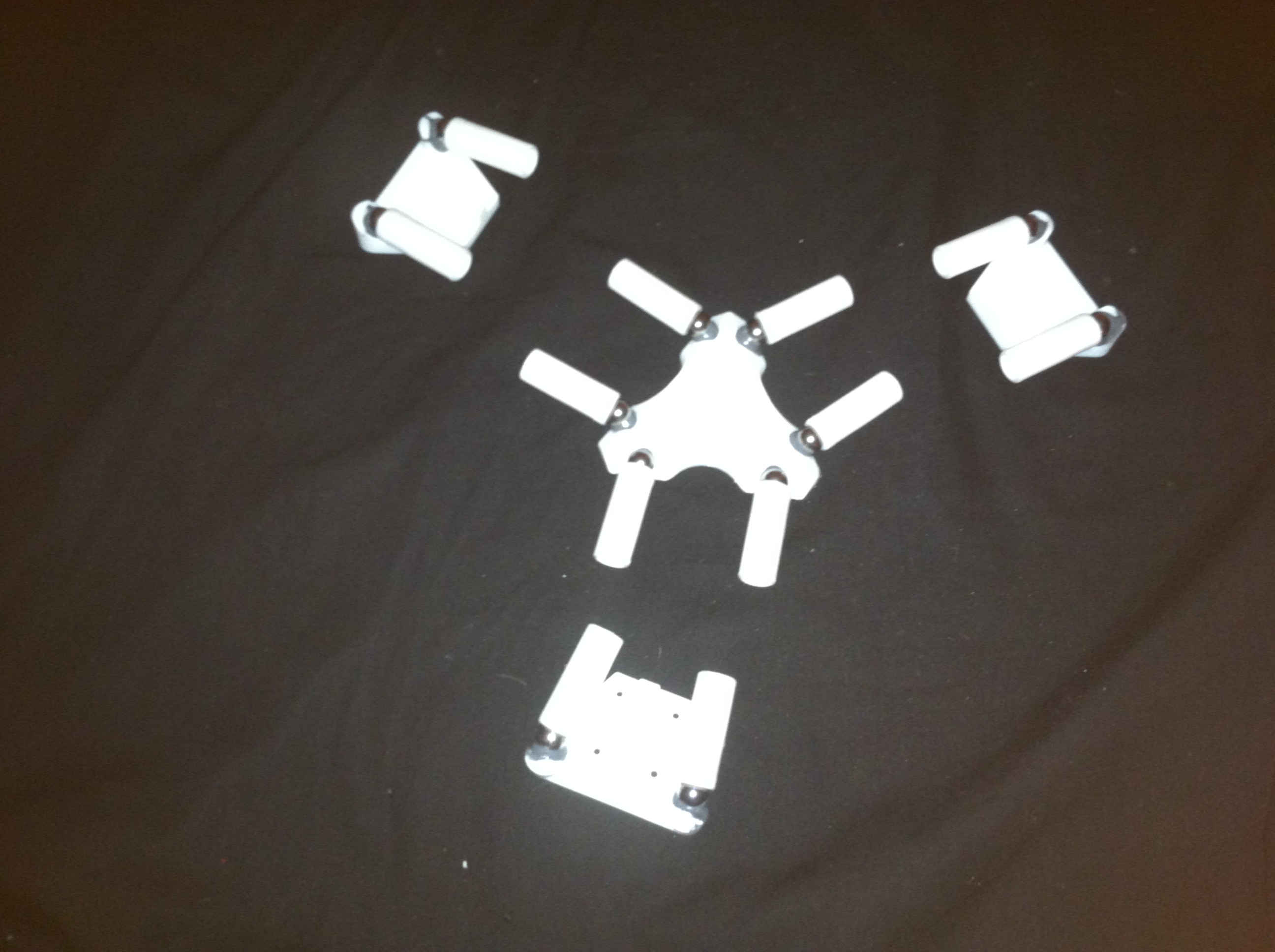

I received the eflector kit in the mail, a dab of JB weld

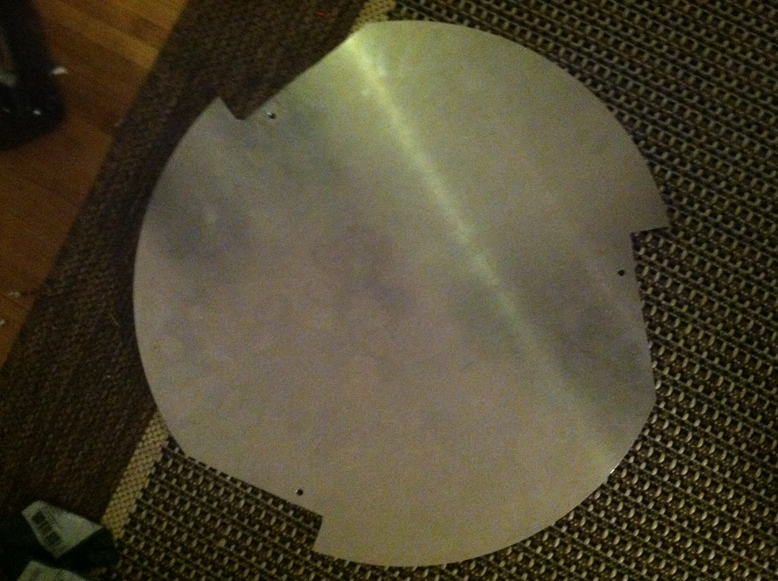

And i cut the base plate to fit in between the pillars

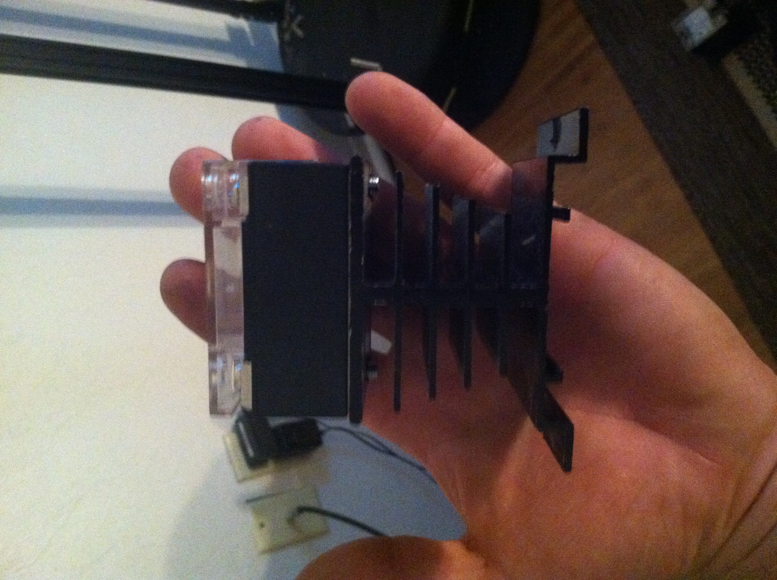

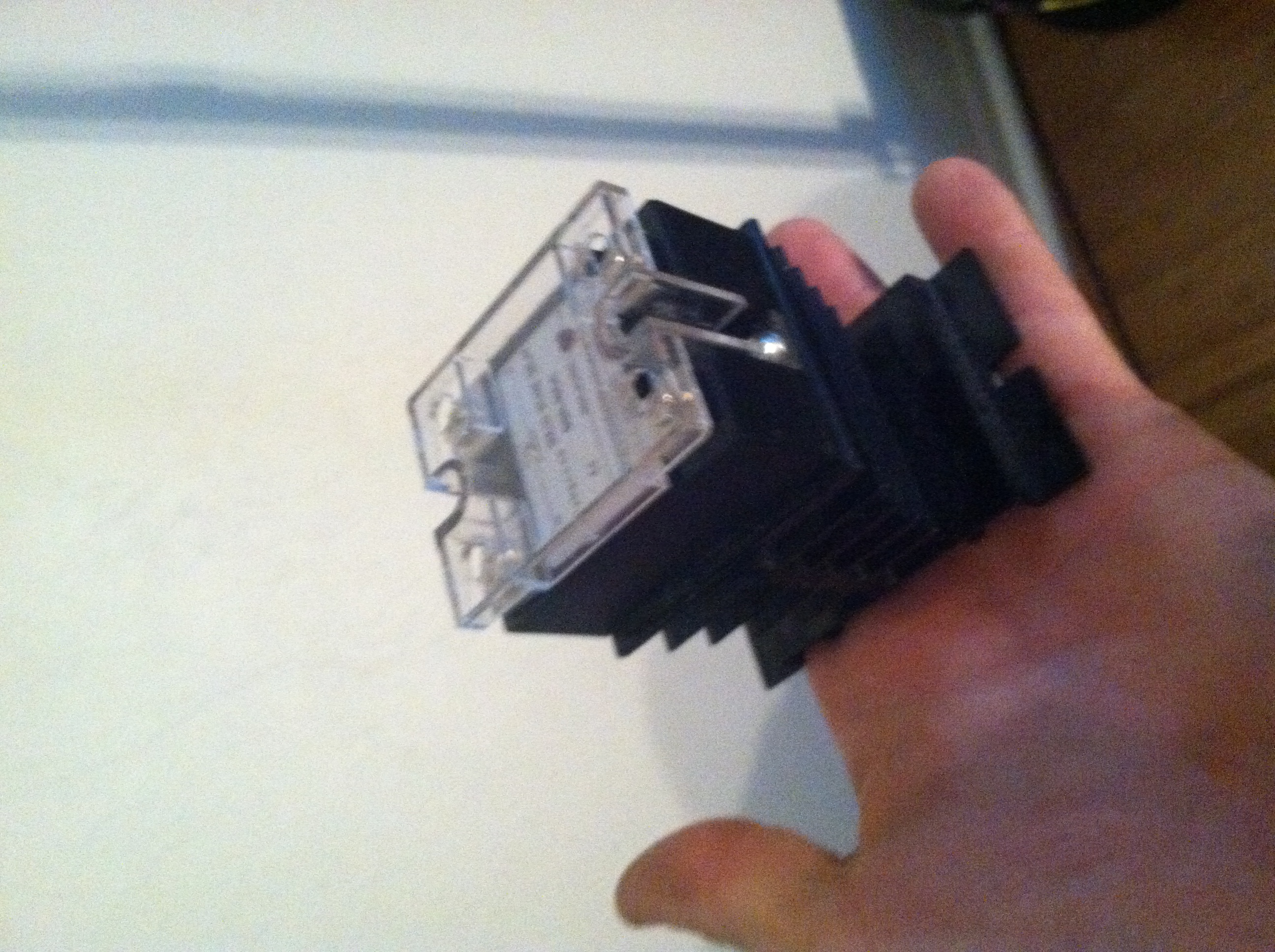

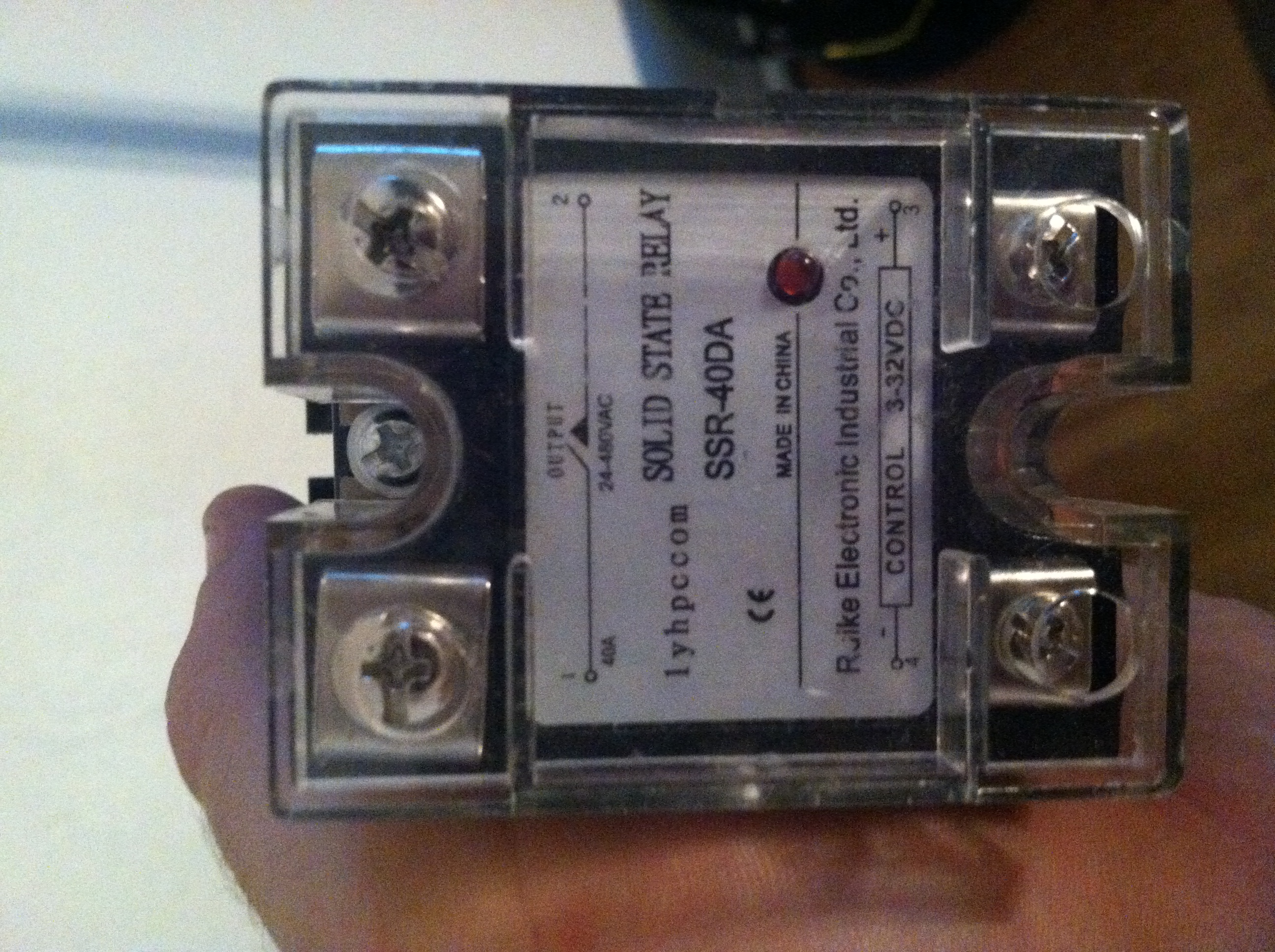

a couple pics of the SSR

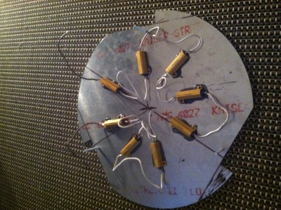

Yes, Mhacknet i doubled them up from the get go. though i was not sure if there was a need for it. IMG_1703.JPG Home depot parts again IMG_1704.JPG IMG_1705.JPG just a little perspective IMG_1706.JPG Basic layout of the resistors IMG_1707.JPG resistor closeup IMG_1709.JPG Wired up in series IMG_1710 ...

The top, heater plate and bottom are $5.00 table tops from Home Depot. 18 diameter. I grabbed a outlet box and a 6slot cat cable plate. I cut the cable in half and soldered the pairs of like colors together. Eg) orange w/ orange and white. Then assigned each to either A+ A- B+ or B-. I think it will ...

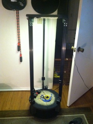

I got the top put on today, and some LED lighting.

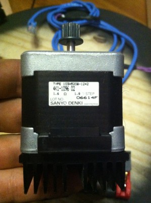

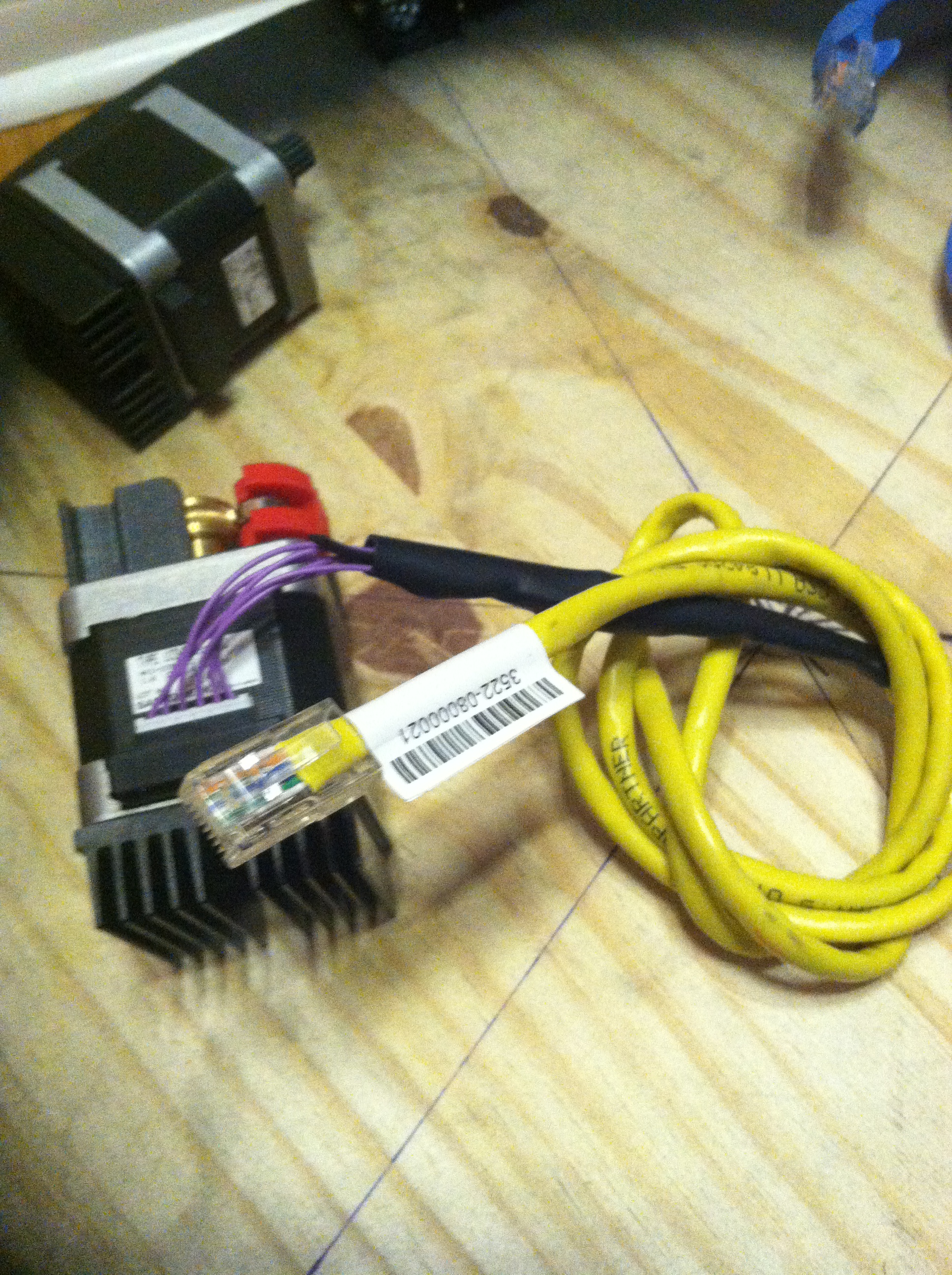

Here is the motor wired into a CAT5 cable. I plan on using the plugs as a quick disconnect.
it has a 15 tooth pulley and a heatsink on the back.
