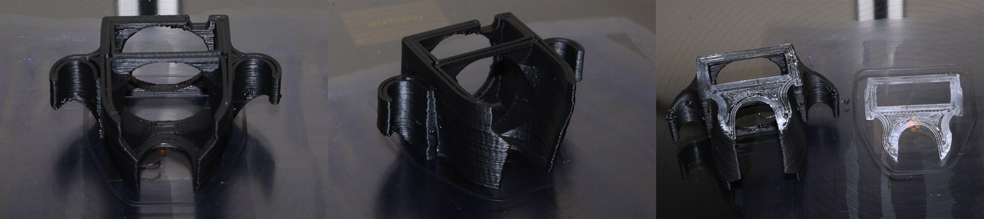

I spent about 30 min calibrating and started my first print!
It's about 30 min into the 1:30 min fan bracket.
I'll post the results when it's done.
Ok it's been an hour and here is what I have: Not too bad for my first print!
