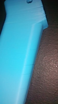

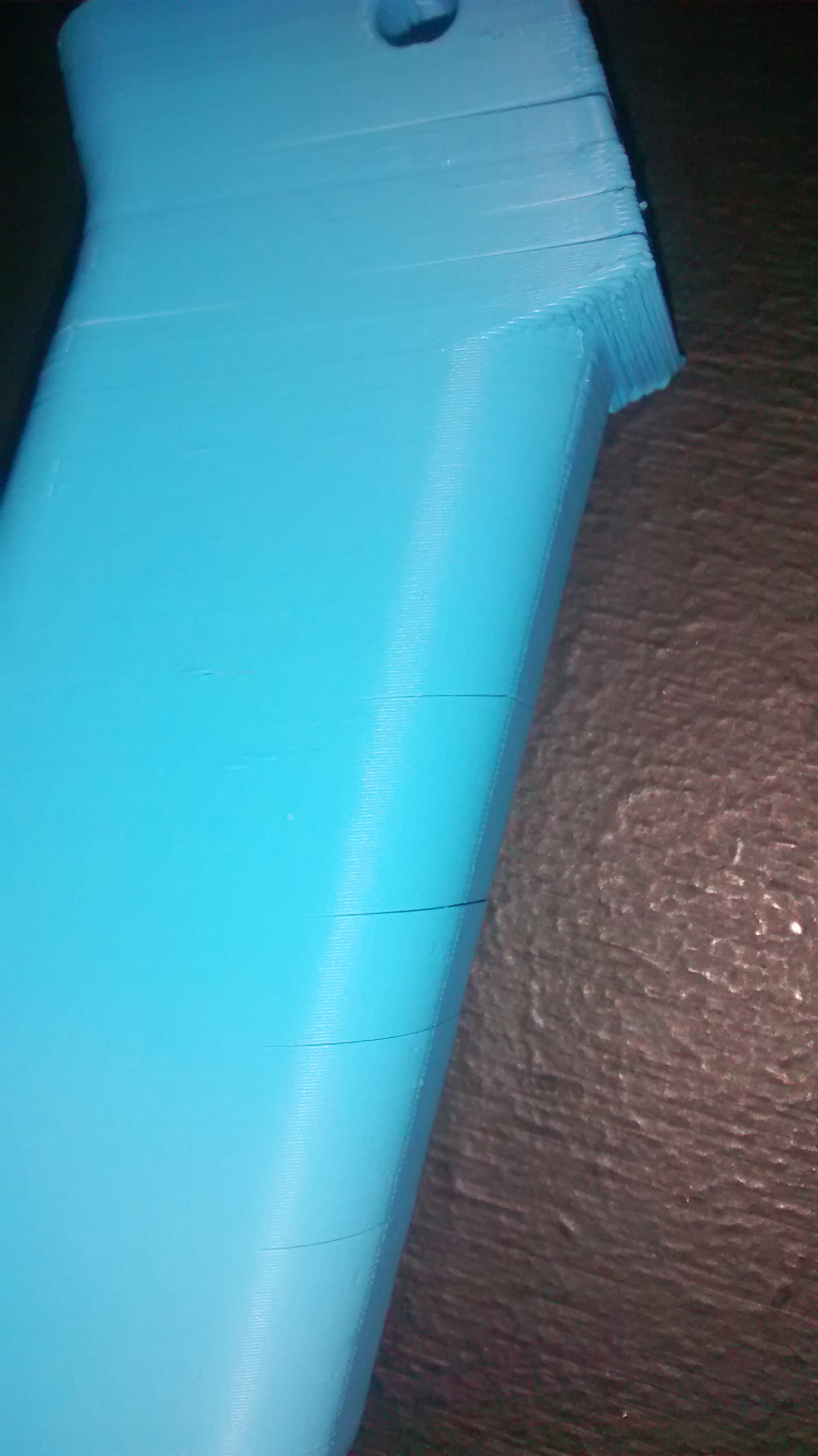

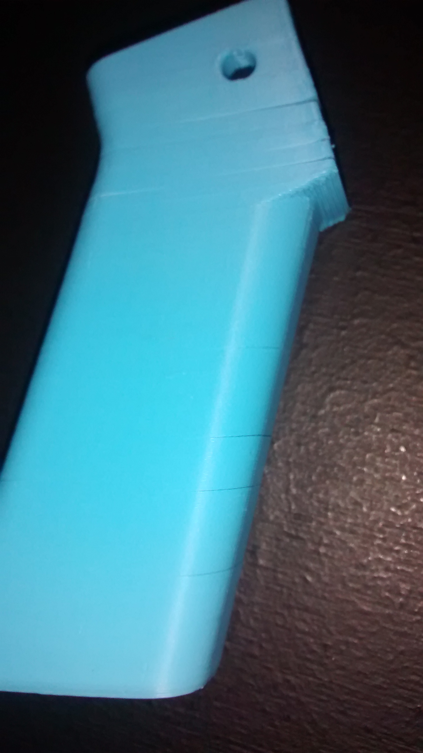

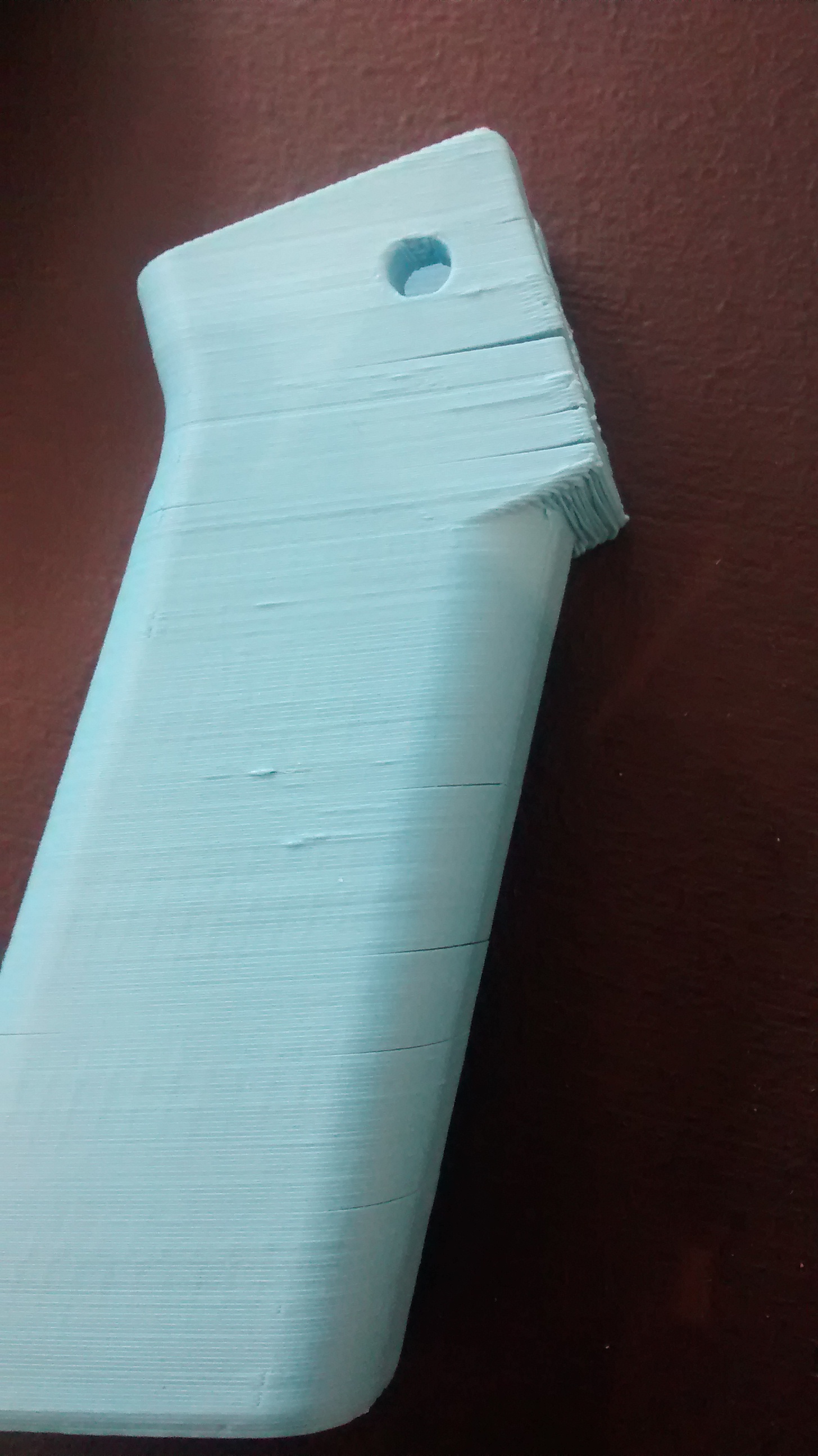

Re: cracks in ABS print
Hello, and thanks for all your replies! I'm glad to say I've printed another part at higher temps (230/110) and there were no cracks. I did get a very flat base where the part was in contact with bed and slic3r had some trouble where there were thin walls (see pics). Here are my settings: filament ...
Hi, Thanks for the reply.
I'm using 218 for the first layer and 220 thereafter. And auto-cooling was on.
If I turn off the fan for the entire job and raise the temp to 230 will it not overheat? I'll sure give it a try because the last print was awful!
