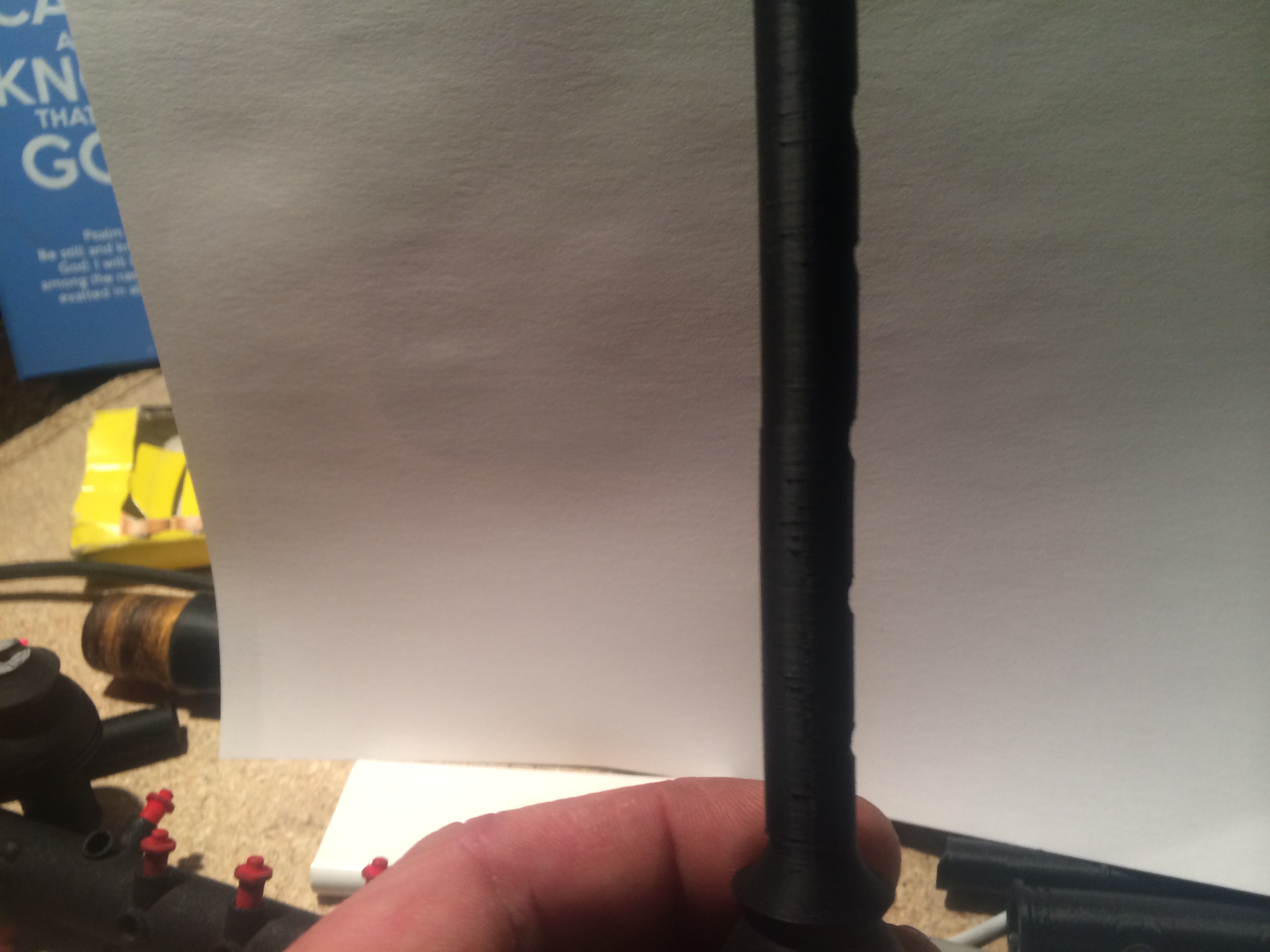

Re: Tall prints going banana
Well, it took me a while. Funnily enough, I should have checked the hot end first, having fairly recently had it apart to change the resistors. It was a case of "can't be that, already checked that", but it seems that nut really needs to be on tight. It does get wobbled around a lot. The test that ...

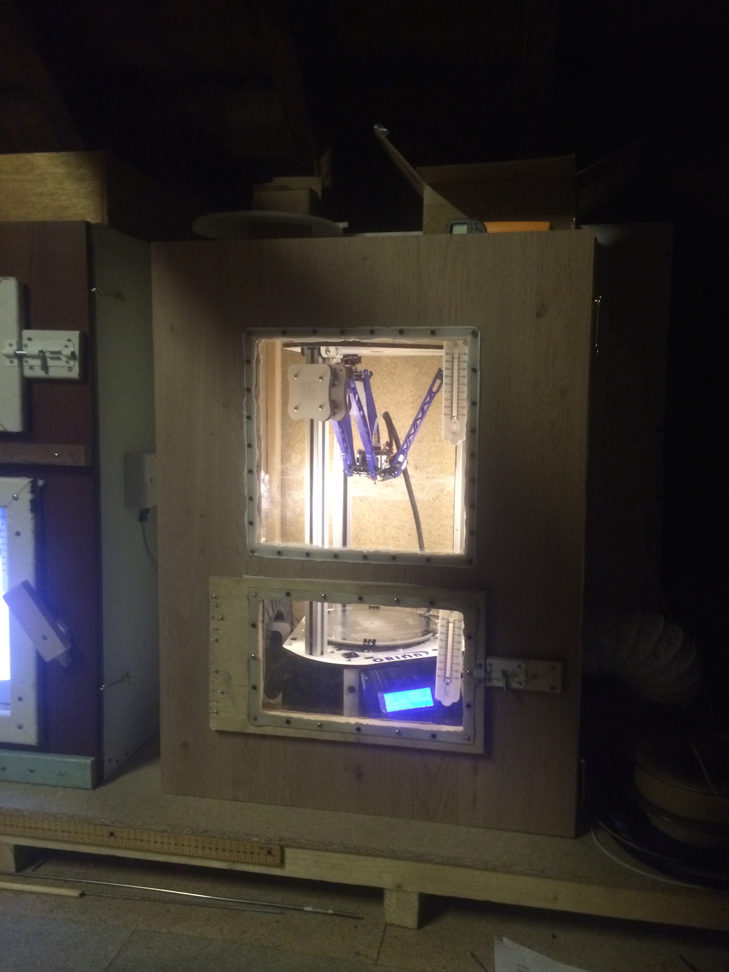

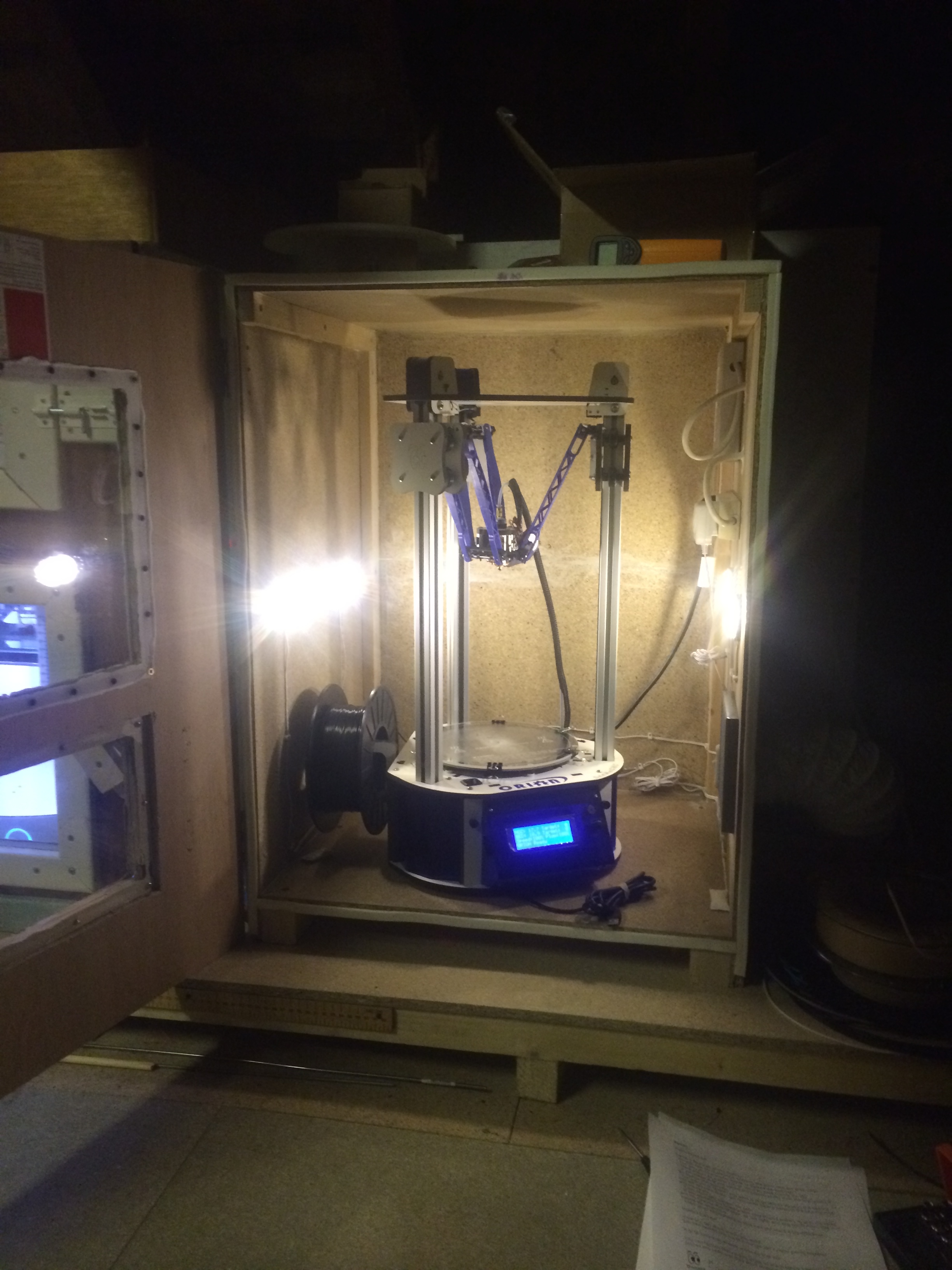

Re: Build chamber v2
Yes, I had that! I'm going to print a hood to direct the flow downwards to the floor of the chamber, and see if that helps. For now, I'm finding that the recycling seems to act passively - as I said above, I've got a notion about how this might be working, although no idea if I'm right about that ...

Re: Tall prints going banana - problem solved!
Got it! If you start to see a curve appearing, particularly in tall, slim prints, that causes the model to bend a little towards the left from probably about 90mm, resolving back towards the centre at about 140mm, then chances are that your hot end mounting nut has worked itself a little loose ...
>> "PLA, ABS, or something else? Is the deflection along the same vector as your layer fan?" You know, I think it is. I'm printing ABS. I've got various coloured ABS prints, all show the same curve if I look carefully. The layer fan is a possibility - but would that be consistent with it only ...
by donaldlindsay
Wed Nov 26, 2014 6:56 pm
Forum: Troubleshooting
Topic: Tall prints going banana
Replies: 22
(poor printer as in it's not feeling well - not 'its rubbish')
It certainly is! That's pretty much all I print - working woodwind instruments. I'm drawing designs for whistles and bagpipes. In fact, I'm about to start making some of them for sale, after prototyping them on the Orion. Poor printer. So it's looking likely that it's going to need taken to pieces ...
by donaldlindsay
Tue Nov 25, 2014 6:52 pm
Replies: 22
While I do, here's a picture of a print, showing the curve ;

Tue Nov 25, 2014 6:23 pm
Forum: The Build Zone
Topic: Build chamber v2
Replies: 11
Here are some photos of the chamber as it is just now, closed and open
Build Chamber
Build Chamber
