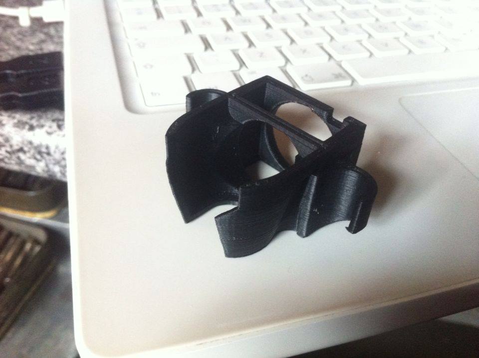

Re: First print - Fan shroud - Good, bad, ugly?
I printed my peek fan shroud in ABS as the manual says but the fan does not fit into it, I'm going to try calibrating the extruder to see if I can improve it any. Heres my first print...

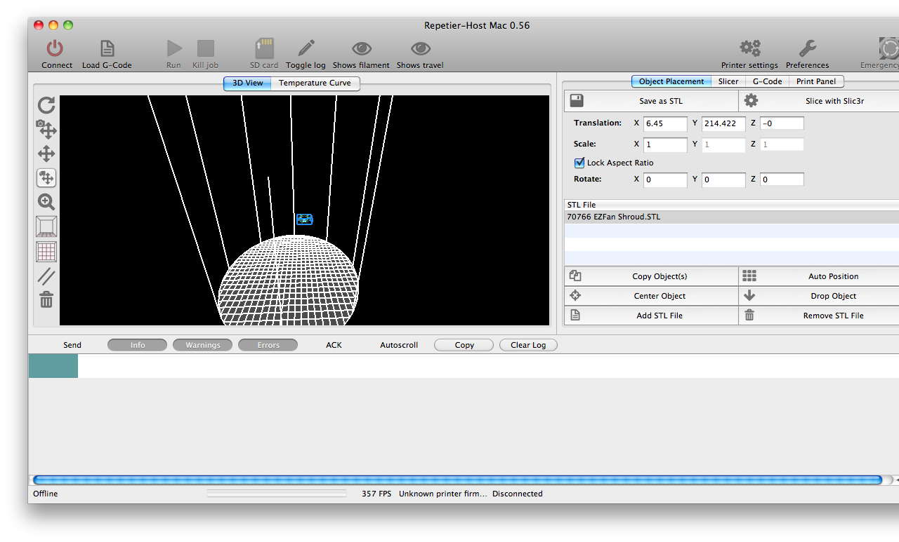

Re: Error Following PID Autotune
Thanks both! OK I've done all the calibration stuff and got to the step of opening up the peek fan shroud STL file, problem is I'm not sure why its dropping on the outside of the bed... Screen shot 2014-04-29 at 22.09.23.png These are my printer settings... Screen shot 2014-04-29 at 22.15.12.png

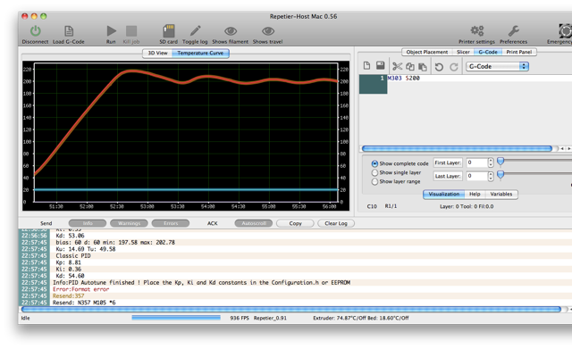

Missing parts from SeeMeCNC turned up yesterday so managed to get the build complete and started the calibration stuff. When running the PID autotune I get an error following that(see attached image) is this anything to be concerned about?
