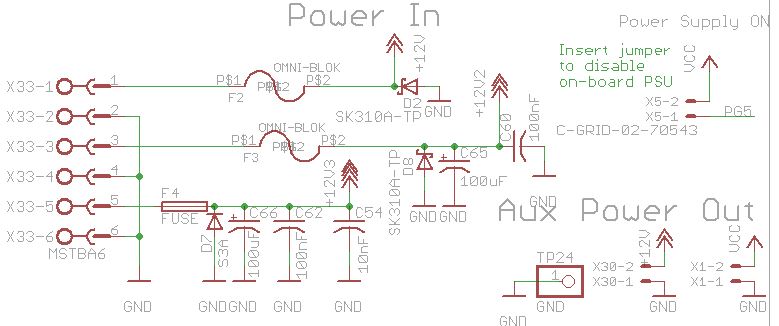

Re: Orion towers will not home
Oh what fun! Since SeeMeCNC was out of RAMBO replacement boards, one was ordered from UlitiMachine. It came yesterday, but the 10 pin connector on the top edge was not screw terminals, but pins in a holder. Happened to have a mating connector with screw terminals and sockets that fit. Unfortunately ...
Voltage at X33-1, and both sides of F2 were 12 VDC, but both sides of D2 were 0VDC, so the fuse holder is bad.
The fuse holder was probably damaged during my first attempt at removing F2, before making a tool to do this.
The three stepper motors used to home the Orion have no power when a G28 command is issued, nor when home on the front panel is clicked in the printer settings menu. I have found small (nano) fuses F3 and kF2 on the board and they check out OK, but am unable to find F1 to check it. Does anyone have ...
