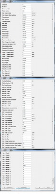

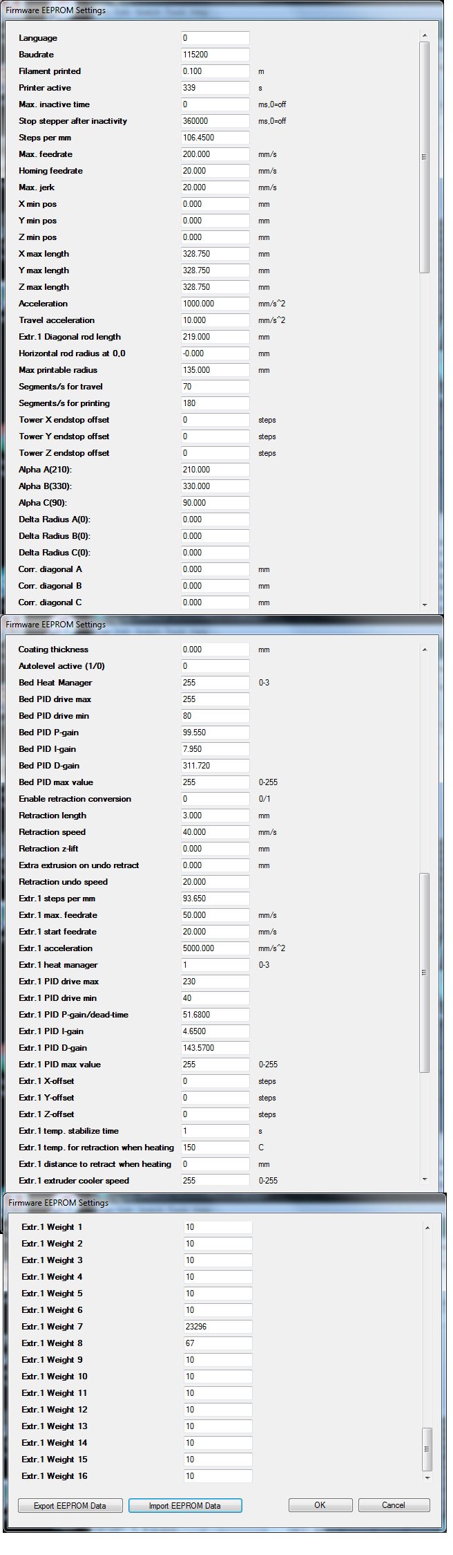

Re: Horizontal Radius missing in EEPROM
Hey Nylon, I installed the v.92.9 firmware you created, made a few changes to Baudrate and MaxLengths, and compiled and uploaded the Firmware and EEPROM. I've attached a side by side of my v.92.8 FW and your V.92.9 FW below for your review. They both contain some, but not all, of the same setting ...
And Here's my EEPROM Settings...
I have a Rostock Max V1. I replaced the Rambo with an Azteeg X3pro, and the LCD display with the Viki2 display. I use Repetier version .92. I'm trying to calibrate the printer but I can't because "Horizontal Radius" is not present in EEPROM. Making changes to "Printer_Radius" in firmware appears to ...
