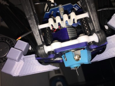

Re: 713 maker effector and hot end mount
I have E3d's on all my printers. I like them. They are an industry standard. Please stay away from cheap clones as they will provide no end of potential issues. I get my E3D from MatterHackers. http://www.matterhackers.com/store/printer-accessories/v6-hotend-full-kit-1.75mm-universal-with-bowden ...
Doh! Yup, that is an issue!
These mounts are for the E3D v6 hot end!

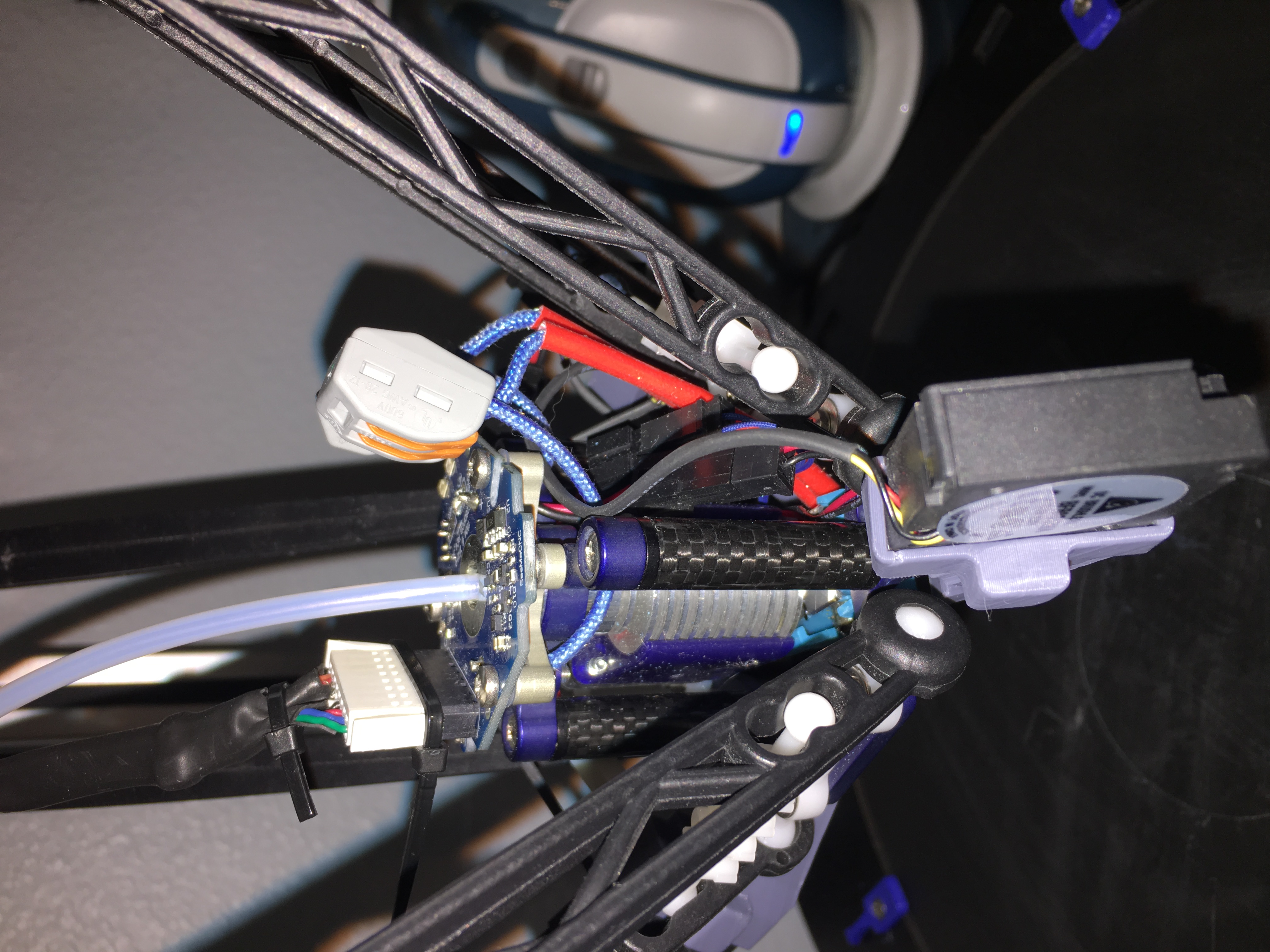

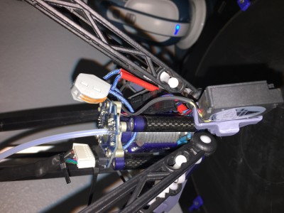

In your yellow bag there should be four spacers.
One goes on the top of each of those accelerometer mount, then the accelerometer, then 1 more spacer on the top of the mount hole with a pos and neg attachment.
I will edit and describe these when I get back to my workstation.

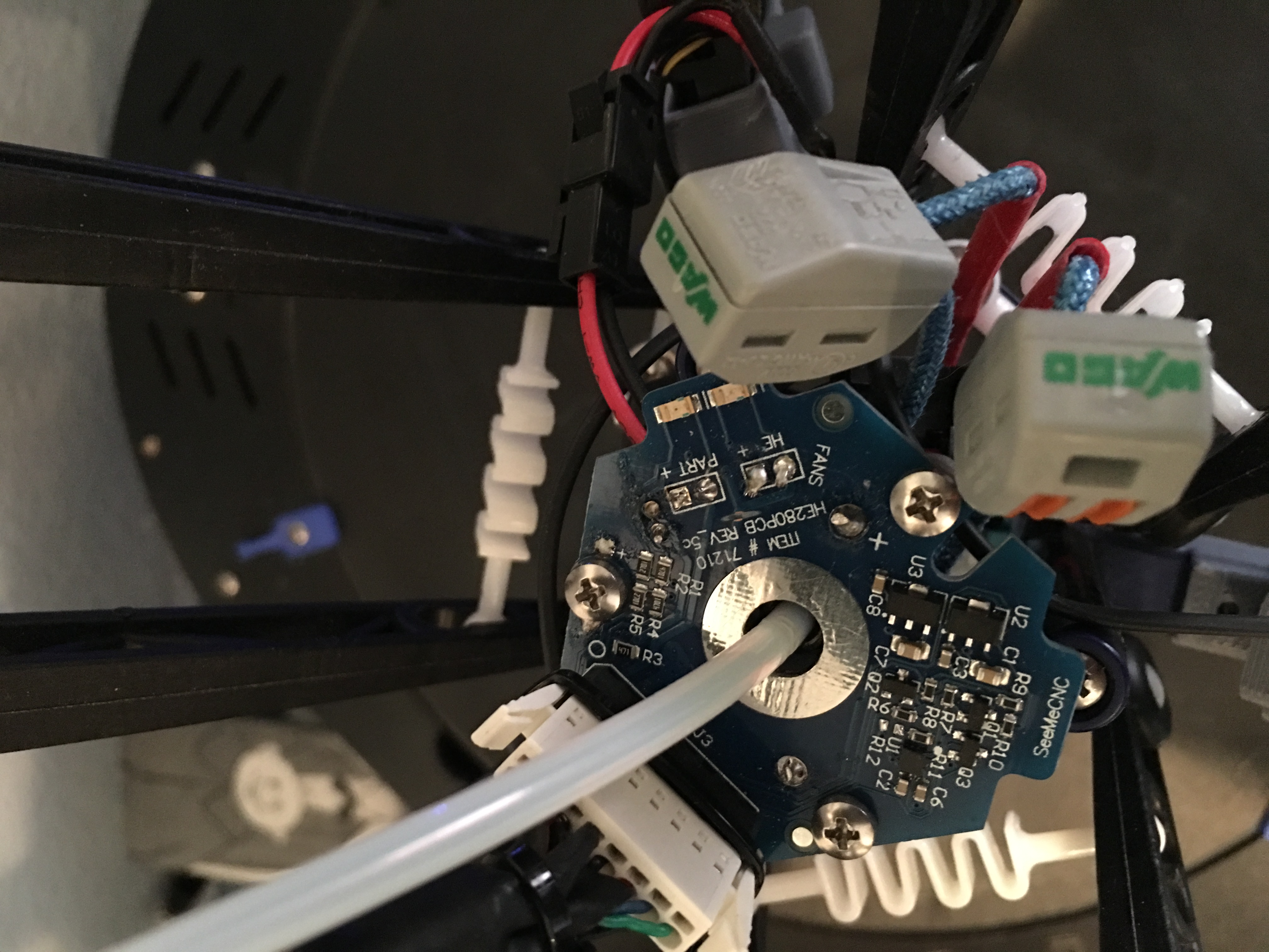

That looks right. Usually there is a diagram to illustrate how to assemble. Let me try and get some photos for you. -edit- Actually I think you have extra parts. It looks like you bought a basic kit requesting SeeMeCNC locking ring. Red and Blue Then additionally you bought the Accelerometer Board ...
