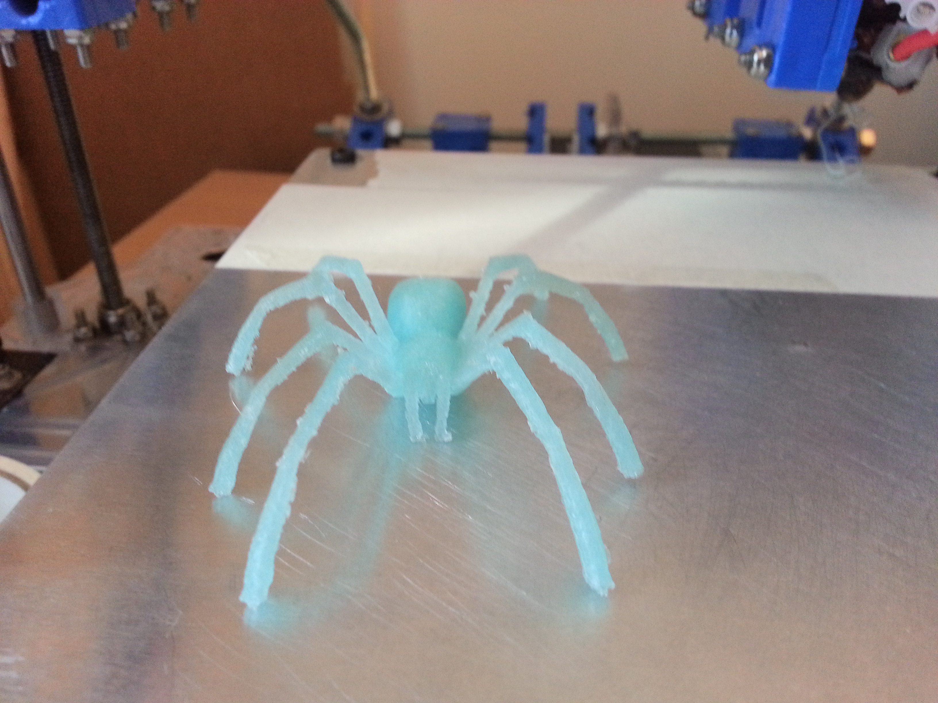

Re: A couple more :)
Wow, very nice. Are you using slicer. And if so. Would you mind sharing your settings with me. I'm having some problems. Im using repetier host with skeinforge, i find it a lot better for the support especially when i printed the spider, i can post some screen shots of my skeinforge settings if you ...

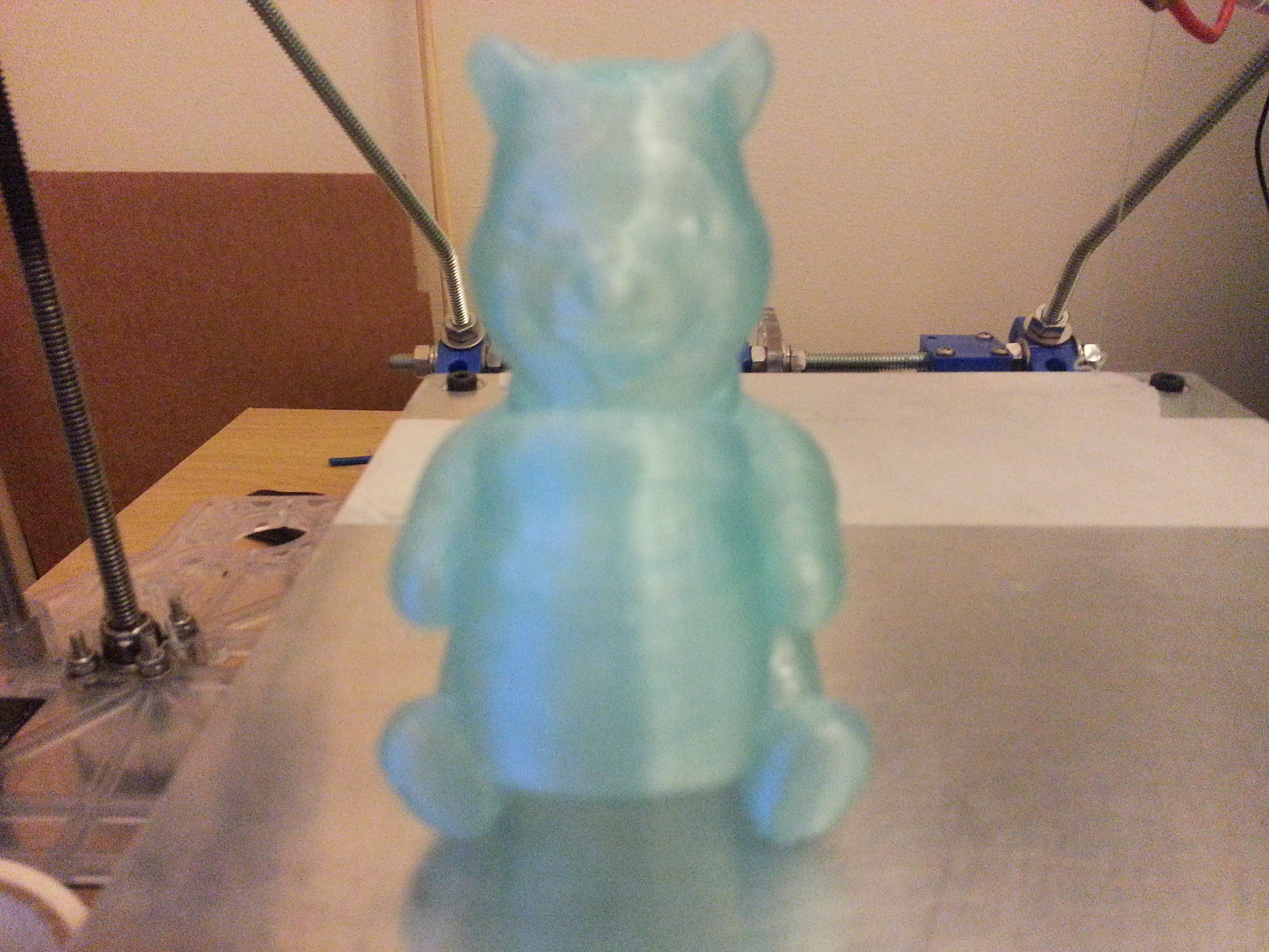

A couple more :)
Just a few more test prints in blue glow in the dark pla

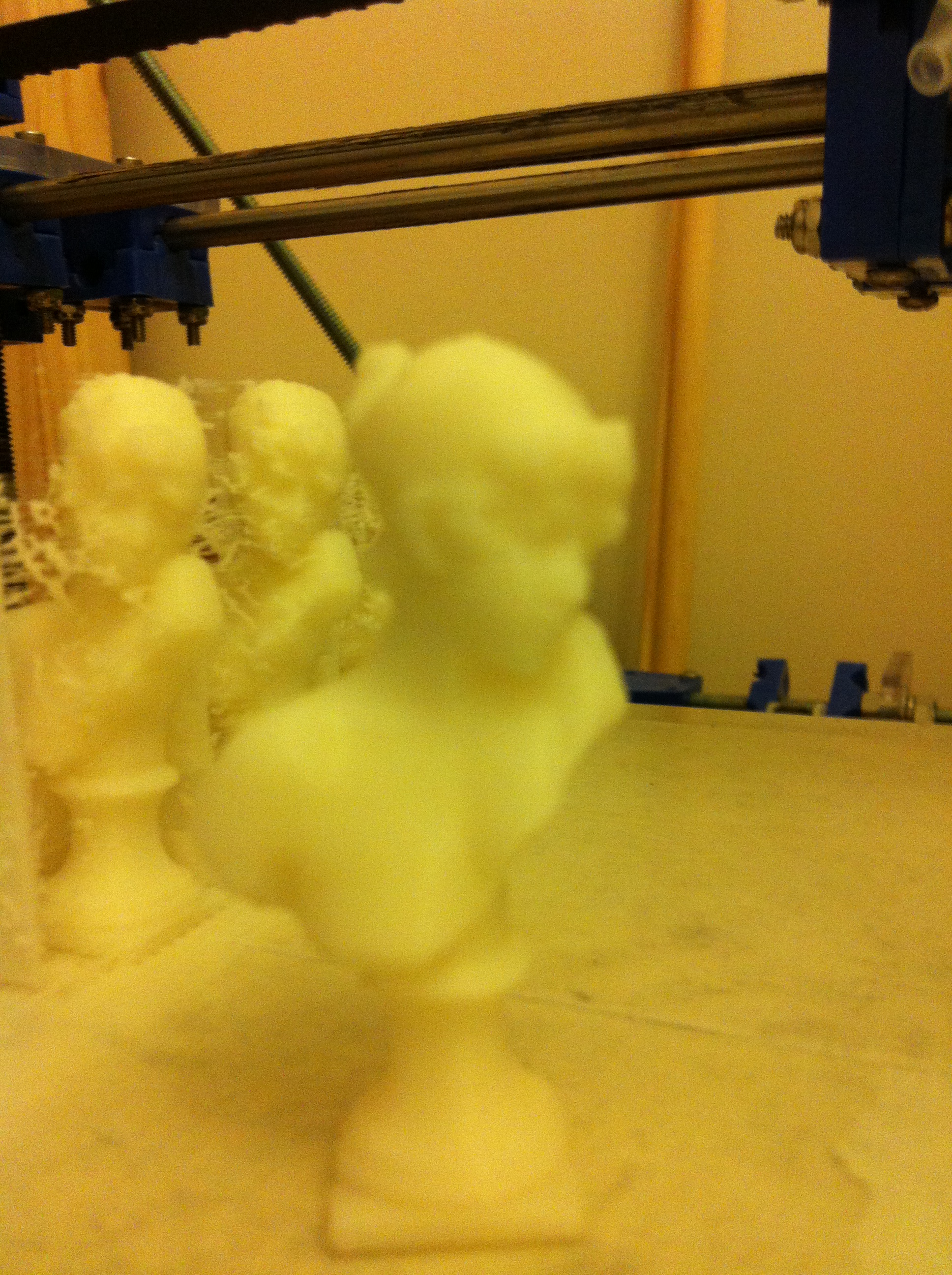

Re: Sapphos Head (impressed)
I was printing this as I was typing my last reply. Here is what Slic3r can produce with 0.28mm nozzle running at 0.10mm/layer. This took 1h:48m:12s to complete. If you want to try Slic3r, let me know, I can give you my config ini file that I use, you will just need to play around with some printer ...
Nice looking prints! It looks like you got a bit of extra plastic coming out of the extruder during moves from one object to another. Are you using Slic3r to create the gcode? If so, you can increase the amount of retraction that occurs when the extruder is moving, it would help eliminate some of ...
Hi, here is my first really impressive (to me :D) print, done 4 of these at once using 3mm pla and 0.25 layer height, as you can see cleaned 1 three to go, back to it i suppose .....
