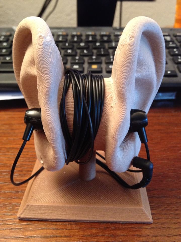

Ear phone with stand
Made a stand to hold my ear buds at work when I am not using them:
http://www.thingiverse.com/thing:637966
