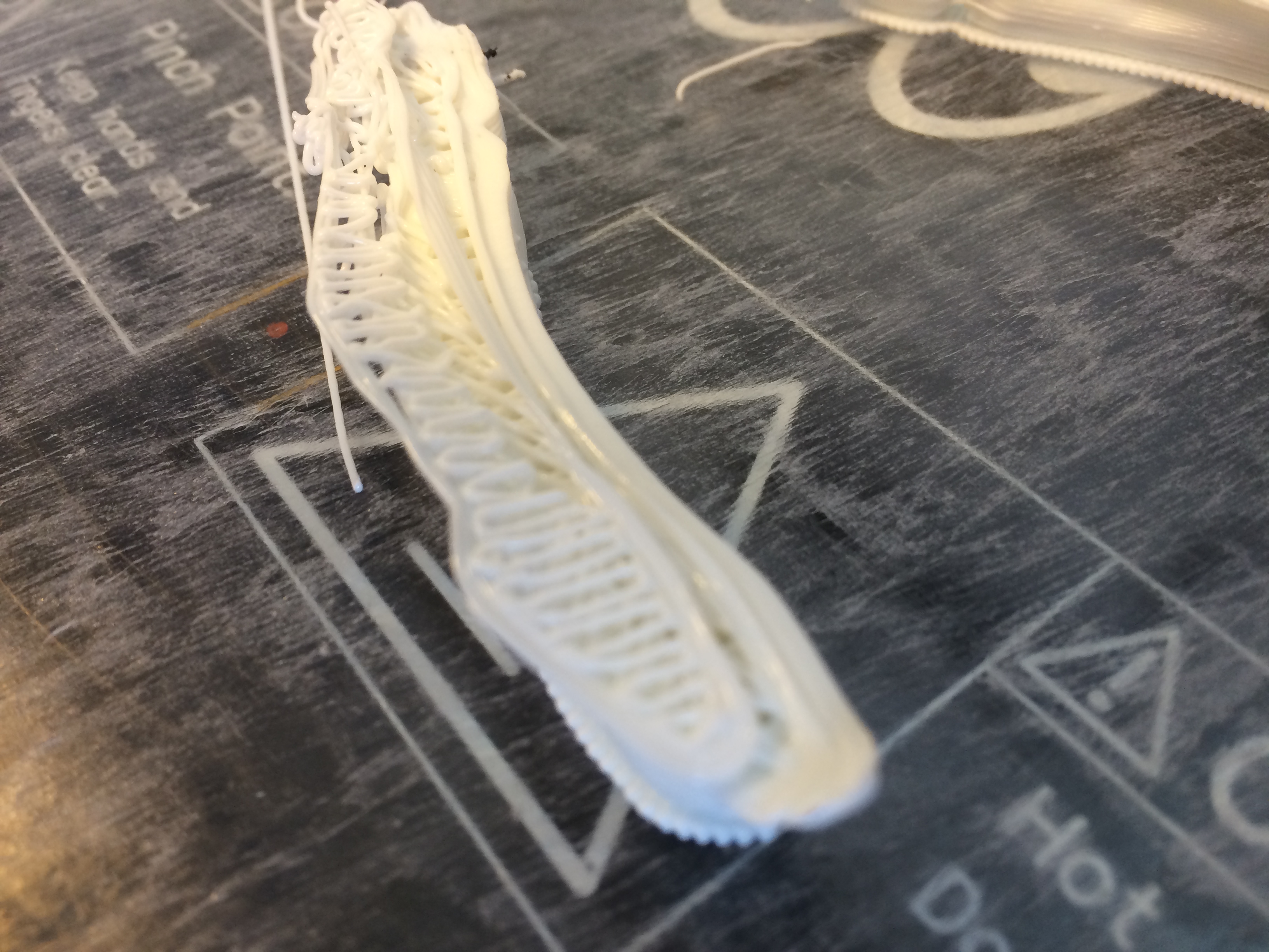

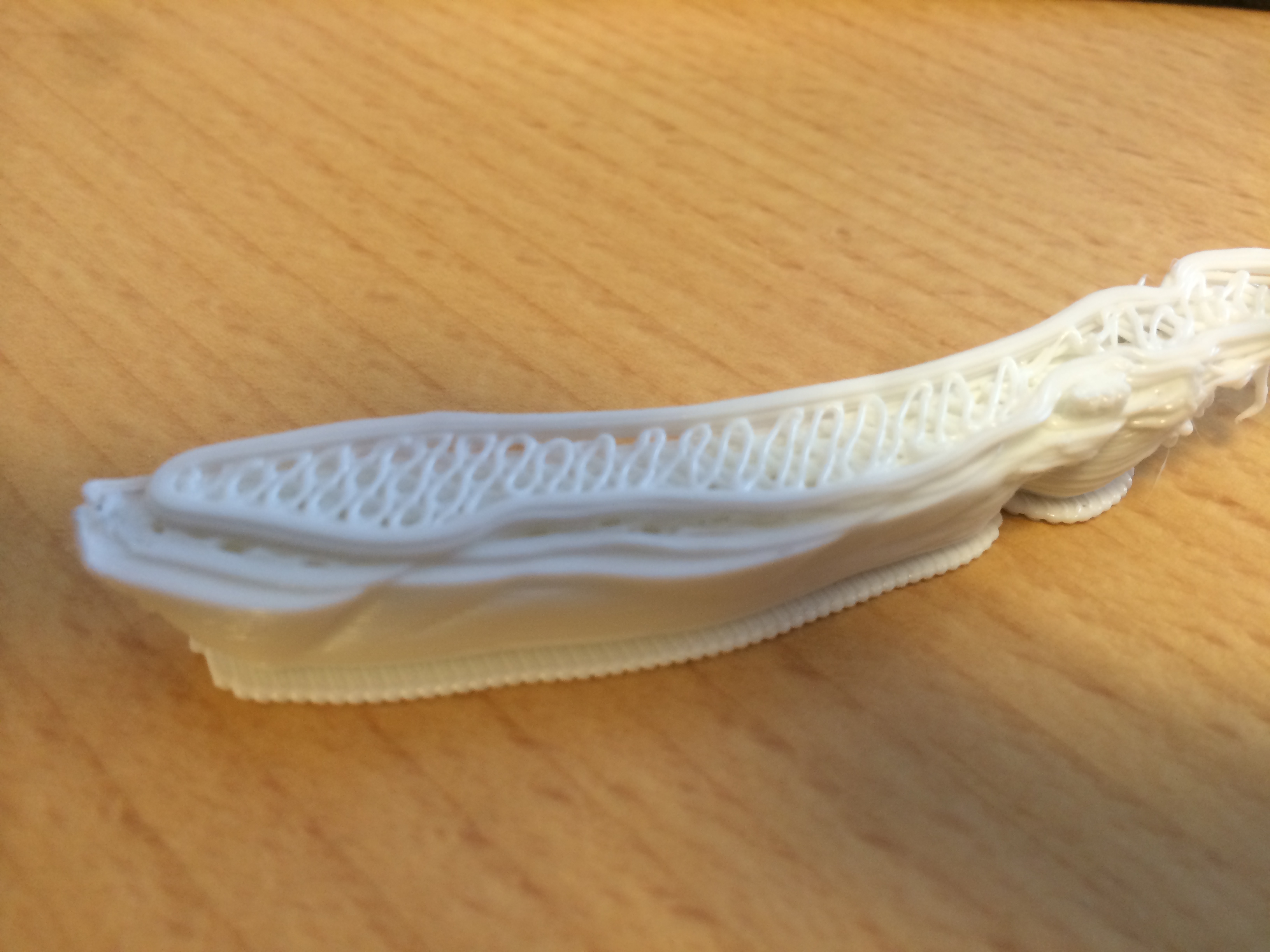

Problem solved. Tighten drivebelts
Hi, cooling fan works. Not kysan motors. Wantai or something. Took the advice and thightened up the drive belts, noticed that one of the belts had made a small amount of plastic falloff (plastic dust) from top of one of the drive belts. so it was probably not horisontal at top mount. After that ...

print fail after random amount of time
After printing PLA for about 20-30minutes on different prints, sometimes the whole print moves a few mm to the left/front.
Attached a few pictures. Is there something wrong with the carriages?
