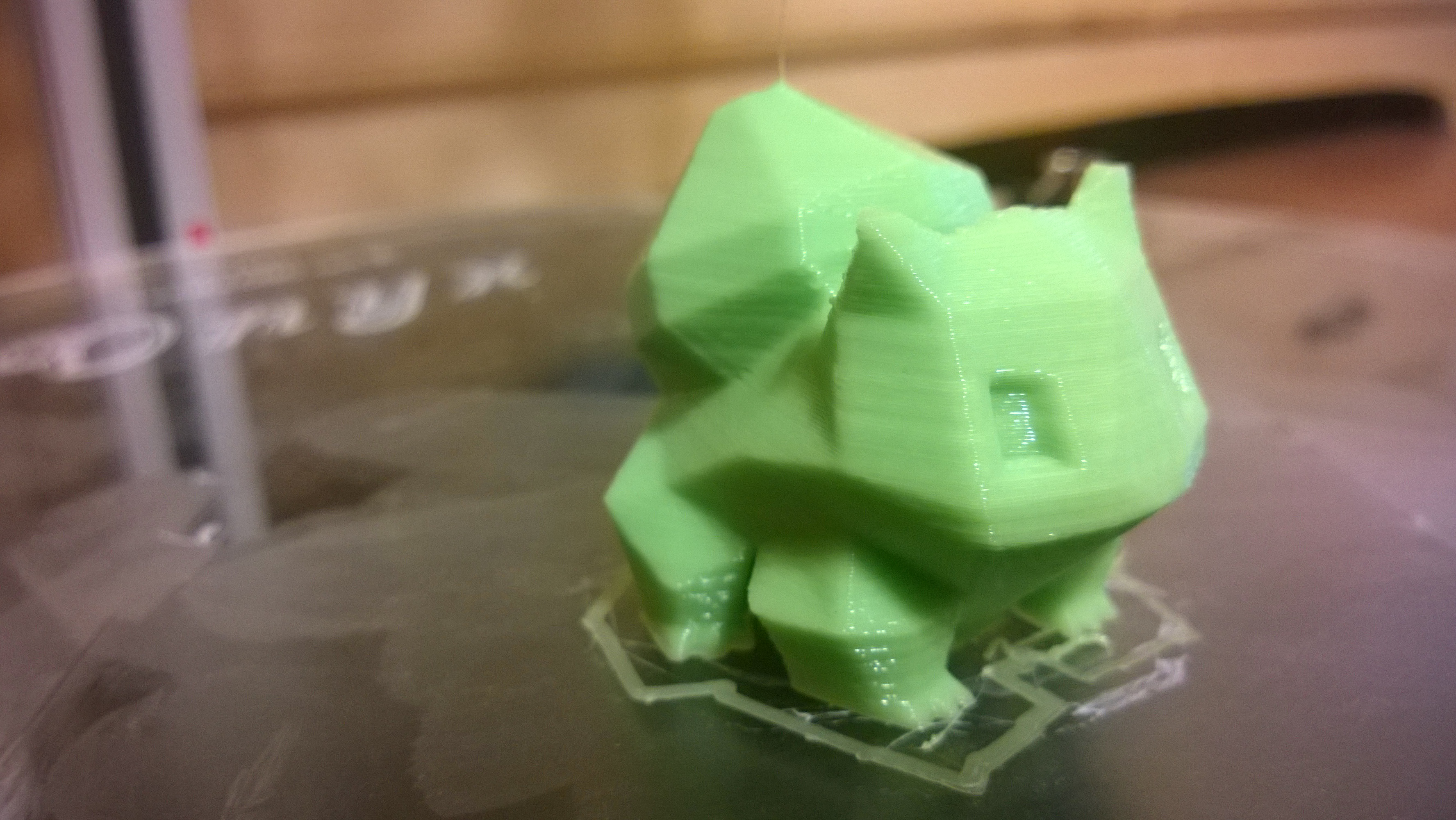

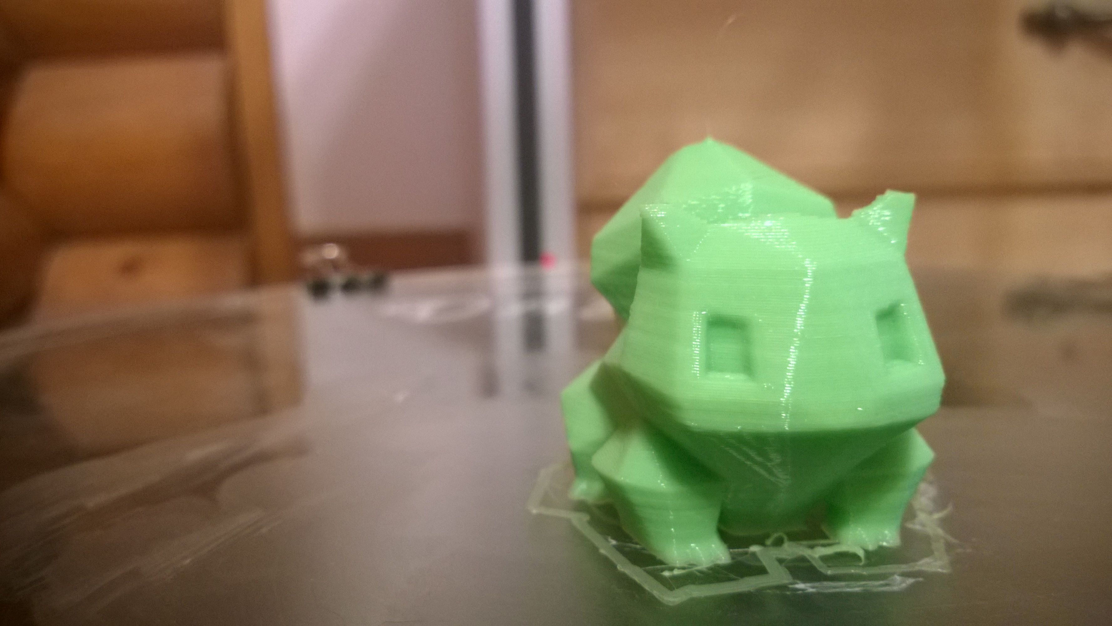

Re: Overhang help 'Chins' dont print well on parts
Thanks for the help printing this. I finally got to reprint and it cane out great. I hope this good printing continues onto the larger print I am going to do next.
Thanks Gestalt for taking the time/filament to print that out in order to help me. I will try and replicate the results you got tomorrow (I am traveling today). Out of curiosity, your print speed on perimeters is much lower than mine, I usually use about 40mm/s, do you normally print that slowly or ...
The model was a small Low Poly Bulbasaur from Thingiverse Using Cura it took about 50 minutes to print, most of my pla prints have come out better on Cura than Slic3r because of stringing. I dont know if Cura lets you change the direction of perimeter loop printing, I know where the setting is in ...
I often find that the "Chin" of whatever model I am printing tents to come out stringy and blobby. WP_20140731_003.jpg WP_20140731_001.jpg I have had this happen on other models as well, and I am wondering which setting I should try to change. I suspect it is related to print speed and temperature ...
