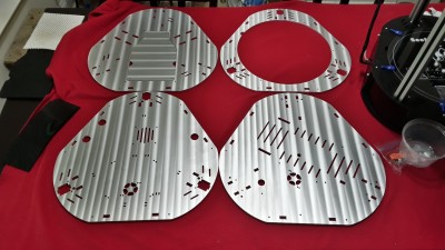

Re: Coming soon from 713Maker.com
So I have been running the metal framed V3 almost non-stop since it was put back together a few days ago. It still has the stock HE280 head and I still run the very first calibration code I did when I first got the printer from SeemeCNC. It has been printing like a total champ and is fast becoming ...
OK here is a sneak peek at the first prototype for the V3 metal frame set. Tomorrow I will look at wiring everything back up and start test prints. Still need to also lay up the custom composite fabric side panels and vacuum resin infuse them in the next few days then mill them down to replace the ...
Last parts of the V3 kit came off the mills last night. Now the sad tasks of taking apart my V3 and rebuilding it. I never enjoy taking apart a working printer, even if it is for a sweet mod.

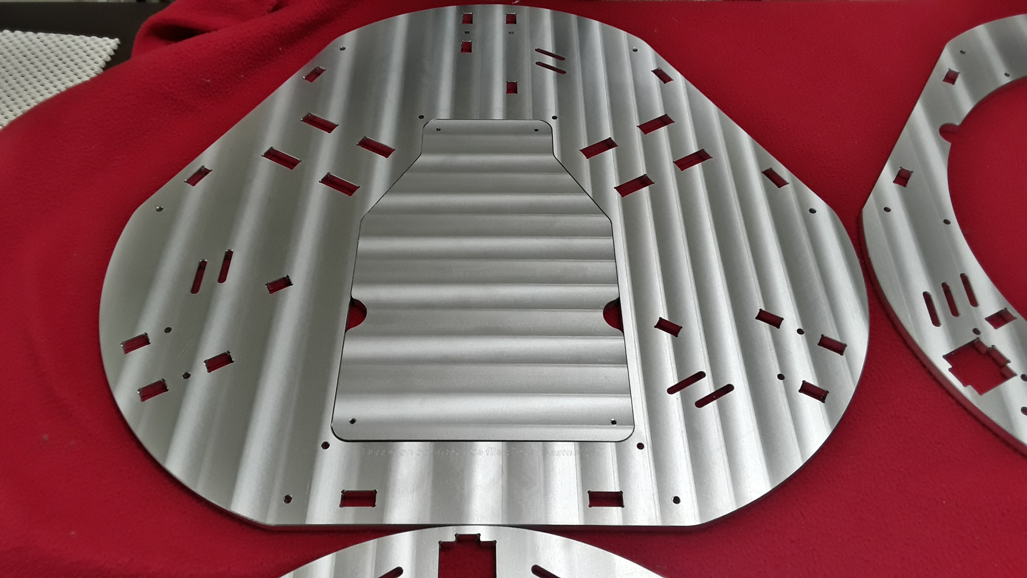

Hey guys! Sorry I have been away so much. I have been busy getting the newest CNC mill up and running and doing more testing for the Rostock metal kits. I did look into reducing the dogbone size in the slot corners and I have reduced it down to about as small as it can go with a new process. I will ...
Sadly the radius of the endmill is of course far larger than the width of the CO2 laser used on the wooden parts. So there has to be some sort of "dogbone" in the corners to allow the parts to fit together. These currently use a 2.23mm dill which is done off center of the corner to further reduce ...
