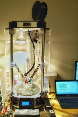

Re: Using heatlamp to speed up initial bed heating
Here is a quick shot of the setup. I have a smaller ceramic heater bulb in the mail since the one in there right now is huge and way to bright. Next up is to print some better brackets to reduce the holes in the enclosure and find a way to join the sheets of acrylic.
