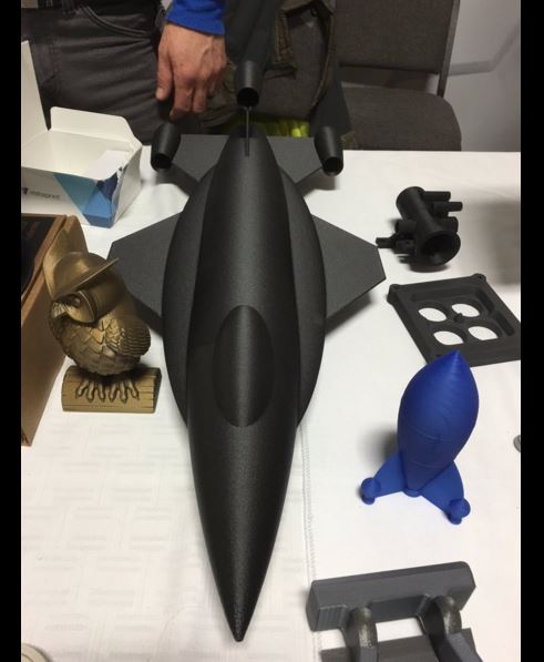

Re: Toy Rocket Plane
I am honored that the 3DXTech guys used my Rocket Plane to show off their filament at the Midwest RepRap Festival. I am guessing this is one of their carbon fiber filaments.
https://twitter.com/FY3TV/status/711537678806872065
