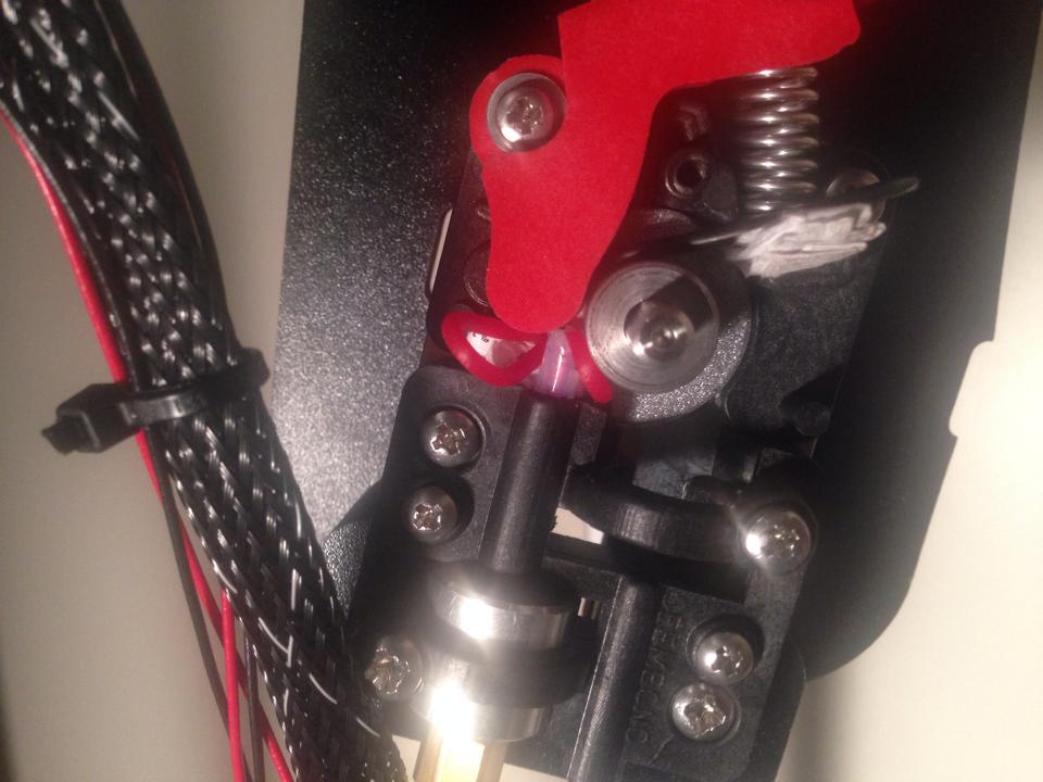

Okay, after a few days of wondering why I can't print ninjaflex with the simple extruder mod mentioned on this forum I decided to just make my own part and after a few revisions it worked out amazing i couldn't print at 10mms even for a minute without a major jam no matter what I tried.. I had the ...

just to update, i just wound up modeling my own extruder base plate that has support for the filament right up to the gears on the entrance and exits. this finally worked but no more than 30mms , i really would love to know how you are printing 50mms with the above mod only :S

having good success so far... made my own custom extruder base and after a little bit of dremel work i was able to get it working today and it was very smooth. i was able to extrude ninjaflex that i had a 30mms profile for at 75% speed... it still buckled up at 100% 30mms so im now printing a ...

Re: Having tons of issues with Ninjaflex - anyone have any l
Hey, thanks for your reply. So yes my printer was 100% stock including the hot end, extruder etc. I went searching around on thingiverse and found a custom extruder that was made to handle flex materials like the ninjaflex stuff. I did this late last night and didn't have the ability to go grab new ...

10708346_10152285751046246_336242069_n.jpg Anyways don't mind the ghetto rigged temporary fixes like the paper stuffed in random places and scrap filament shoved into the extruder LOL. I started out with just the single mod talked about in the thread linked above. That didn't work so I did a few ...
