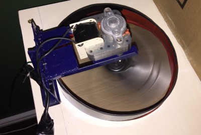

ABS very large print--not bad...

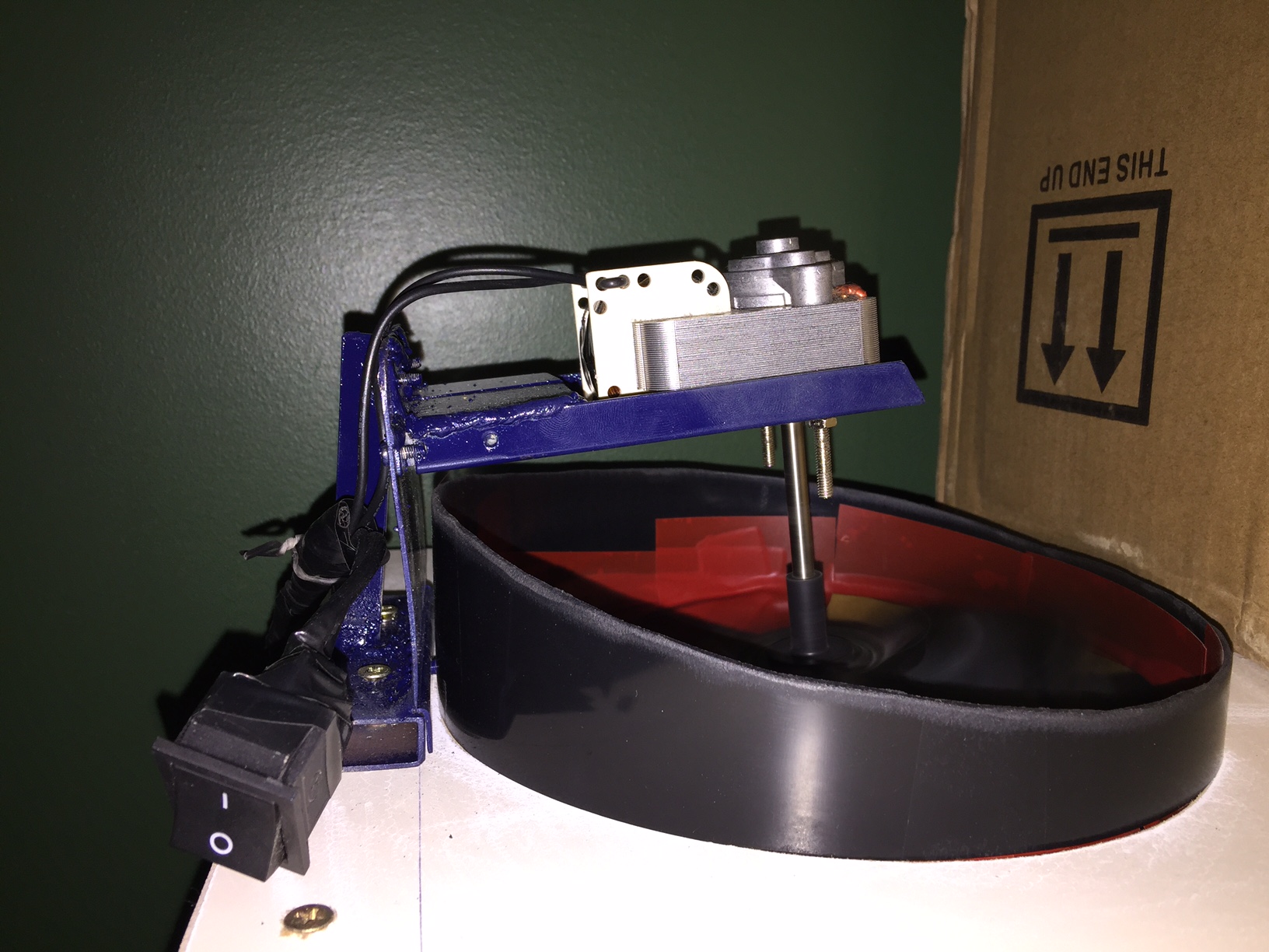

I have a Rostock MAX v2 with "ghetto cover". ghetto cover.jpg and the cooling fan for the internals (see above picture--note how the internals are inside the table. Opposite side of fan there is no barrier--air free flows out): fan 1.jpg And I am using MatterControl: presets snapshot.jpg nozzle dia ...

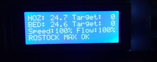

After writing that original inquiry I turned off the puter and printer. Just back home now I fired both up. The printer reads:
I'll keep it on for a while and see if it goes on the fritz.

printer continues in "dry run" after hardware failure notice
I've been away from this for about nine months and trying to get back up to speed with printing but failure with "something"... I turned it on, all seemed good. Loaded a file to print: I am using MatterControl 1.5 (on a Rostock MAX v2). Did all the necessary functions and started. The bed and ...

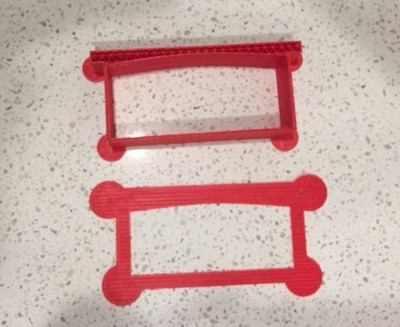

Which end would you put on the bed (to print)?
Because this is so long I am having second thoughts about printing it as is (with the ears down--obviously). That "end" wall is 3mm thick...the supports would be crazy, huh? But on the other side is a 13mm overhang on one side... Which side would YOU put on the bed to print this? Thanx! which.jpg

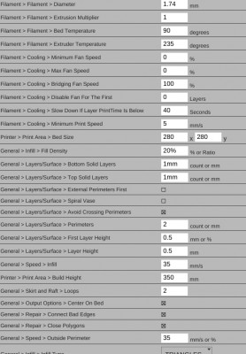

Yes, stock .5mm nozzle. Is that 80% of the nozzle diameter? Thanx! PS- I'm not concerned (too much) with aesthetics. The wobbly walls aren't too big a deal--I'm more concerned with design, functionality, etc., of what the end use will be. Of course, along the way I'd like to dial in the finer ...

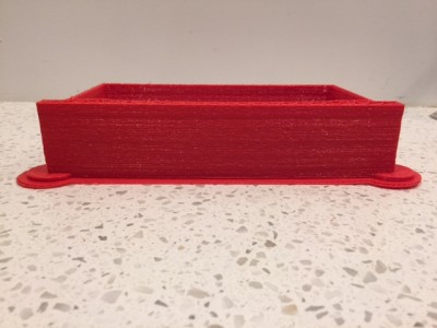

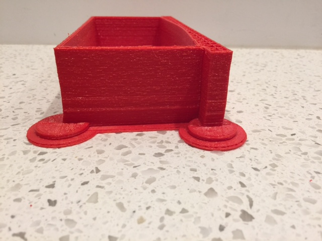

Mouse Ears worked great! Big print--my best results so far
Happy with results.
The walls and edges are a bit wobbly--is that because I had the "refinement" (Fusion 360) set on "medium"?

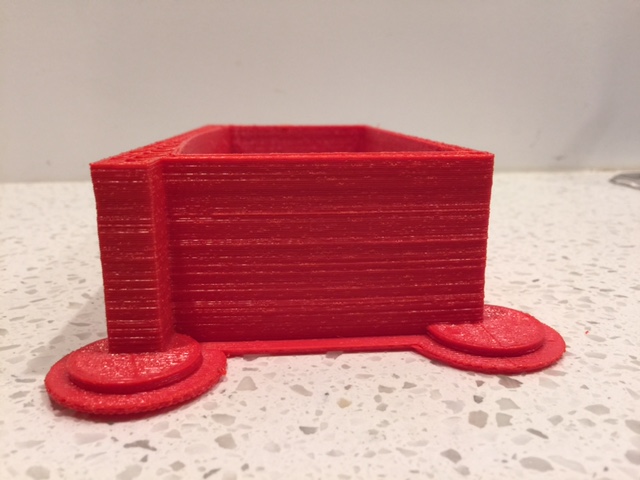

Righto on the mouse ears. Will try--how thick? 3mm?
Bed temp is 85 now.
Bed temp is 85 now.

I peeled the skirts away for the pics--and unfortunately, they got tossed last night upon clean-up. It is quite large...but I may attempt MM ears.

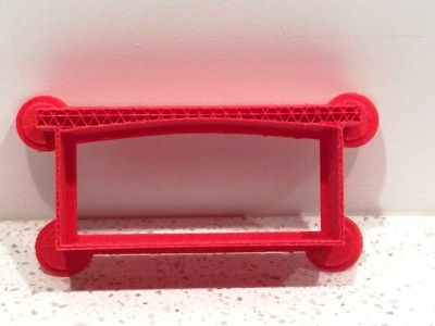

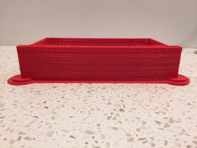

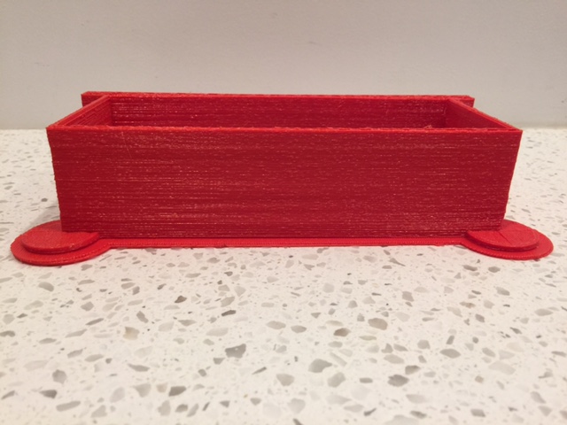

I think you are right on the mark, Brazz. Below is pics of my last print. It works for my prototyping purposes (the reason I kept at it) but it is a bummer to see the flaws, to be sure. I ultimately MUST get it right for aesthetic purposes--down the road. 1) I realize that the one problem with the ...

I had set mine to 228. The first print would reach it to start printing, then it would hover around 225, and eventually down as low as 218. MatterHacker guy said to try it (I had redone the calibrations dozens of times) without the PEEK fan turned on--I tried it and the hot end performed beautifully ...

The fan is smooth as a baby's bottom. It is set on LOW...so there isn't a ton of pressure--just a lot of volume. I sealed up everything pretty well--including the "draft holes" for the power supply (in the base plate of printer).

So bummed..looking at print (still have 15 hours to go) after 10 hours--there's a huge gap in it (same print as the previous big print). Here's a pic of the ABS spool. Upon closer inspection I see ABC is imprinted on spool. Would setting hot end at 235 degrees (up from 230) be the next move ...
