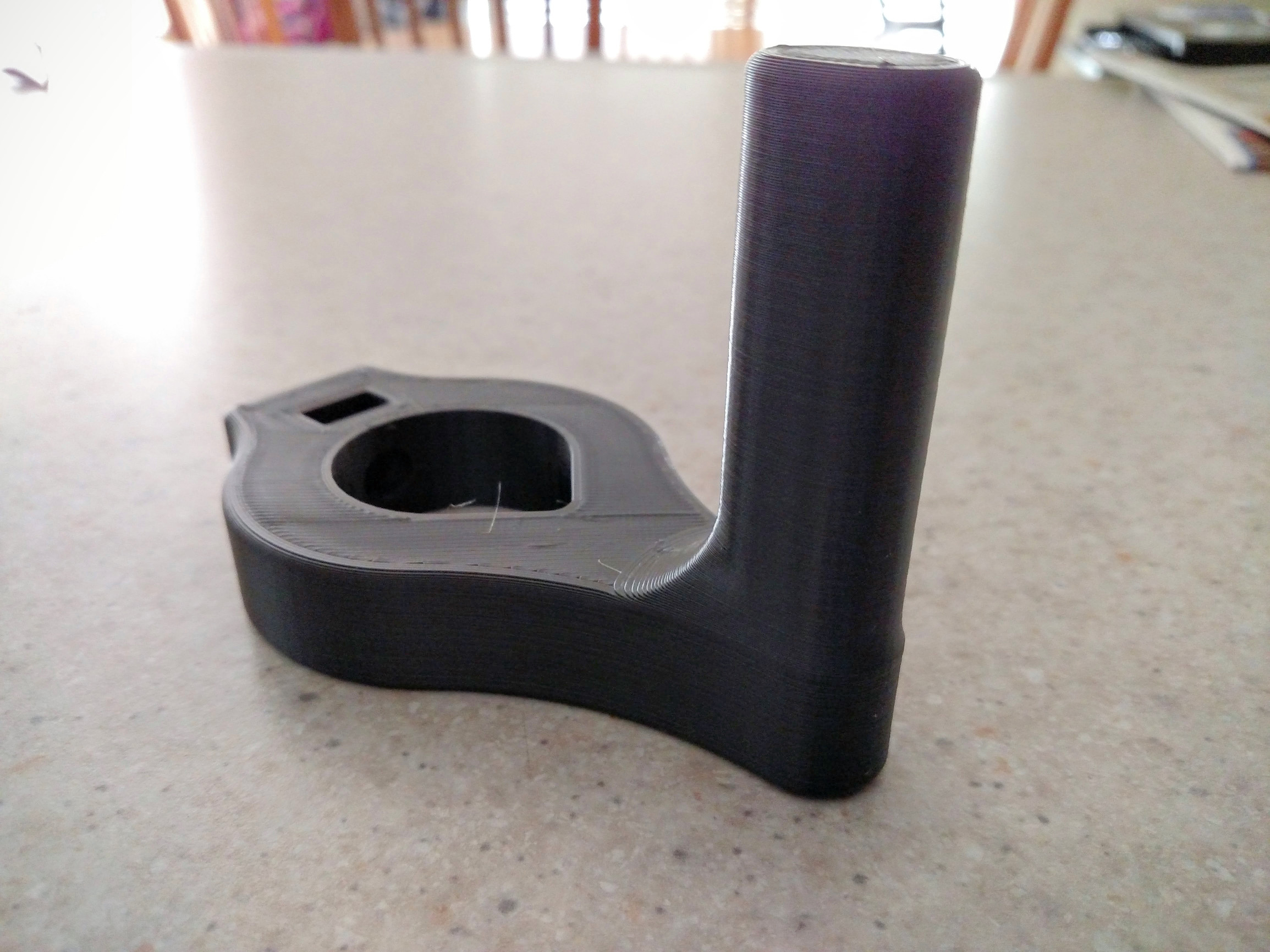

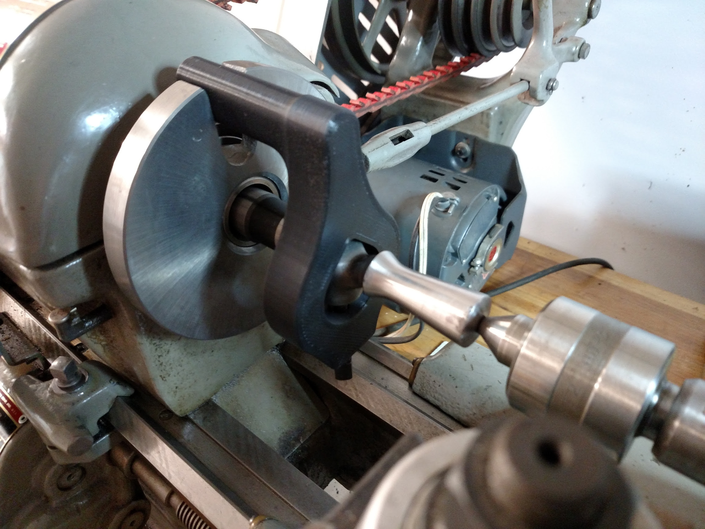

Lathe Drive Dog
Couldn't find a drive dog with a long enough tang to engage the back plate. I'm only using it to polish a handle, so loads are not very large. Printed in PETG with 0.25 mm layers.
