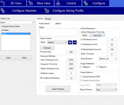

Re: mhackney's Beta DropLit build
I tried 2 settings 10s and 25s without success, with G+ white.
Maybe will I have to remove the UV filter lamp?
cheers!
Angelini
cheers!
Angelini
Humm i dont have idea about exposure time and botton exposure for G+ or SF makerjuice,
any idea ?
My projector are 2500 lumens.
any idea ?

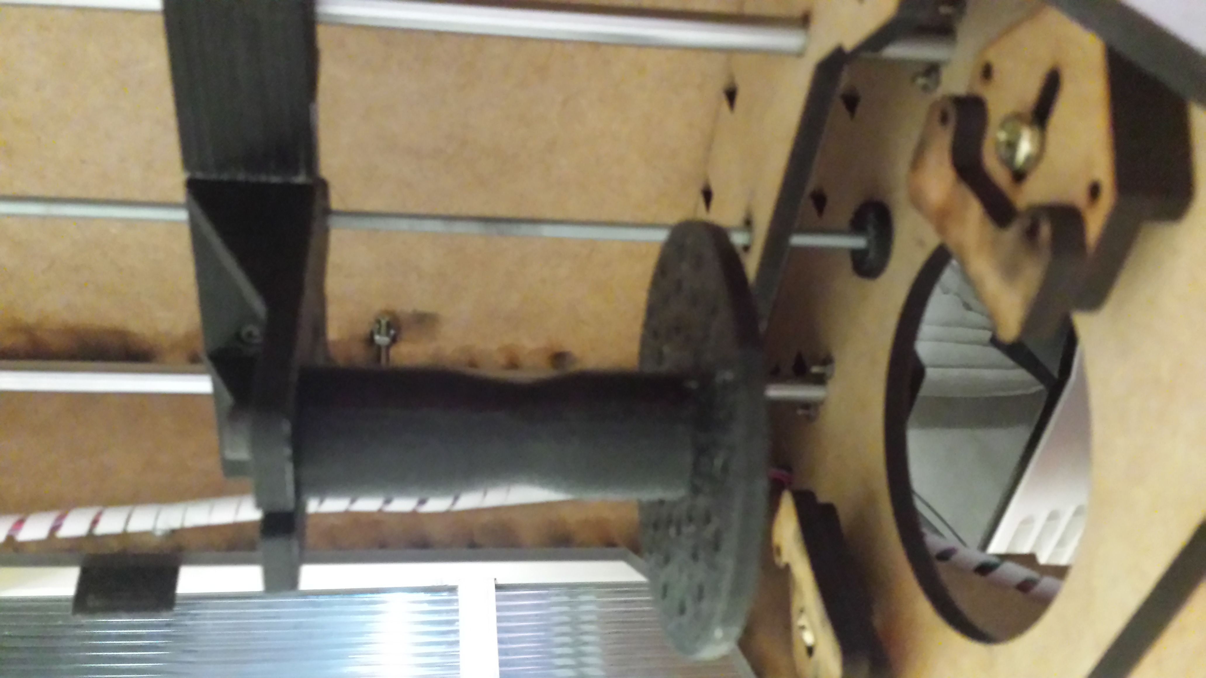

Re: Time for some DropLit mods!
Nice!!! if works share with us your stl's :) i fix some problems im my printer, changed mirror to doble side mirror and end my problems with ghosts! now back to stick problem :) cheers angelini Now that my DropLit is printing of course my mind turns to ways to improve it! First up is that tiny ...
yep i need alu kkk!
