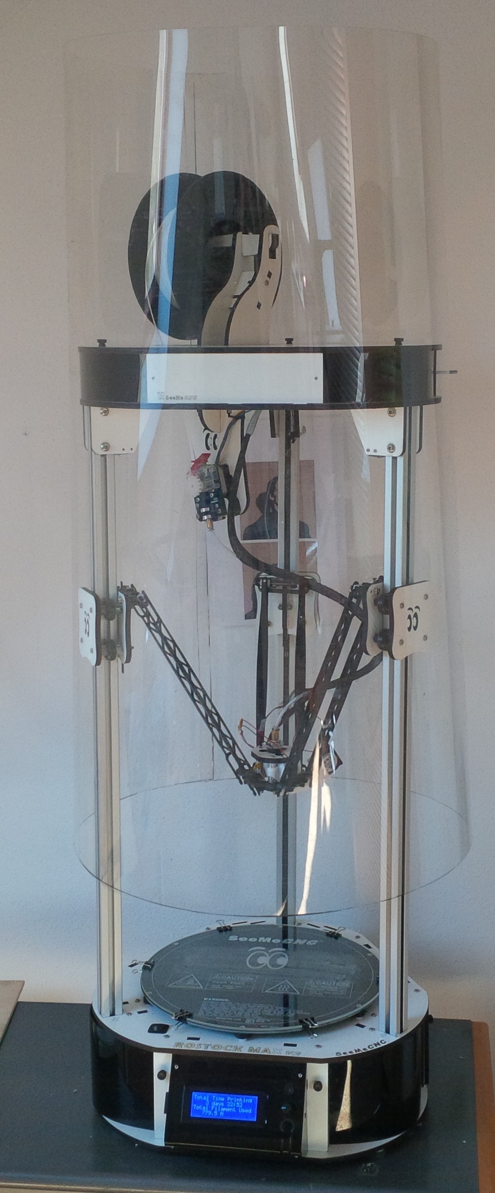

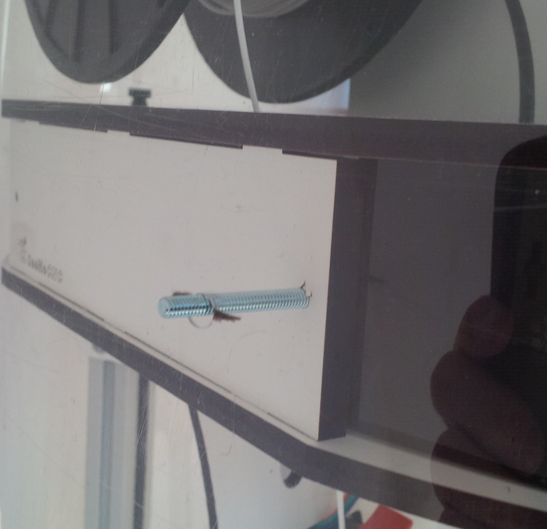

Re: Plexiglass Enclosure for Rostock 2 -- Any Suggestions?
What do you think of my version?
It´s not plexiglass but 0.8mm PET.
it is just a cylinder with some holes in it to open the casing.
The holes fit to two extended screws from the top assembly.
It`s super simple and inexpensive.
