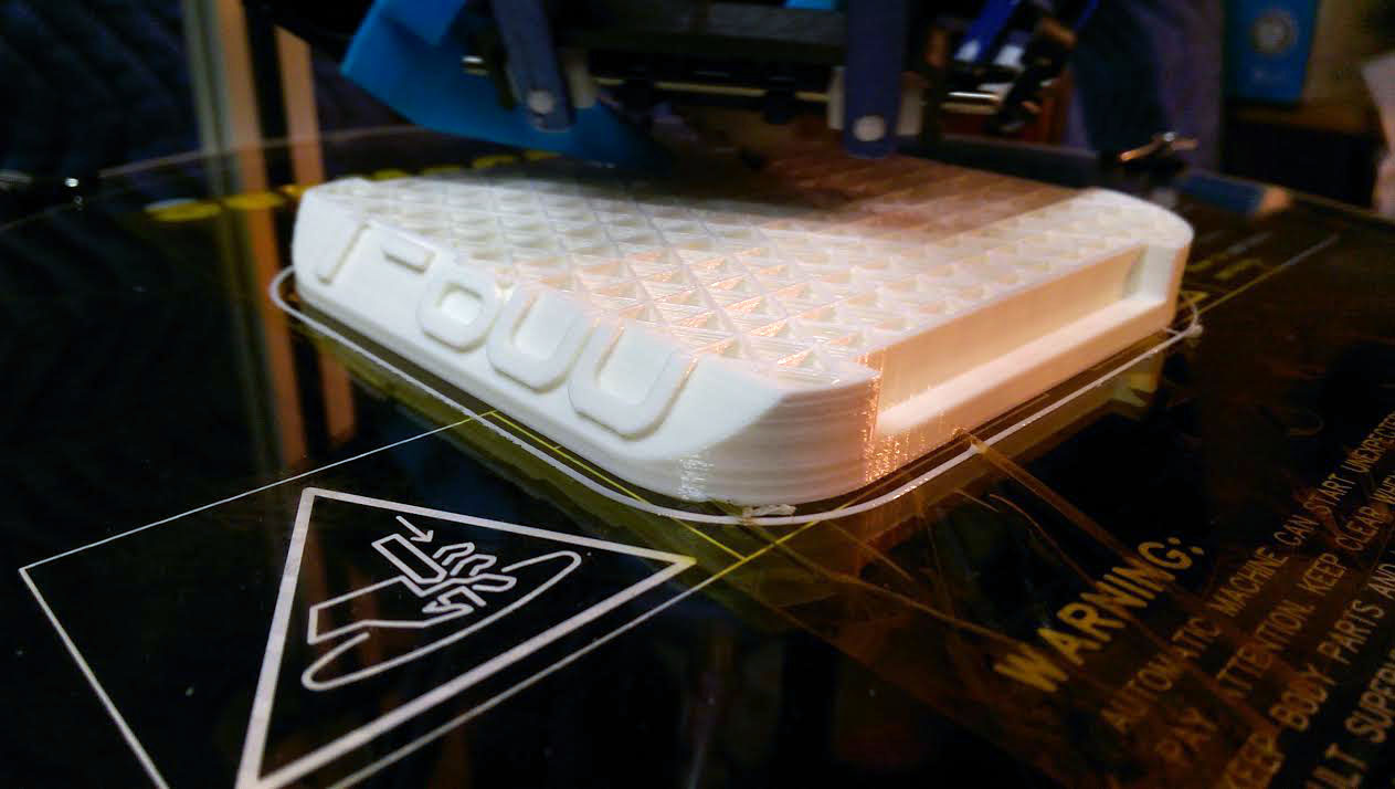

Re: FrznTek's R Max v2
It has begun, my first long/big print (33h 30m)!
smells like waffles and kind of looks like it too.

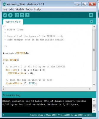

by FrznTek
Sun Mar 29, 2015 12:30 am
Forum: The Build Zone
Topic: FrznTek's R Max v2
Replies: 30
They got back to me on Friday and had me test/look at some stuff. I ran the clear eeprom, re-downloaded the firmware, made the motor change to "{155,155,155,165,0}" just like last time, and no change. (the Y axis still doesn't move when plugged in to the Y axis port.) the pins also look fine. I ...

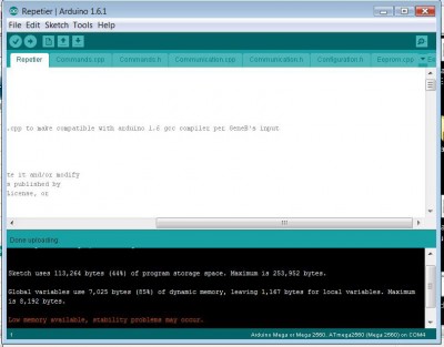

by FrznTek
Wed Mar 25, 2015 8:06 pm
Replies: 30
as for the low memory... "I just spoke with John our resident Firmware GURU about the Low Memory notice is nothing to be concerned with. It is a notice that 70% or more of the memory has been used and is new to the 1.0.6 version of Ardunio that was recently released (which is why it is not mentioned ...
by FrznTek
Sun Mar 22, 2015 5:18 pm
Replies: 30
just tried that, and it didn't help. :(
I did notice that the low memory message appears even when verifying the firmware's code.
by FrznTek
Sun Mar 22, 2015 4:13 am
Replies: 30
I tried again, here is what it says... (BTW, it had no effect)

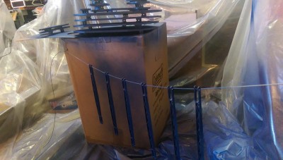

I would love to see some pictures after the paint job. Cobalt blue sounds great. Painting the pillars does not sound like a good idea. You would need etching primer to get a good bond to the aluminum. Best to have them anodized rather than painted. Thanks, and yeah if I decide to paint them I'd buy ...
