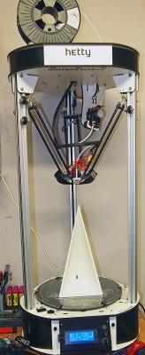

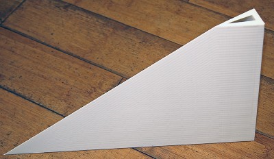

Re: Rostock Max V2 - New build
and finally for now - a custom designed Kefir stand for my fridge using multiple slot together parts that were glued when finally assembled - the accuracy of the new setup made this a successful print right off the bat...

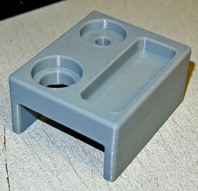

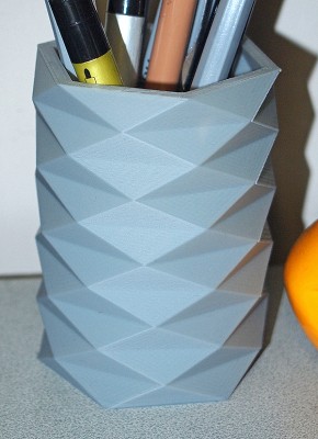

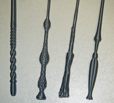

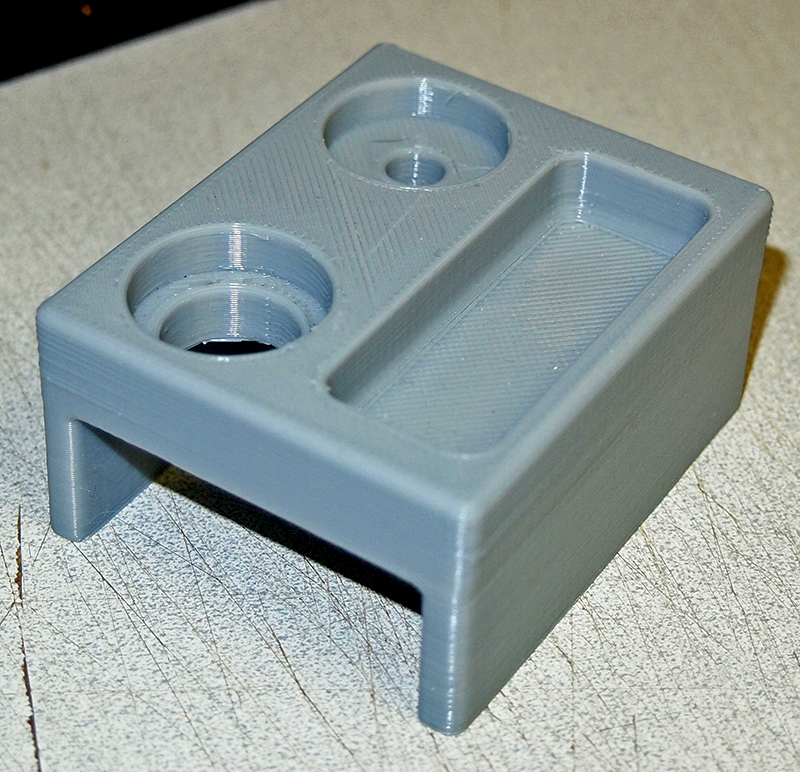

And here are just a few Of the resultant prints I've managed to download or design and print..
Single perimeter pen holder
Maintenance dock for Vaping Gear
Potter Wands for the Kids: Two downloaded and two designed by myself
