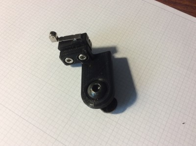

While I'm waiting on my WaterJet guy to cut my modified "TrickTrucks", I'm working on the details.
