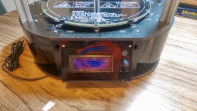

Howdy all, Playing with OctoPrint and Rostock Max v2. I've had it assembled for a little under a week and I must say the machine and the tools are incredibly easy to setup. Printing the top of a case for my Raspberry Pi 2 that is currently controlling the printer. <<print is completed - redacted ...

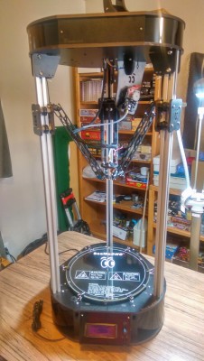

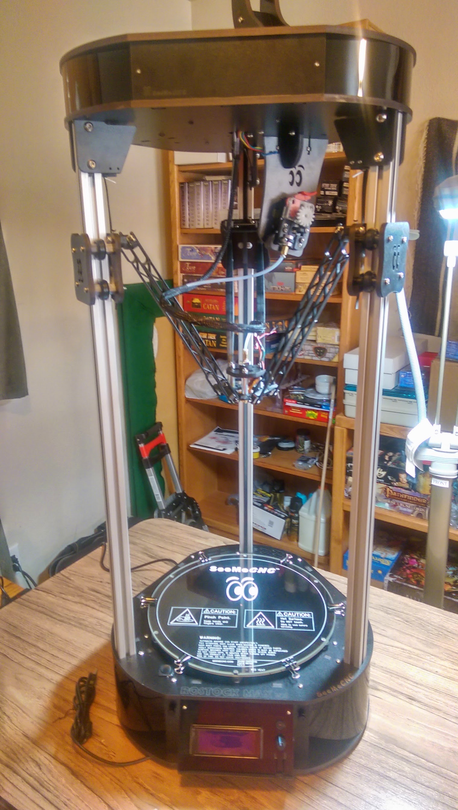

Day #7 - Build completed and first print came out incredible! It is really quite amazing to see this printer go to work and start printing. While building it was a challenge, it wasn't a frustrating challenge. It was a great deal of fun. Even better is when the first print 'just works'. Kudos to the ...

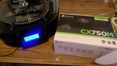

It....... Lives.......
Installed a Corsair CX750M power supply
It has a modular cables, meaning, fewer wires behind the PSU. Downside? All the wires are black, so trying to find 6 yellow and 6 black is REALLY challenging and you have to be very careful.

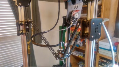

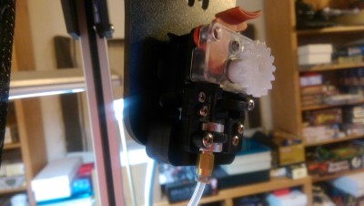

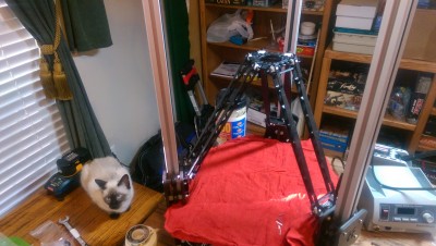

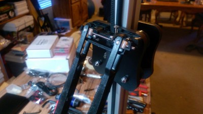

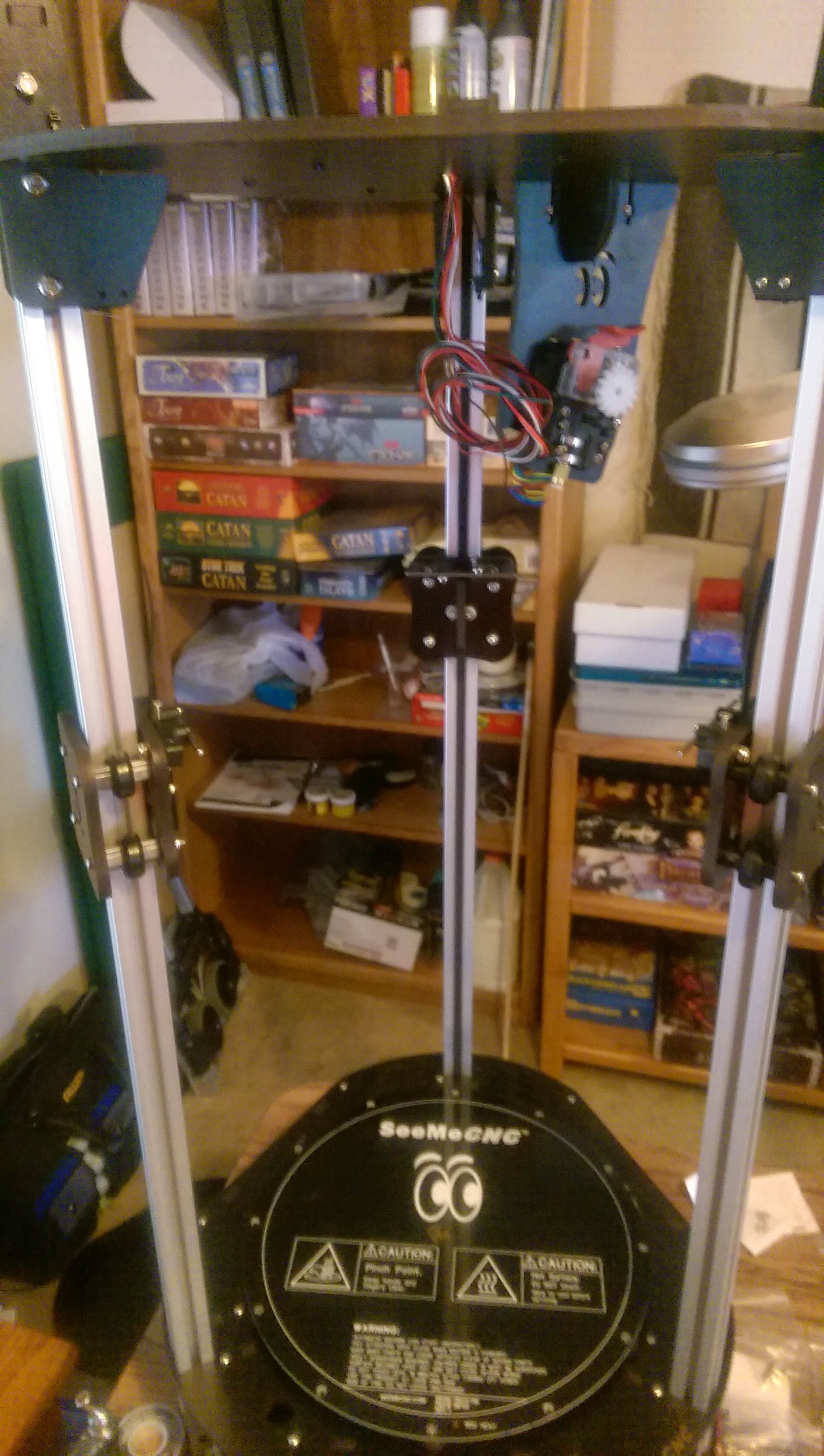

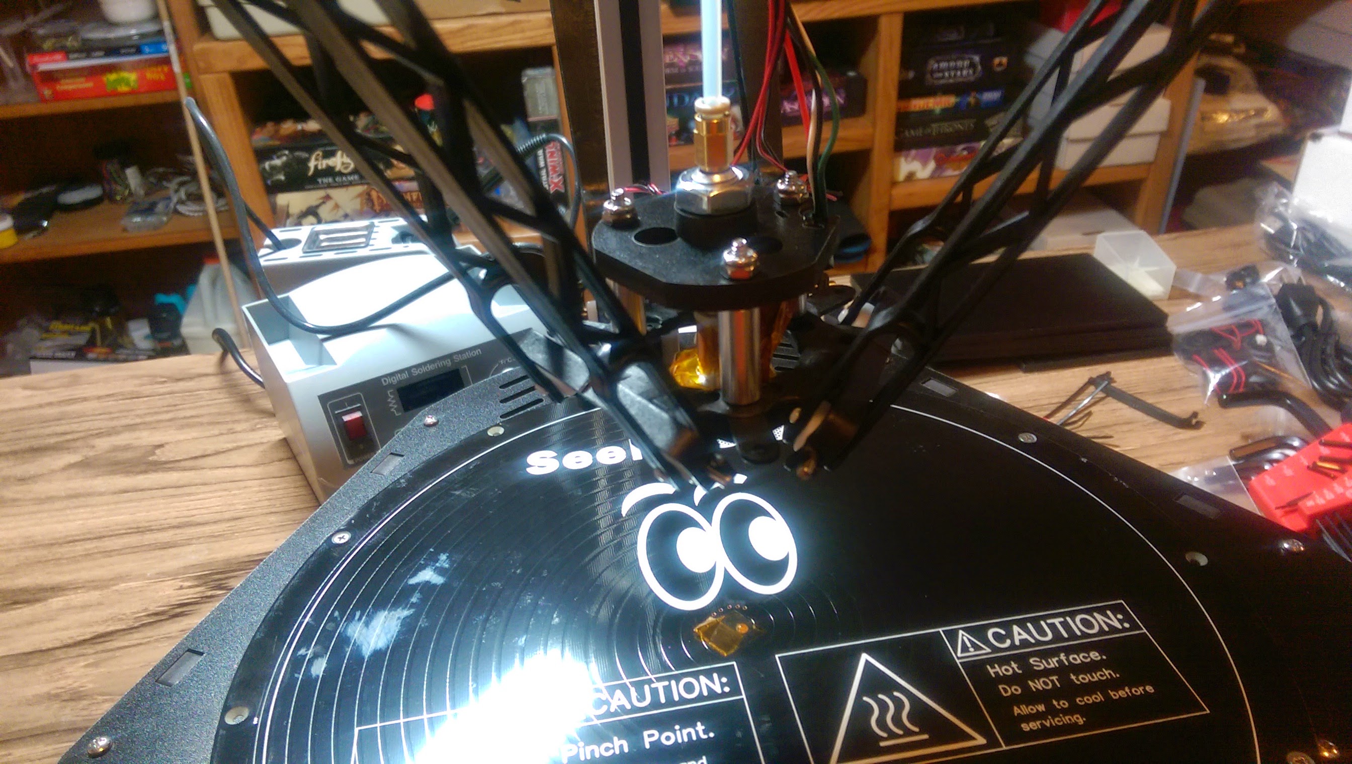

Day #5 - Got the mechanical build completed today. It actually looks like a printer now. Next up is to get all the electronics wired up and installed. I expect I'll be powering it up sometime on Sunday.
Arm attached to the cheapskate
Hot end installed getting close to being completed.
Ez-Struder installed
Arms connected and inverted to install hot end. (Note, I was able to get a shot of the invisible cat that assists with the build)
After installing the cheapskates and the belts
