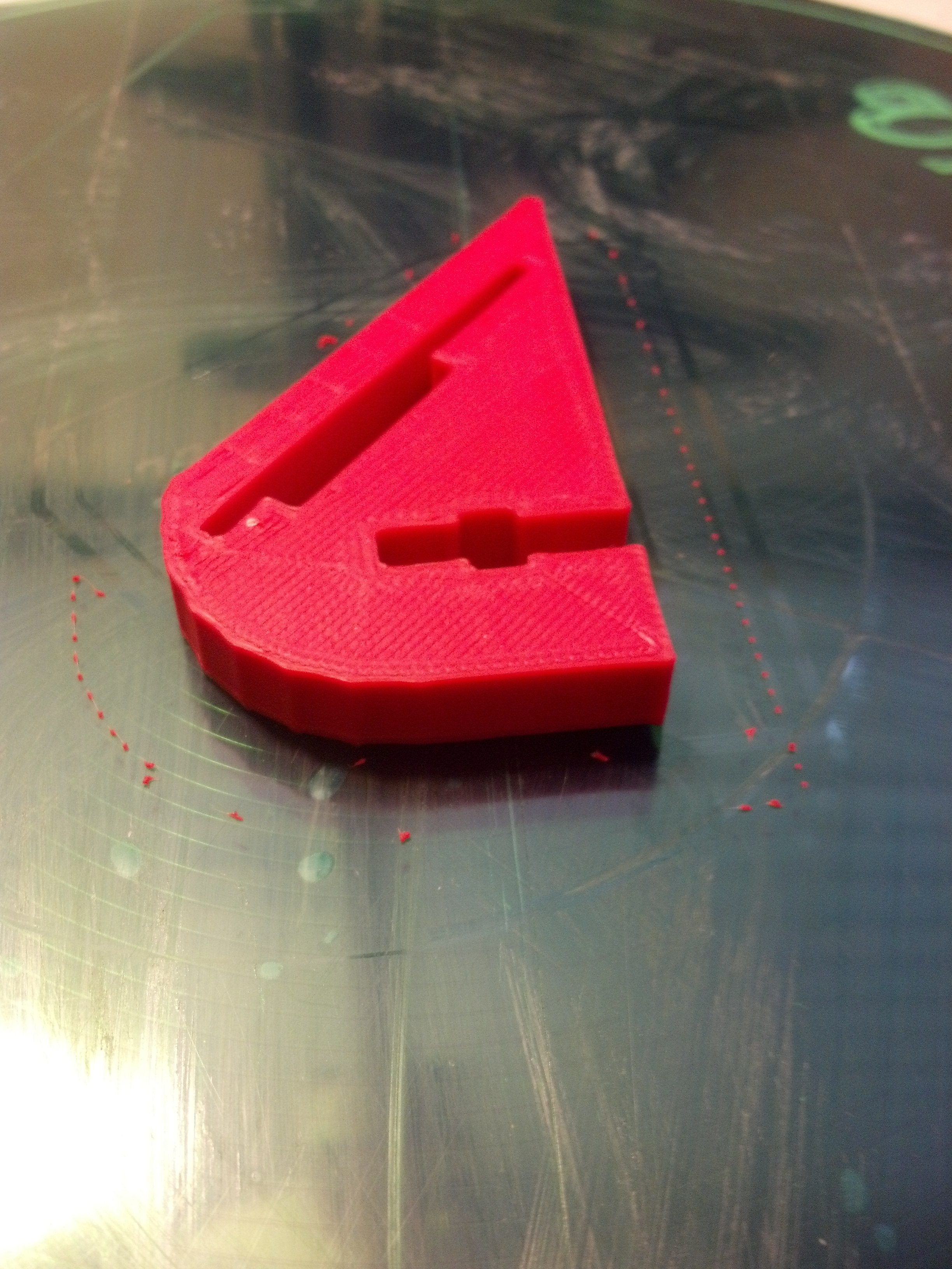

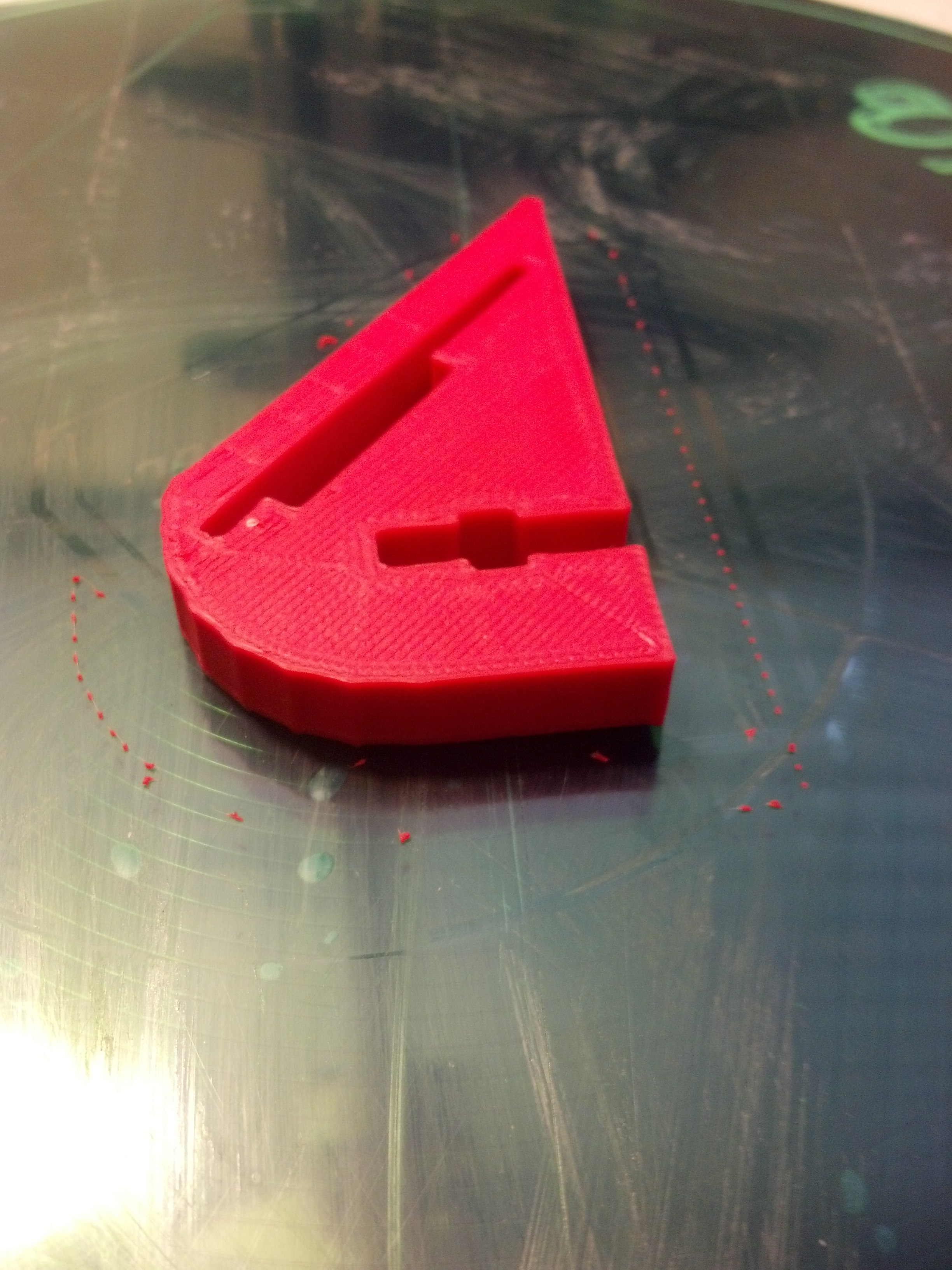

Re: Finally churning out good prints.
Another part at 100MM/sec 350MM/sec Travel
Here is a sample piece, i belive i printed this at 80mm/sec
Sorry guys. I have been busy with my printer. I switched from MARLIN to Repetier firmware, and it broke some things in the firmware that i used, i found workarounds though. I also have been updating my hot end and other things. Biggest things are: I slice with CURA I use a FAN I switched to 3MM ...
