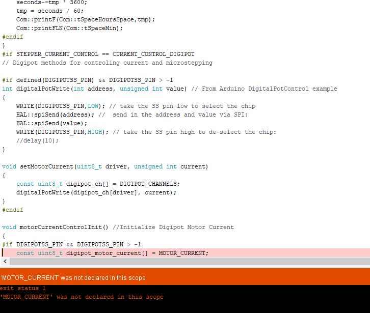

Adding the Z length did nothing. I changed the motor direction on all 3 motors, and that worked. I found out I had to change the motor direction on the extruder too. It is up and running, and does a G29 calibration now too. Thanks for all your help.

I have set Zero from the LCD Panel (not in the same place it used to be), but my homing is still going down. if I move the axis, a positive movement goes down, negative goes up. And i noticed my extruder motor is not working. I will need to look at other posts about this.

You were right geneb, I had put the machine type as Eris. Fixed that. Loaded the new firmware. Now my home direction is backwards. The firmware is 92.2 20171204. This is what I get for updating after running it for over 4000 hours and only minor upgrades. The hotend was causing issues and decided to ...

Github SeeMeCNC Firmware Master

This is the error.

Updating Firmware/ now current settings
Hi All,
I have a RMv2, Ball cup arm, HE280 (w/ HE300 head and thermister) and the accelerometer board. I am updating the firmware. it is now telling me i need motor currents to proceed with the upload. what do i need?
