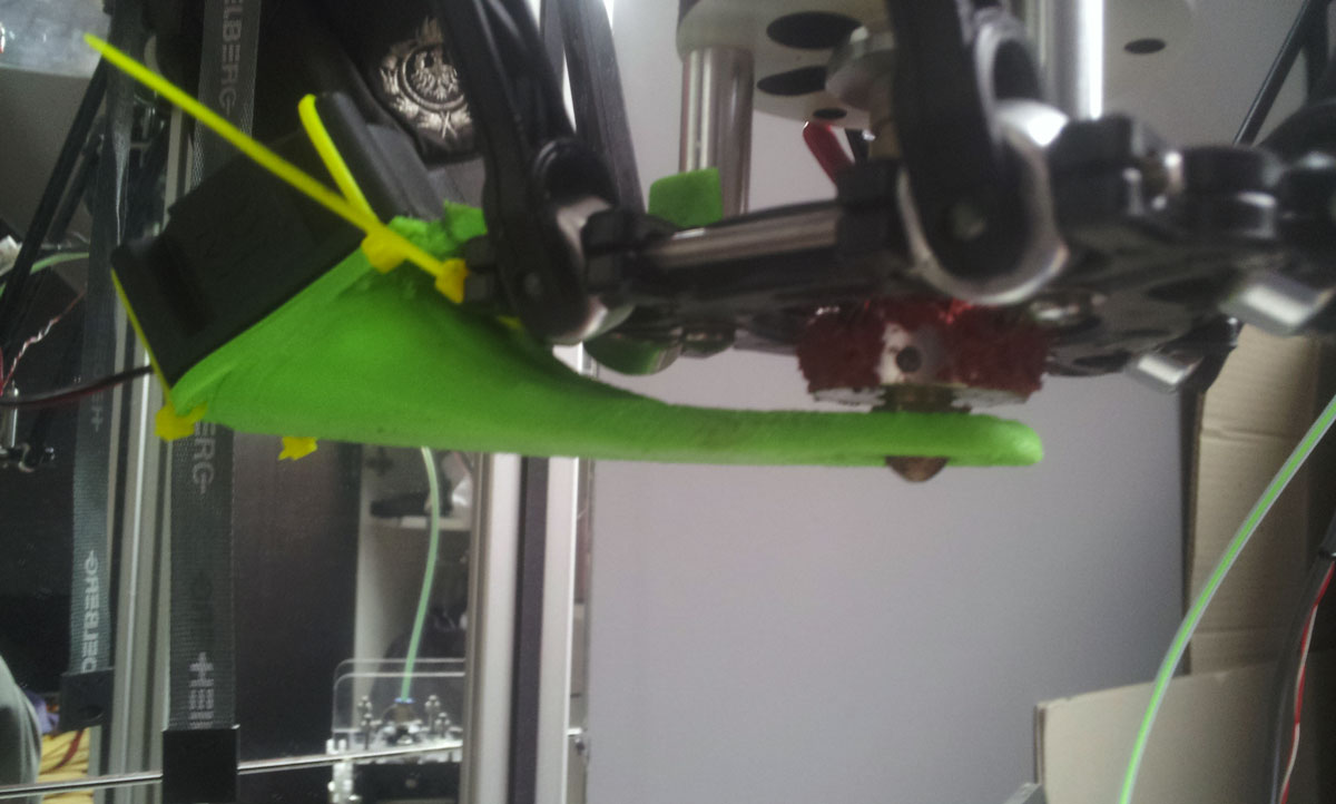

I printed fan duct from thingiverse. And I will try to use it with 5v fan. What should I do to use it, since i read that rambo outputs is 12v (can i do something with PWM). Repetier firmware

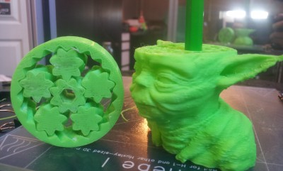

Here is my latest prints, using KISSlicer 1.0.9 an by Mhackney's setting from his build topic. Yoda head stops on layer 241.
I registered on KISSlicer forum and downloaded the latest beta 1.1.0c. It has new great features. I will give them a try

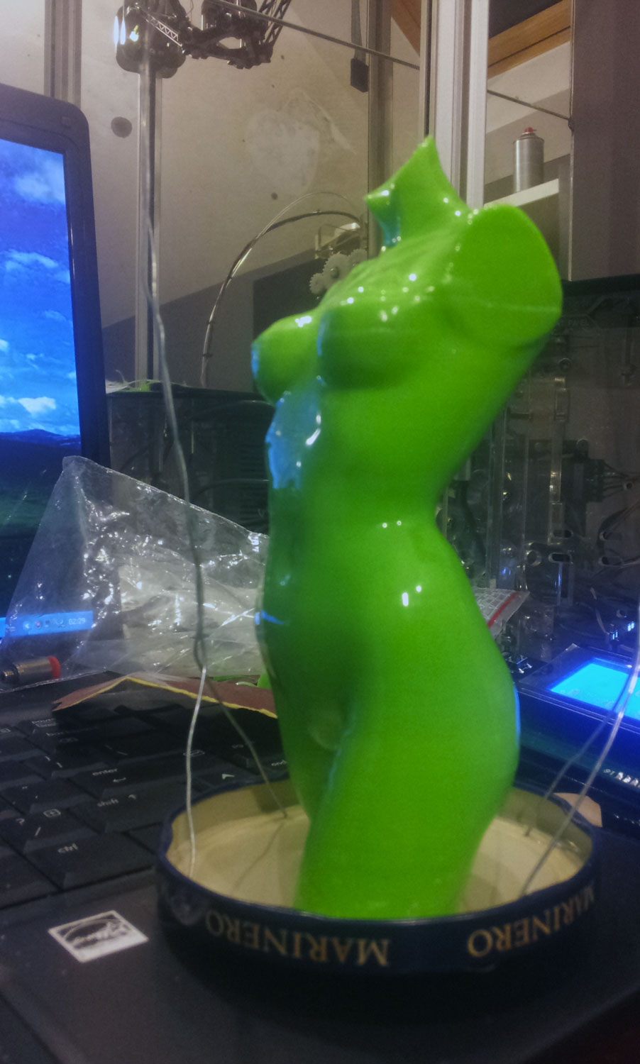

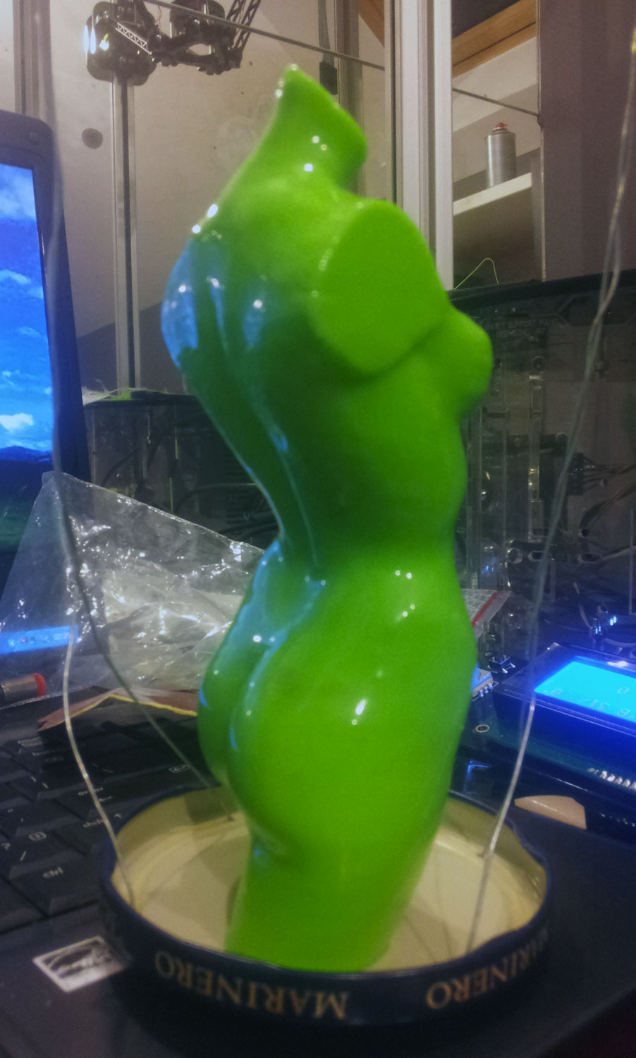

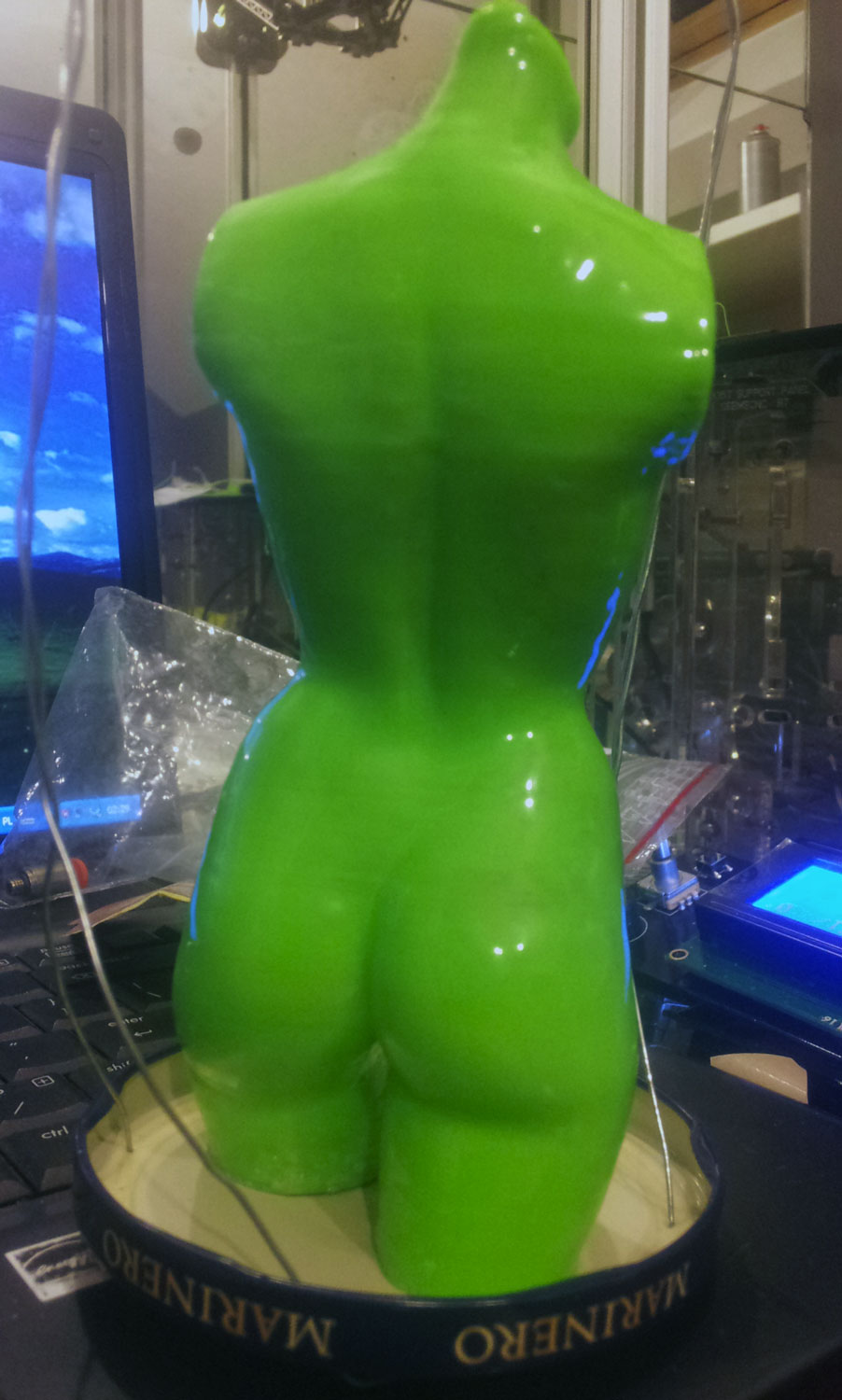

After that i give a try with acethon vapor smoothing technique I read anout here: http://www.3ders.org/articles/20130226-smooth-surfaces-of-abs-3d-printed-parts-with-acetone-vapor.html It's not the safest thing to do in your bedroom. And I'm considered is this safe on Rostck MAX since you have ...

Here's the gear bearing I just finished. This is the first time I've been able to print one that actually works (and well!). That's primarily thanks to KISS since it had a logical print path and I didn't need to use retract to minimize blobing. I have a little more work to do to reduce the little ...

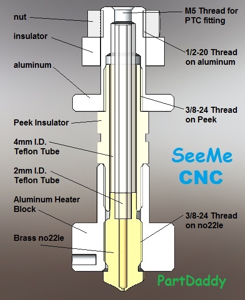

Thanks guys for replies. As I write earlier I have to dismantle the nozzle. And NOW I understand how it works. :D nozzle.jpg I coloured photo for better explanation, Please correct me if I'm wrong nozzle2.jpg 1. Green zone - here sits wider tube 2. Blue zone - here sits thinner tube. 3. Red zone ...

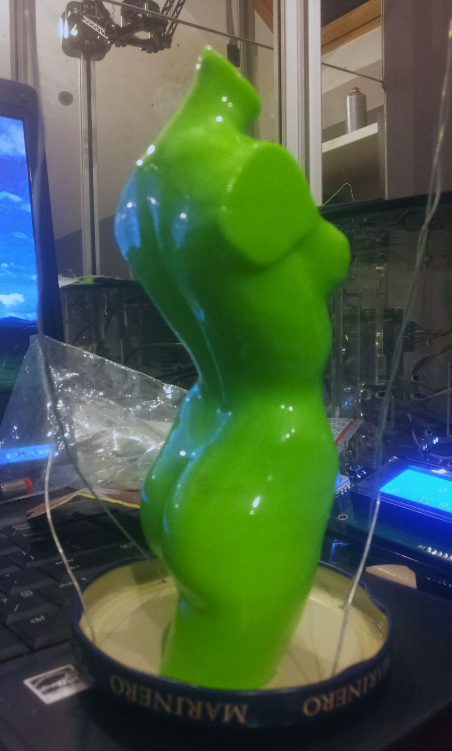

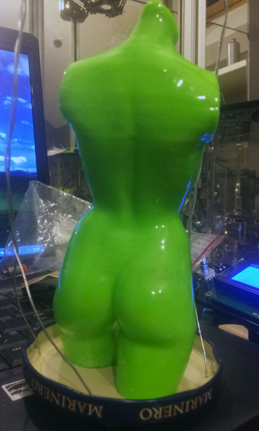

Re: GabrielK's Rostock Max
here are the results, not perfect but good start, my jar was not tall enough for this print, click attachment for bigger res.
Not the safest thing to do in bedroom
