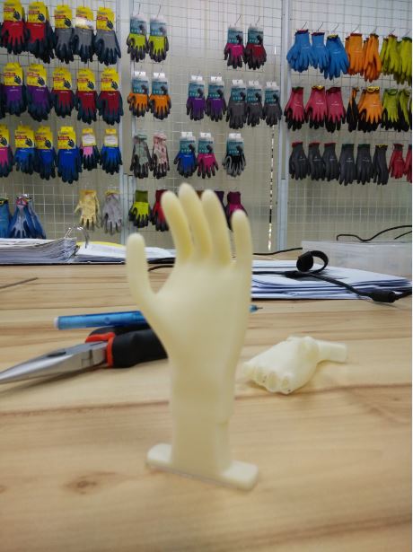

Thu Sep 10, 2015 10:54 pm
Topic: Hi from Malaysia
Replies: 6
Re: Hi from Malaysia
May be the manual should include removing paper before start building. 8-) 8-) DIY nerd
The completed build
My Build
My Build
First print
Second
Third
Mini Hand. Bahind is failed print. Base not stick well. Behind behind are the home and garden gloves manufactured by us

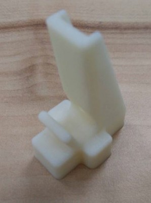

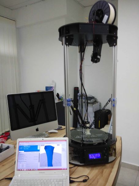

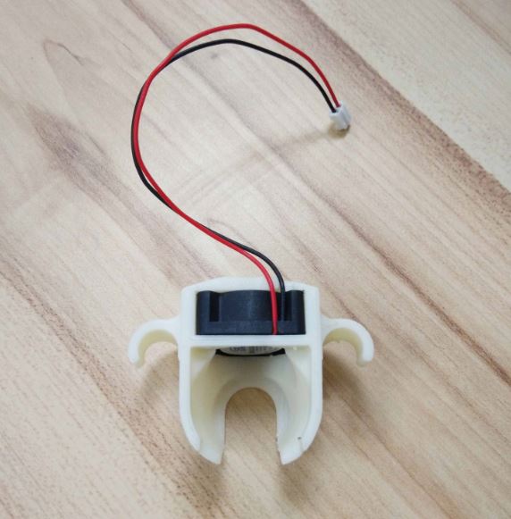

Thu Sep 10, 2015 7:15 am
Replies: 6
It's 3 weeks already and finally the build is completed. Managed to print the peek and layer fan holders. Glitches along the way. 1. Inverted the top section base plate. Somehow I messed up the left and right. Power and end stop cables crossed. So had to do some re-routing of the cables to separate ...
