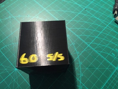

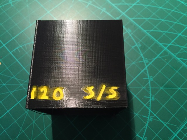

Thanks for doing this test,0110. That's a really good data point.
The next test would be to lower your segments per second value, and see if this changes the pattern.

Another thing to try is to lower the segments/second rate in your firmware. Halve it and you might see an effect like this:
