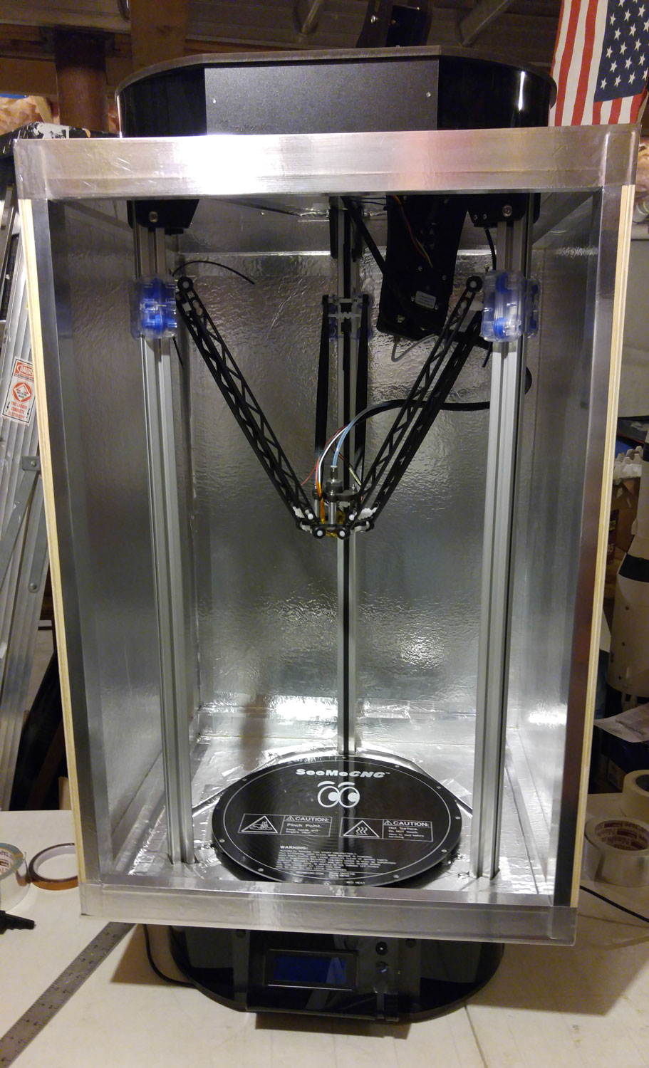

Installed a 300W rated ceramic lamp fixture with a 250W (120V AC) heat lamp in the upper left side of the enclosure. This is temperature limited by an Inkbird ITC-2000 controller set to shut off at 70C. Most of the time the chamber sits at a natural temperature equilibrium in the upper 60's, once in ...

For the door, used 3 overlapping layers of 1/4" marine plywood. Middle layer was not as wide as front and back layers, creating a pocket to hold the Lexan polycarbonate window. As the Lexan was thin, I used two layers with a thin air gap. This fit well in the 1/4" pocket created by the plywood. Used ...

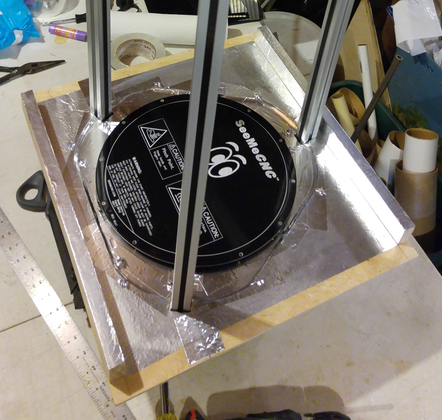

First screwed in top and bottom sections.
Then screwed on sides and back.
After each step, applied aluminum tape liberally to seal corners and make sure all internal surfaces were heat reflective.

Covered areas with painter's tape as needed to control where the DAP Contact Cement went on. Used this to adhere tinfoil to inner surfaces of chamber during assembly. Elmer's wood glue attached 1"x2" corner rails to a wall. Then screwed wall assemblies together. Designed so each wall, top, bottom ...

Design goals of the enclosure: 1) Enclose build area and not electronics 2) Get hot enough to successfully print large ABS parts without warping, research on this forum suggested this was in the 50-70C range 3) Be relatively cheap and easy to build Materials: Walls and top: 1/4" Sureply, as this is ...

60-70C Heated Enclosure
Got the Rostock MAX kit and assembled it last month. Assembly went well overall and was able to print small ABS parts with good results. I have long had an interest in model rocketry, and one of my objectives is to print rockets/rocket parts. Personal rocketry website http://www.bpasa.com Desired ...
