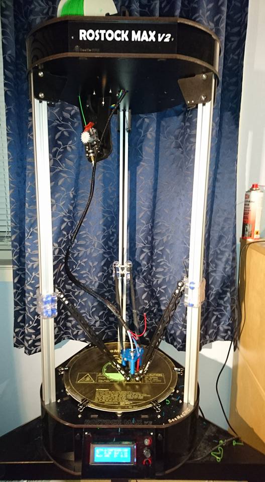

Rostock MAX v2 in Viking land
Hi here is a picture of my Rostock MAX v2 working on a prototype for a 100w LED diving torch
Sorry for a blured image, z5 phone.....
