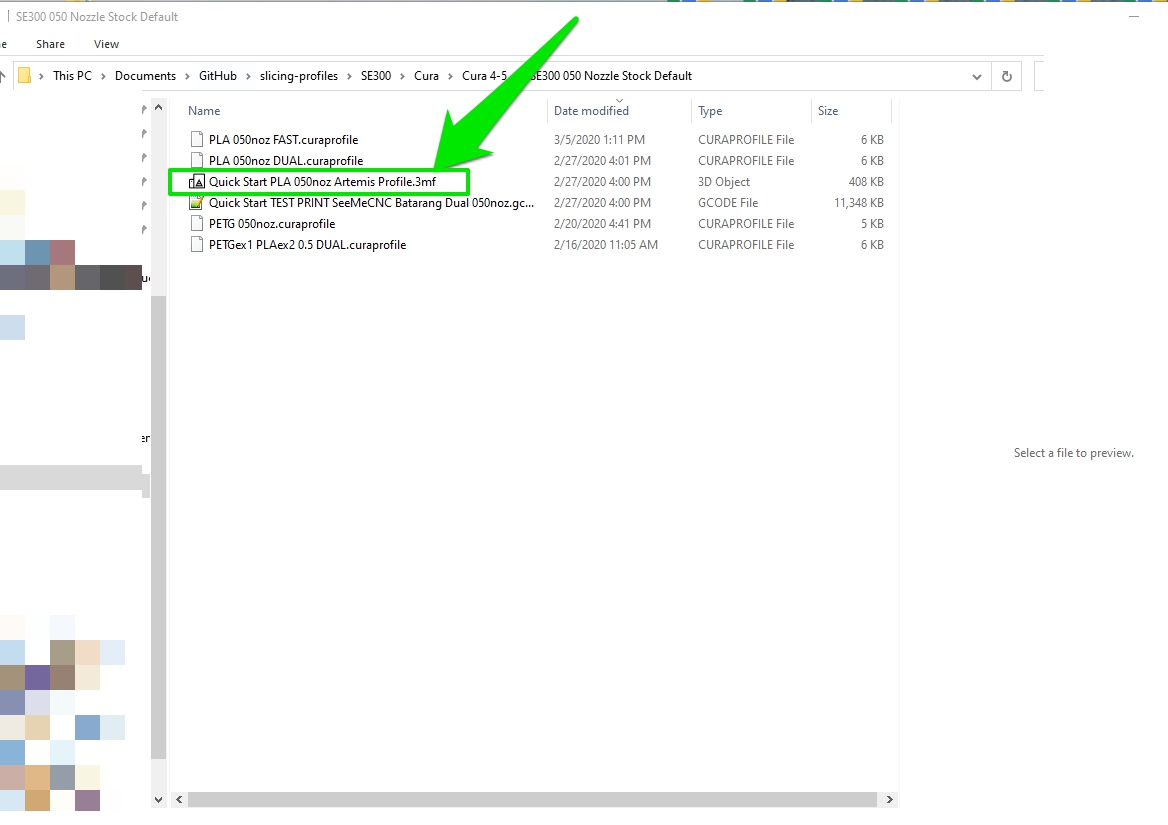

Re: Simple Two Color Prints/PETG/Linear Advance
In Cura 4.5, from the menu, choose "File" then "Open file(s)..." and select the following file form our GitHub download. Then uncheck "Dual Extrusion" in the slice setting. A purge tower will not print and the printer will switch.
