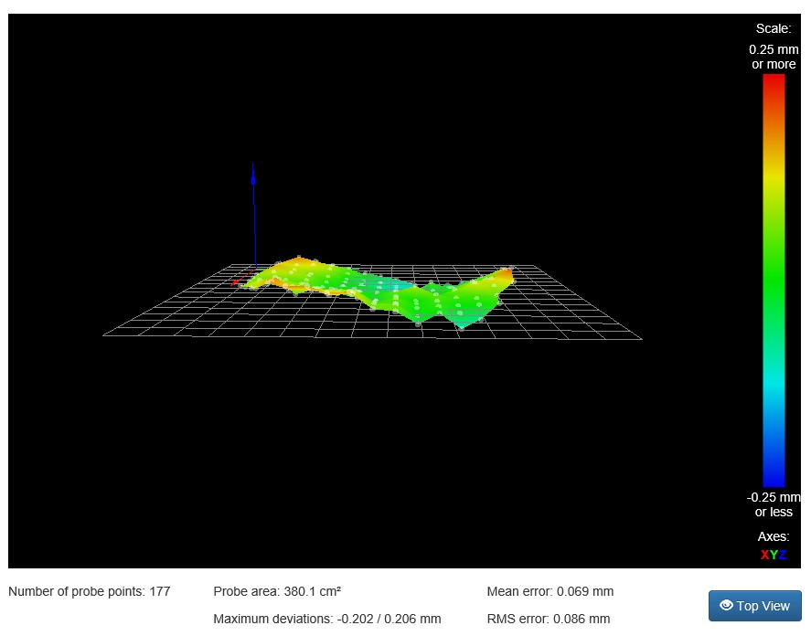

Here is my current map:
And my step adjustments:
M92 X80 Y81.0 Z79.0
M92 X80 Y81.0 Z79.0

Ok, sorry I did not wait for a reply. Here is a new map after changing my Z motor counts to 79:
Is this normal? Is there some other mechanical issue that might be causing this? Belt tension perhaps?
Or should I be looking to replace that stepper motor?

So this is fun. Here is a picture of my current height map: map.jpg This is after G32 calibrations. I rotated my print surface and the map came out the same. So it seems I have an issue with my Z tower, but not exactly sure what. Axis compensation perhaps. But I am thinking this problem has persiste...

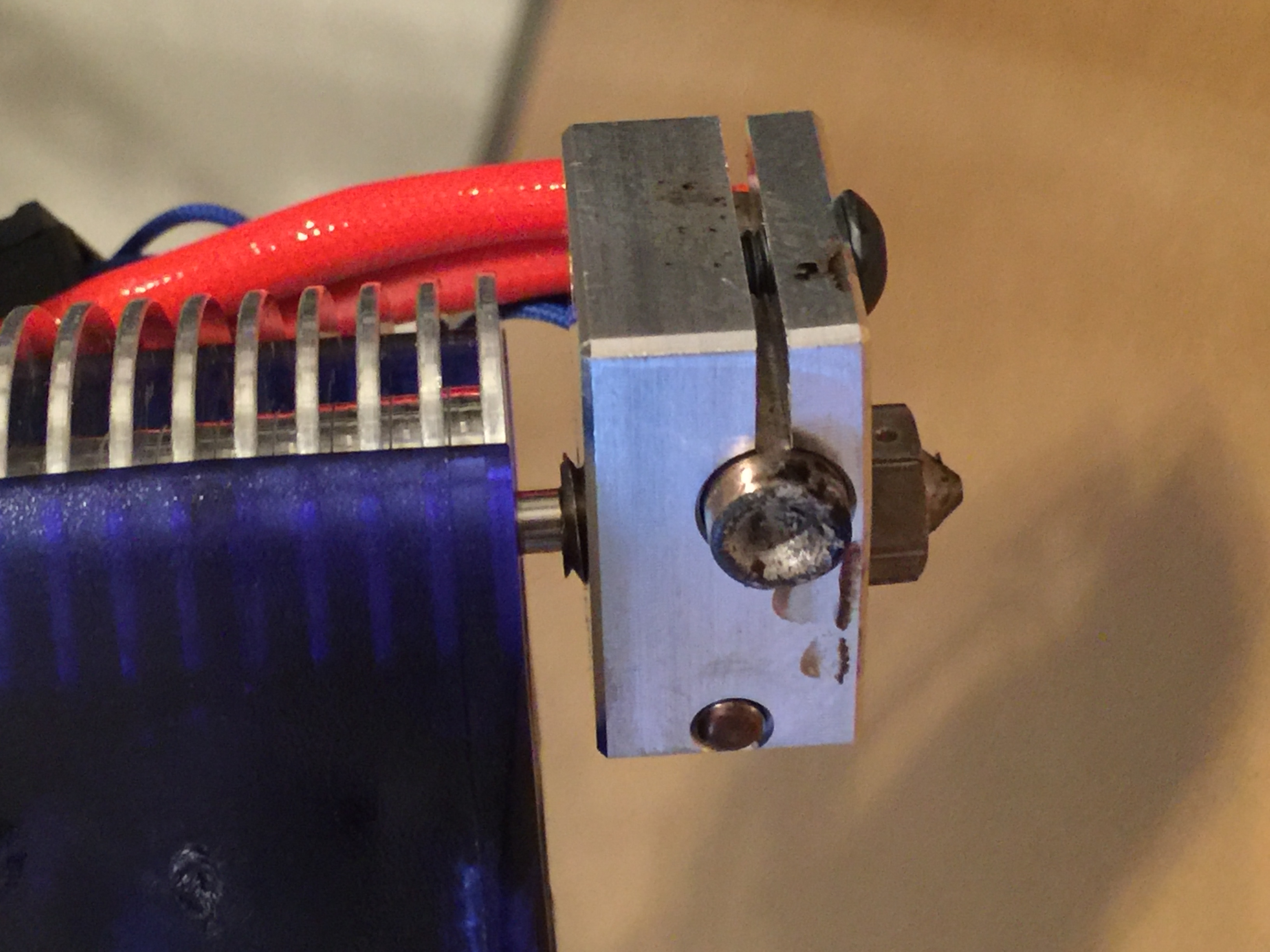

I checked the rotation of the extruder gear / shaft, no wobble. I think the dark area in the picture is just a shadow, when I shine a light on it there is no obvious mark. I did a small adjustment anyway, moving the gear out a bit. Ultimately no change. Back to the filament that clogs so well, high ...

I did a close watch on an aggressive print (lost of short back and forth movement) The temp was stable, the cooling fan stayed on the entire time. I moved the wiring around to see if I could cause a problem but nothing changed. Here are some pictures: I think my extruder is aligned properly IMG_1975...

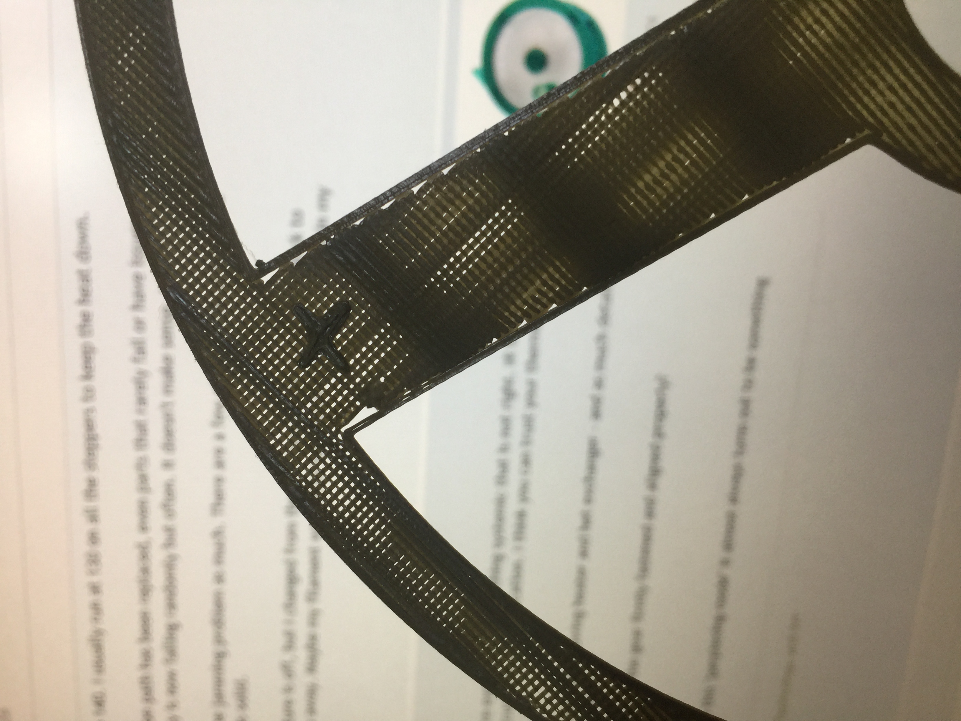

This is a print that did not jam completely, pics of the printer parts coming soon...
