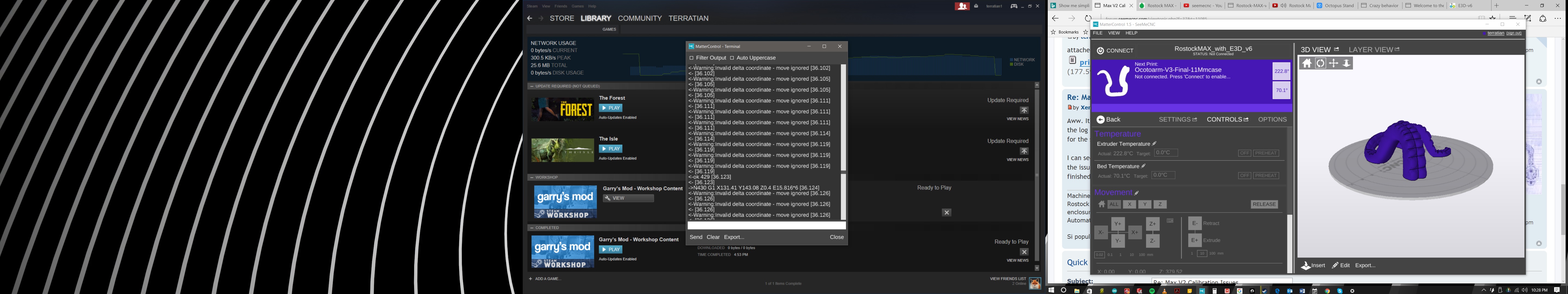

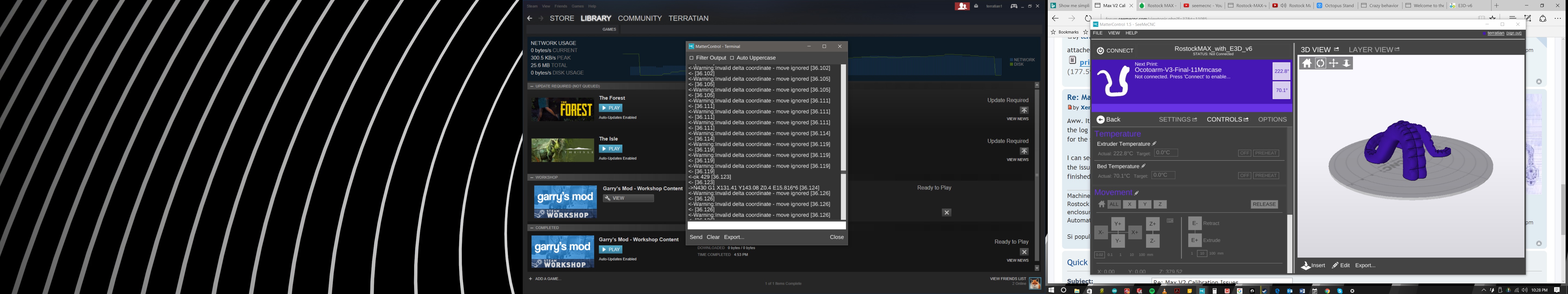

Max V2 Calibration Issues
[img]https://drive.google.com/file/d/0ByXOx7k2ZDhNeFliM1JjZlY0dms/view?usp=sharing[/img] https://drive.google.com/file/d/0ByXOx7k2ZDhNeFliM1JjZlY0dms/view?usp=sharing excited to finish calibrating so that I can print. I have finished the guide to the best of my ability, when Attmepting to print the ...
