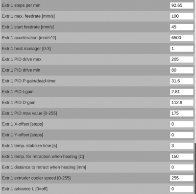

So I'm giving up. I ordered a 40w heater and a threaded thermistor and will be rebuilding the hot end shortly. My max temps keep getting lower even with the increasing eeprom settings. Has to be a damaged resistor or something. I keep printing and watching the temp drop 20 degrees as soon as the ...

So the thermistor default issue goes back to the low temp settings. the default issue happened when the temp dropped below 183 for pla set to 210. Im sure the low p max value (205 i reset it to) was not enough to keep up with the extrusion. I have it at 220 now and the temp is still dropping ionto ...
- Tue Jul 19, 2016 11:54 am
- Forum: Troubleshooting
- Topic: M303 S200 WONT REACH TEMP AFTER FAN INSTALLED.
- Replies: 17
Re: M303 S200 WONT REACH TEMP AFTER FAN INSTALLED.

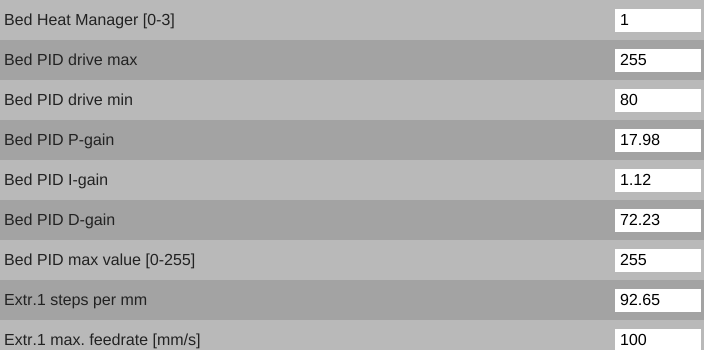

I am up and printing now. Thank you guys. I raised the PID max from 175 to 205 on the bed and extruder and seem to be good on the temps now (I ran an auto tune on the hot end). I did get halfway through a pla print last night and the extruder stopped and left a double def error. This happened 2 ...
I had the bed info sorry about that. Still getting used to this whole thing. Thanks for looking at this with me!
- Sun Jul 17, 2016 9:33 pm
- Replies: 17
I believe its 205 I hover around 194°.
- Sun Jul 17, 2016 6:43 pm
- Replies: 17
Hi guys,
Been working and reading the forums all day. I printed the fan shrouds last night and when they were installed today it reduces the hot end below the calibration threshold. What settings can i change without melting my printer?
