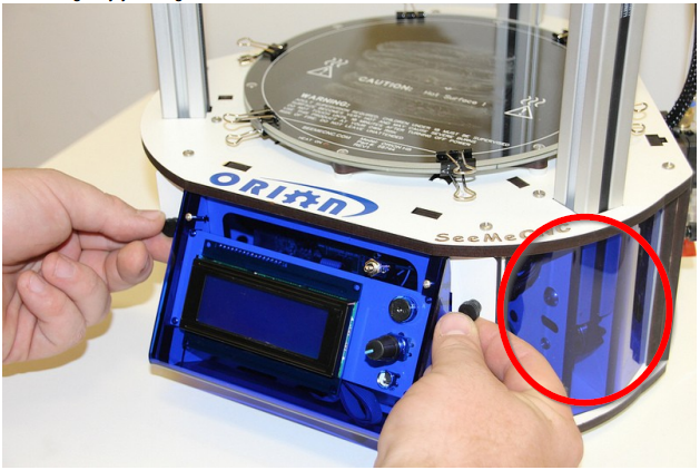

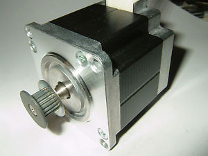

Yes Joe, behind the Acrylic cover, at the bottom of the 3 Tower,
And looking for this assembly, the pulley on the steppers at the three tower (bottom), The shaft is the "rod" that comes from the stepper, inspect the area.
