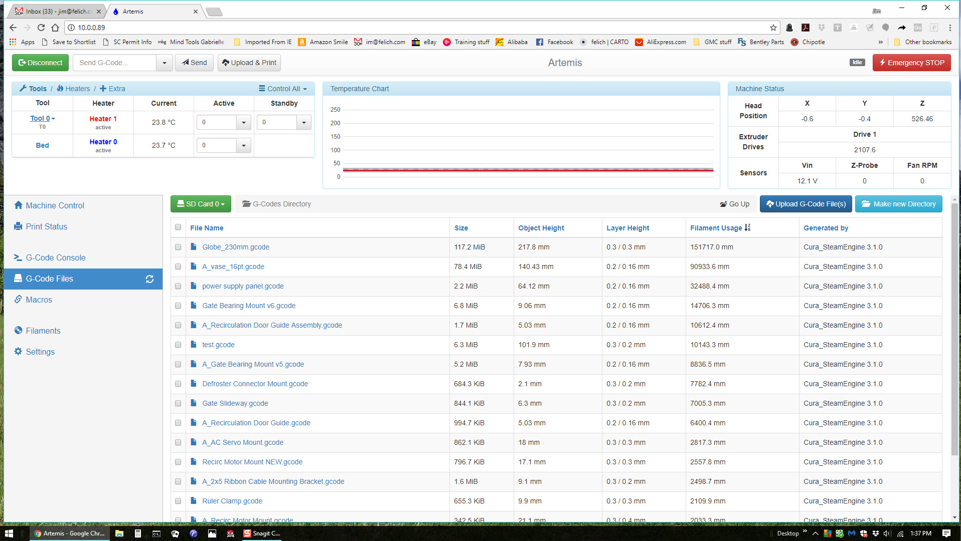

I don't see it. Please point it out.

I could not find a place in the forum specifically for software change requests, so I hope this a good place to put this thread. I have what I feel is an important request. Please add the file date to the information shown in the G-Code file listing. I am never certain that I have the latest G-Code ...
