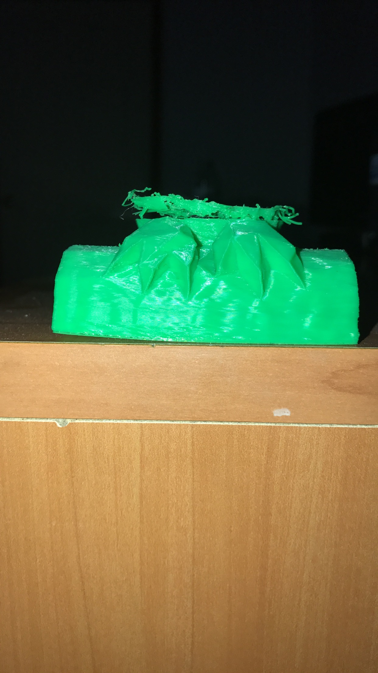

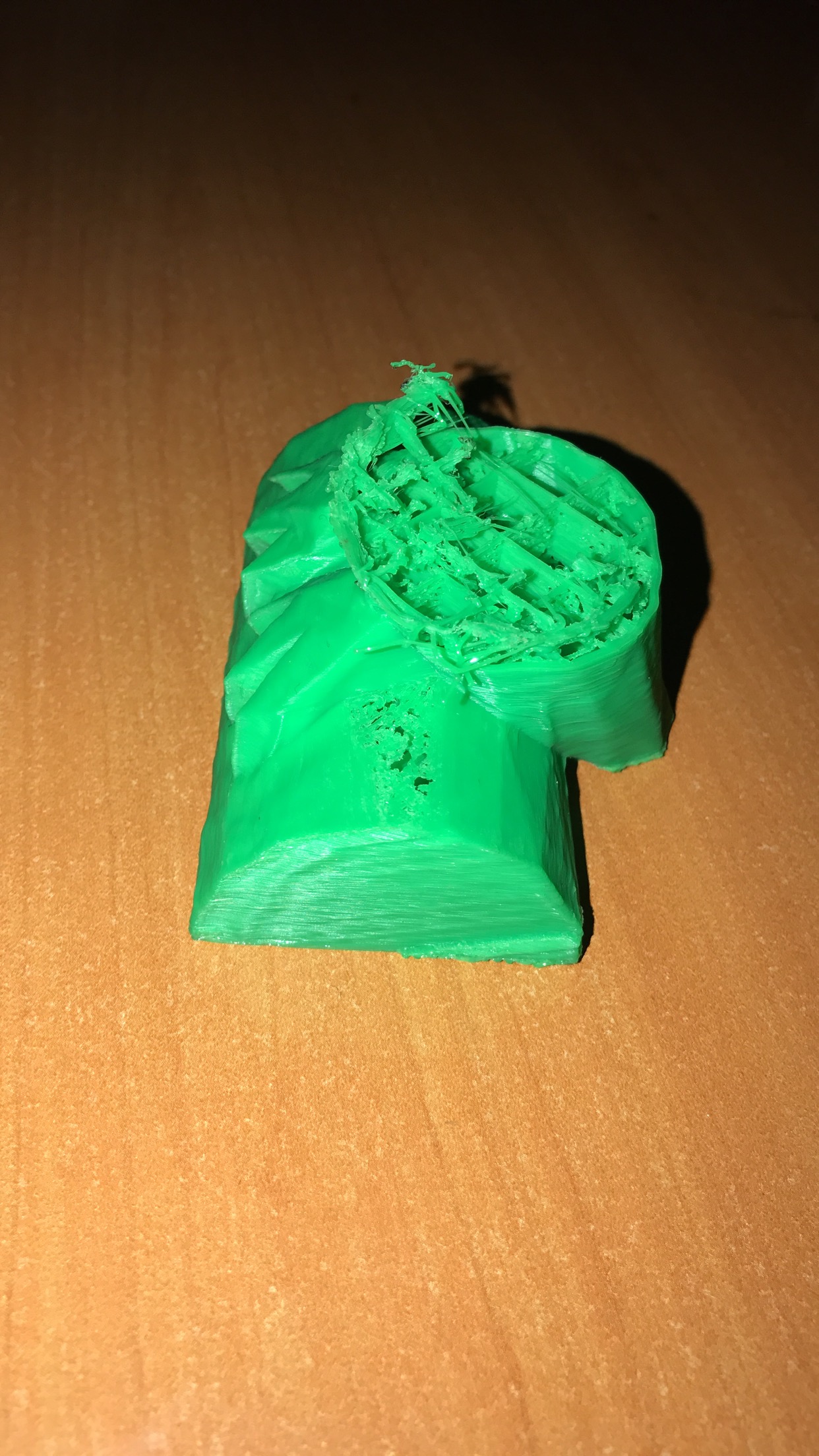

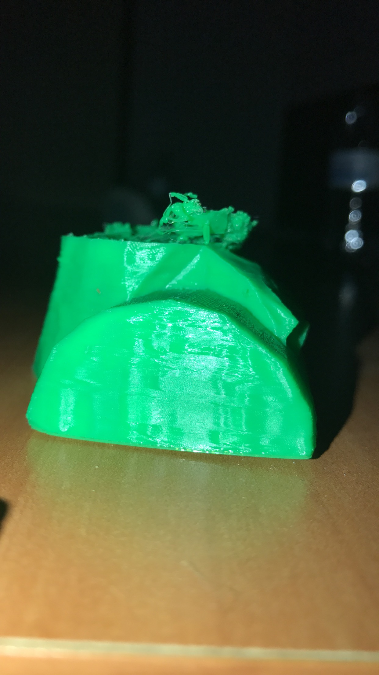

Re: Need Help | Print Messing Up
I would suspect a corrupt model. Run it through netfab. How does it look in the slicer preview? The slicer may perceive that part of the module as an area that needs bridging so it speed up. It looks good. This problem also happened when Inwas printing the eiffel tower and Inwas only on the 15th ...
I am currently using Cura with a print speed of 80 m/s

Forum: FAIL HAPPENS ! ! !
Topic: Need Help | Print Messing Up
Replies: 4
I am having this problem during prints when the first few layers go so well then all of a sudden the print speed speeds up and it's lays filament down in the air, off course of where the print really is. Need help asap.. thank you guys so much.
