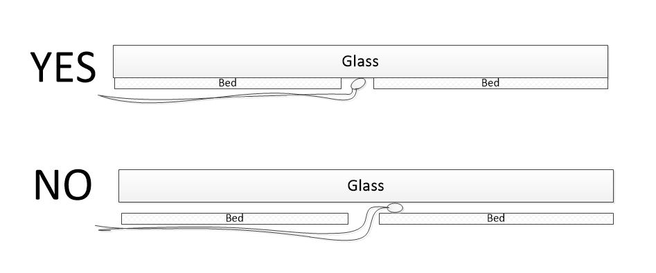

Re: Bed temp drop/DEF SOLVED!!
Great tip skyjuice, thanks!
I've been having this problem intermittently for months and that's sorted it. My thermistor legs were also a fraction too long so I just bowed them out a little to get the tip right in the centre of the hole.

Re: First Print Great, then Blown Hotbed Thermistor
Hard to be sure from the photos but did you have the bead between the bed & the glass? It's supposed to be in the hole touching the glass.
