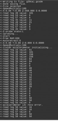

Ding Ding Ding, we have a winner!!!! Trap for new players; if your doing continuity checks in beeper mode, actually check the resistance reading because in my case with the cheap little meter I was using it was beeping when the resistance was over 100 Ohms... tossing that thing. Thank you ever so ...

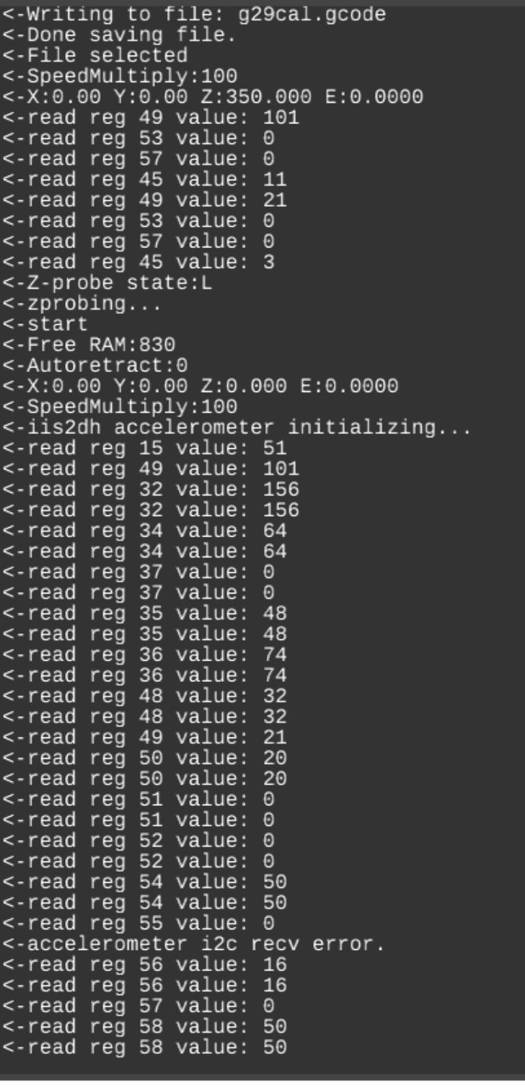

Update yes I'm pretty sure the Int Z_Probe_Pin is the problem. Today I tried the M261 command on my machine and it's value is displayed as the first thing in the list of numbers as INT PIN: 0 when reg 49 value is not 21. I see in your test of M261 that the INT PIN is always 1. So this means the ...

Changed to the v3 with the changes indicated earlier, attempted a calibration and the exact same thing happened. I've attached the output.

Hello all, I hate to make a post about this but I can't seam to find this exact issue to go off of. I have a v2 with trick-laser arms, molded cheapskates and of course the HE280. Everything got wired up with the per-assembled whip and I have check continuity on all wires and confirmed proper ...
