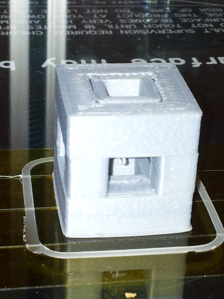

- Tue Apr 09, 2013 12:13 pm
- Forum: Rostock MAX
- Topic: cube test misaligned culums
- Replies: 14
Re: cube test misaligned culums
Here a best result,
U joints were very sticky, on the 3 arm plates,
still small defaults but now I know origin
thanks all
thanks all

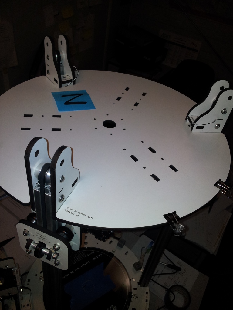

- Mon Apr 08, 2013 1:16 pm
- Replies: 14
sorry my english is not perfect and I didn't understand all perfectly, so i confused "next" by "in face of" you say me that the engraved top support have to be near the z axis, even, the top support seem to be "symmetrical" in the 3 axis, this is not the case do you think that this is the origin of ...
- Mon Apr 08, 2013 12:56 pm
- Replies: 14
so this one perhaps ....
yes, the engraved part number is on top almost face the z axis
- Mon Apr 08, 2013 12:47 pm
- Replies: 14
It It the good support photo ?

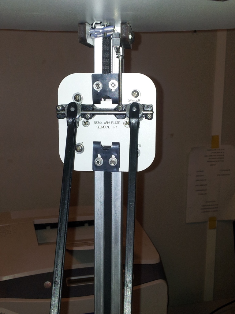

- Mon Apr 08, 2013 12:34 pm
- Replies: 14
arm.png only arms tremble in horizontal way and a little the head also sometimes, I use marlin for RAMBo firmware and RAMBo card.(all from seemecnc complete kit) in what fille could I set the value to 185 (configuration.f, steppers.h ....) ? What is the data/variable name to set ? I prefer to test ...

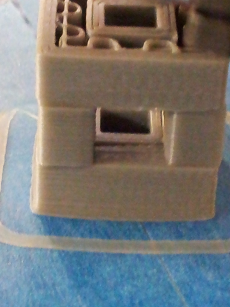

- Mon Apr 08, 2013 2:45 am
- Replies: 14
In some travels my arms don't move regularly, with trembling and vibrating by small steps U aluminium joints are sticked, With the steel axes, and with the plastic supports, near the end ans near culumns. Iit's necessary, I think, to put off all the arms, and verify all connections - as detailled in ...
- Fri Apr 05, 2013 1:46 pm
- Replies: 14
Thanks,
I will check tis tomorow,
From begin, I hear my arms squeaking a lot,
do you think that few drops of vaseline oil could help ?
calibration was long, but I think that "holy" delta arms blues will be required also....
- Fri Apr 05, 2013 9:53 am
- Replies: 14
Hi
I have almost a perfect cube, but columns are not aligned between corners, someone could help me to avoid this problem ?
