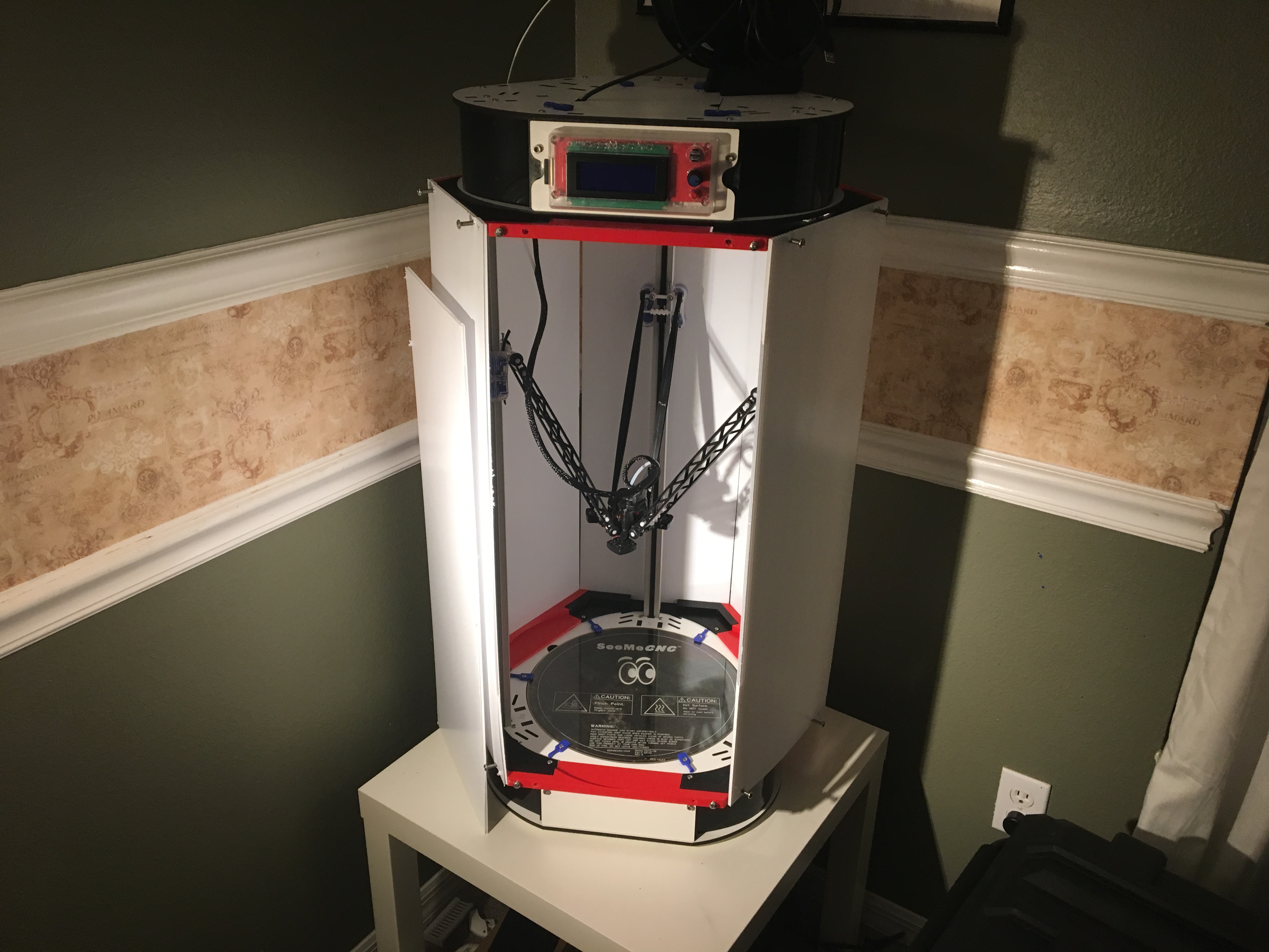

Just need to seal the gaps and get acrylic to make a door.

The brackets that get screwed in need to have the top brackets modified so the skates will Home. Dremel to the rescue.

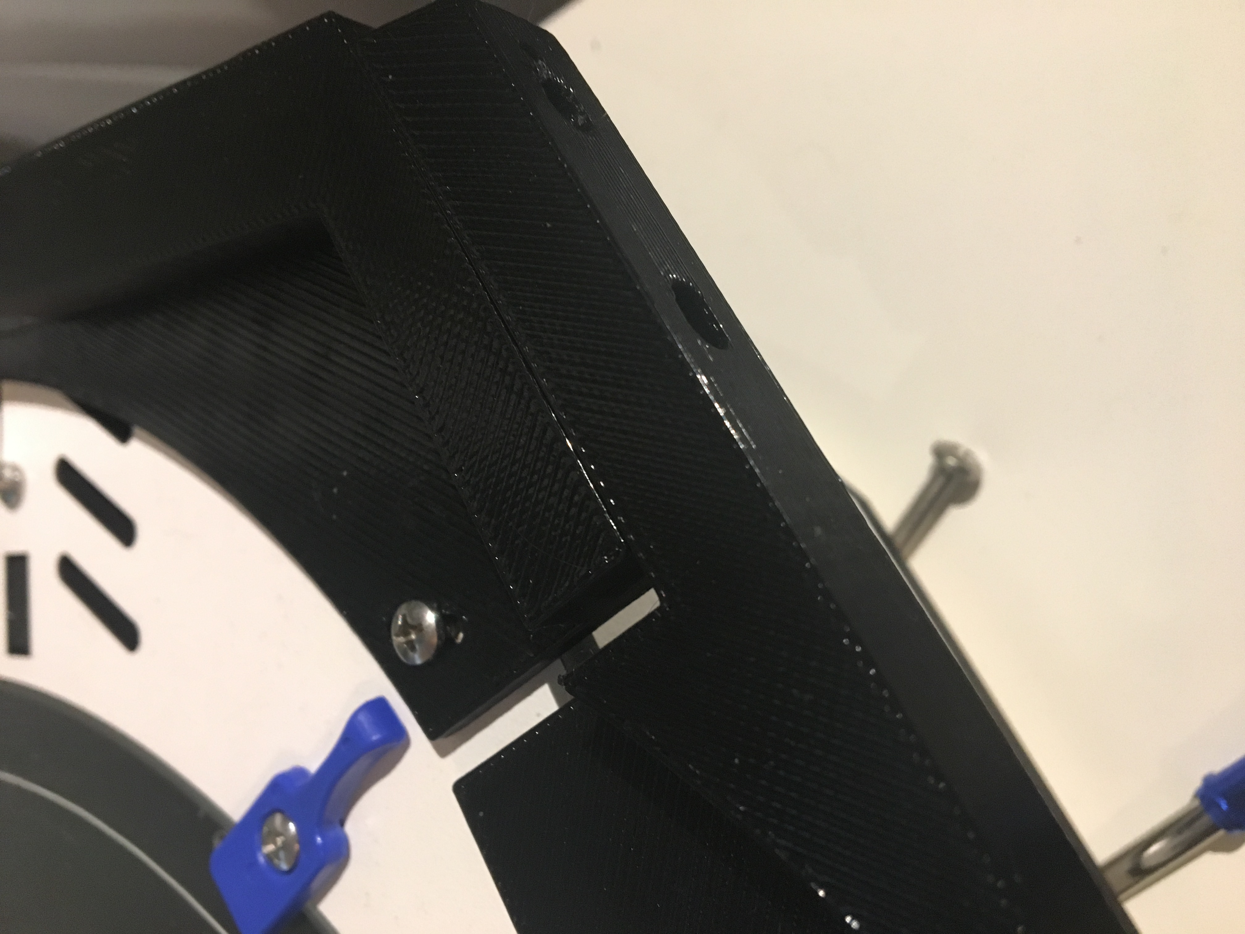

PLA. I did calibrate my printer with the 20mm cube and it came out "good enough government work". I scaled the part up by 5.83mm /2.3% I think and it fits a lot better now. I might bump it up to 2.6% and see if it tightens up the gap a bit more. I now have a 1/32" gap on either side of the flat ...

So I printed it and mounted the brackets that go around the vertical extrusions. The center brackets between the two does not fit. It's too short by maybe 1/8" or a hair more.

Printed everything off and the heat set inserts work perfectly. I'll get some photos of the brackets installed. I haven't gotten acrylic yet and figured out how to make the door yet.
