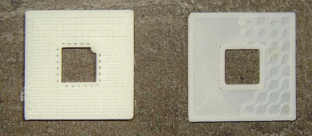

Re: Calibration Cube out of square
Here are my latest calibration prints. The wall is 0.54mm with a 0.5 nozzle and the infill on top of the cube also reaches the perimeters now. calibrationobjects.jpg Here is what I did: 1. I changed to Polygonhell's firmware. Much smoother movement of the stepper motors. 2. I used Cura for slicing ...
I just did a quick print of the bottom layers of the calibration cube with a new 0.35 mm nozzle. I think the settings are not optimal yet. The left with slic3r and the right one with kisslicer. The blob is from interrupting the printer.

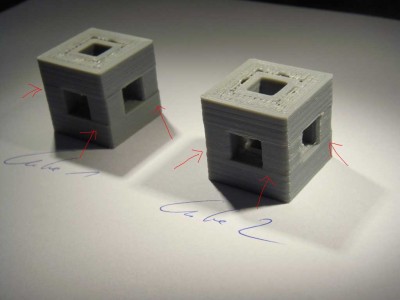

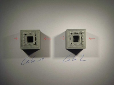

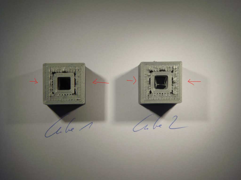

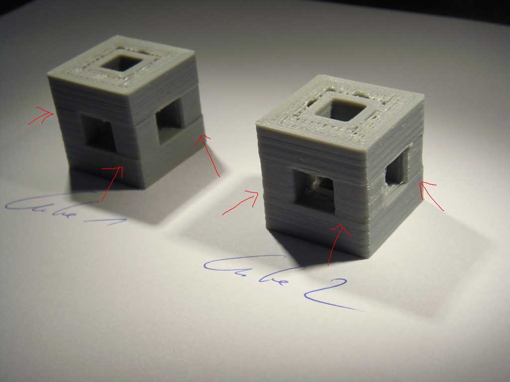

Here are the pictures:
The only difference in printing was the speed. First print was 15mm/sec and second 30mm/sec.
by skyspy
Thu Apr 04, 2013 4:37 pm
Forum: Troubleshooting
Topic: Calibration Cube out of square
Replies: 20
The cheapskates are perfectly stable. I will take pictures of the cubes tomorrow morning.

Replies: 20
Hi! I just finished my Rostock Max some days ago and started with printing the Skeinforge Bridge Calibration Cube as recommended in the assembly manual. Apart from some slight gaps in the infill the machine seemed to work fine. But when I did a close inspection of the finished cube I found, that the ...
