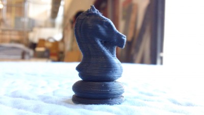

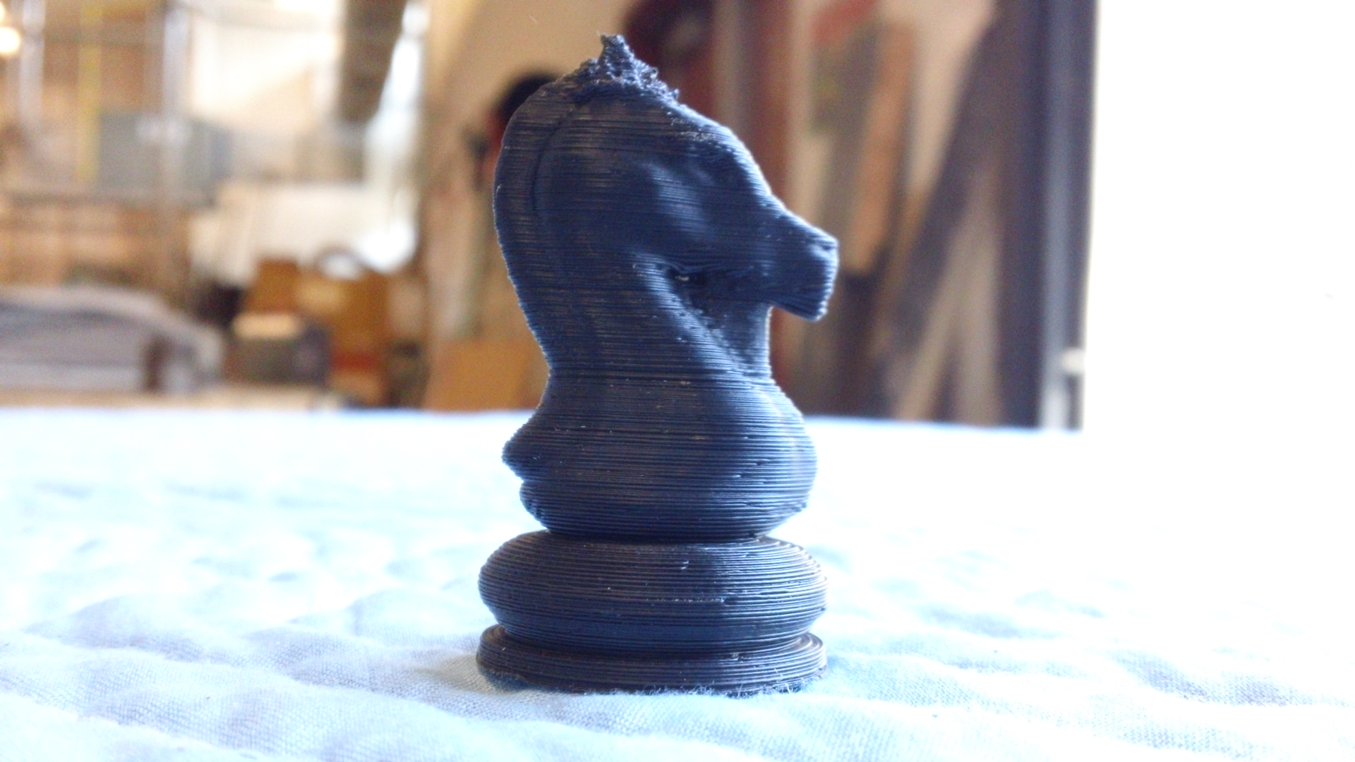

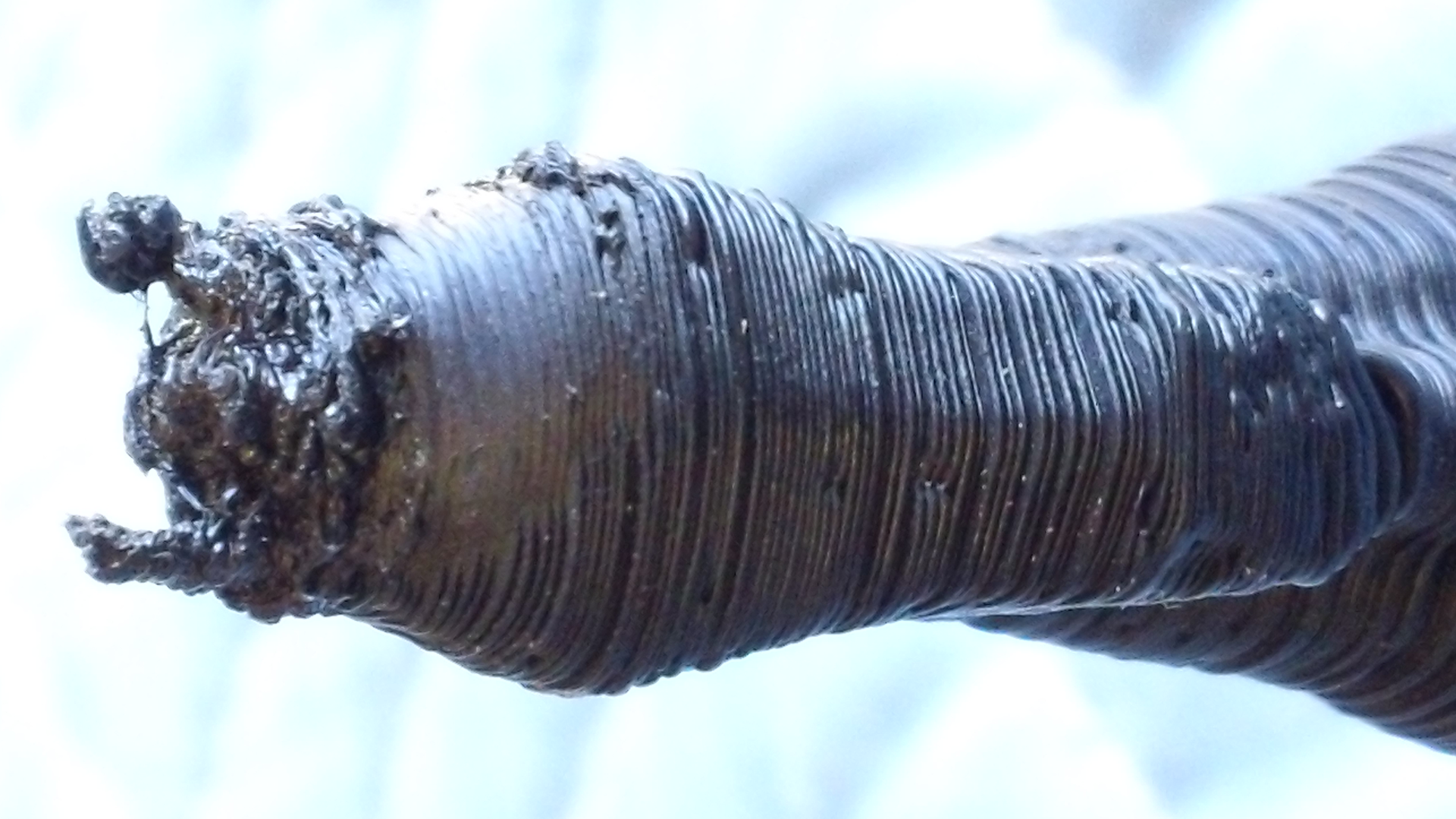

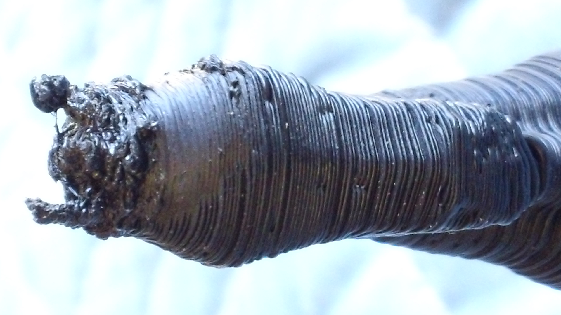

Looks too hot IMHO, I would slow the printer down to 50% when it gets about 3/4 up the head. I agree that it's too hot. I always thought slowing the print speed down would increase heat buildup, though. Am I wrong? In my experience allowing the lower layers to cool a bit before I lay more down ...

Tops of my prints get ruined
Sometimes the tops of my prints get ruined. I am running a H 1.1 on repetier with marlin firmware. 0.2 layer height. Any tips on how to fix this?
