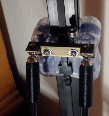

Re: PCB smart effector and carriage adapters for Haydn Huntley's rods
I'm using custom printed adapters on trick laser trucks (max metal) to pair it with an UMBEE. I want to note that the uniformity of spacing matching on the effectors to carriage mounts are brutally important, the result of the calculations still haunt me. My max metal is doing great with an UMBEE ...

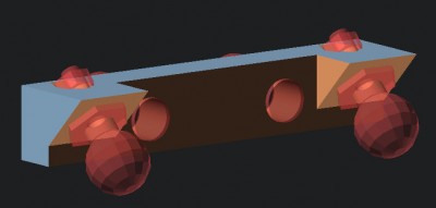

Here's another example. I used the cheapskate.scad from Xnaron's github as the base. You can modify the ball_sep variable from 46 to probably 50 mm without modifying the file further. Right now it's set to 48mm.
moldedcheapskate.scad
(5.31 KiB) Downloaded 1391 times
