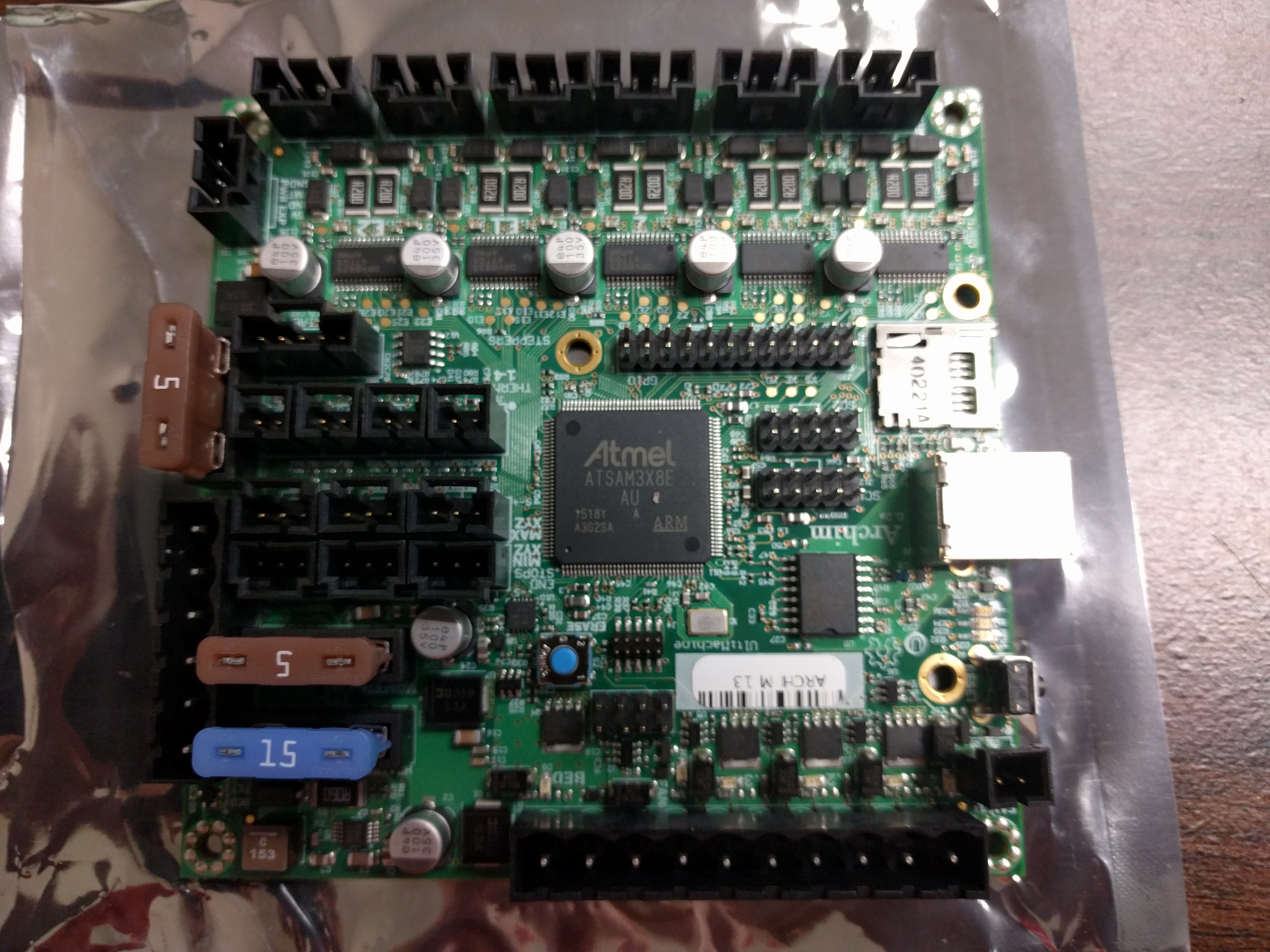

Re: Why isn't horizontal radius calibrated this way?
Yes, we got one for testing. I don't know what the name is. I've seen "Archim" - which is printed on the board - but it's unclear what the actual name will be.
It's likely this...
Basically a RAMBo with an ARM chip...

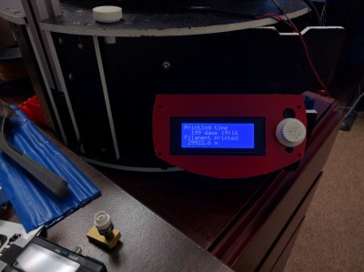

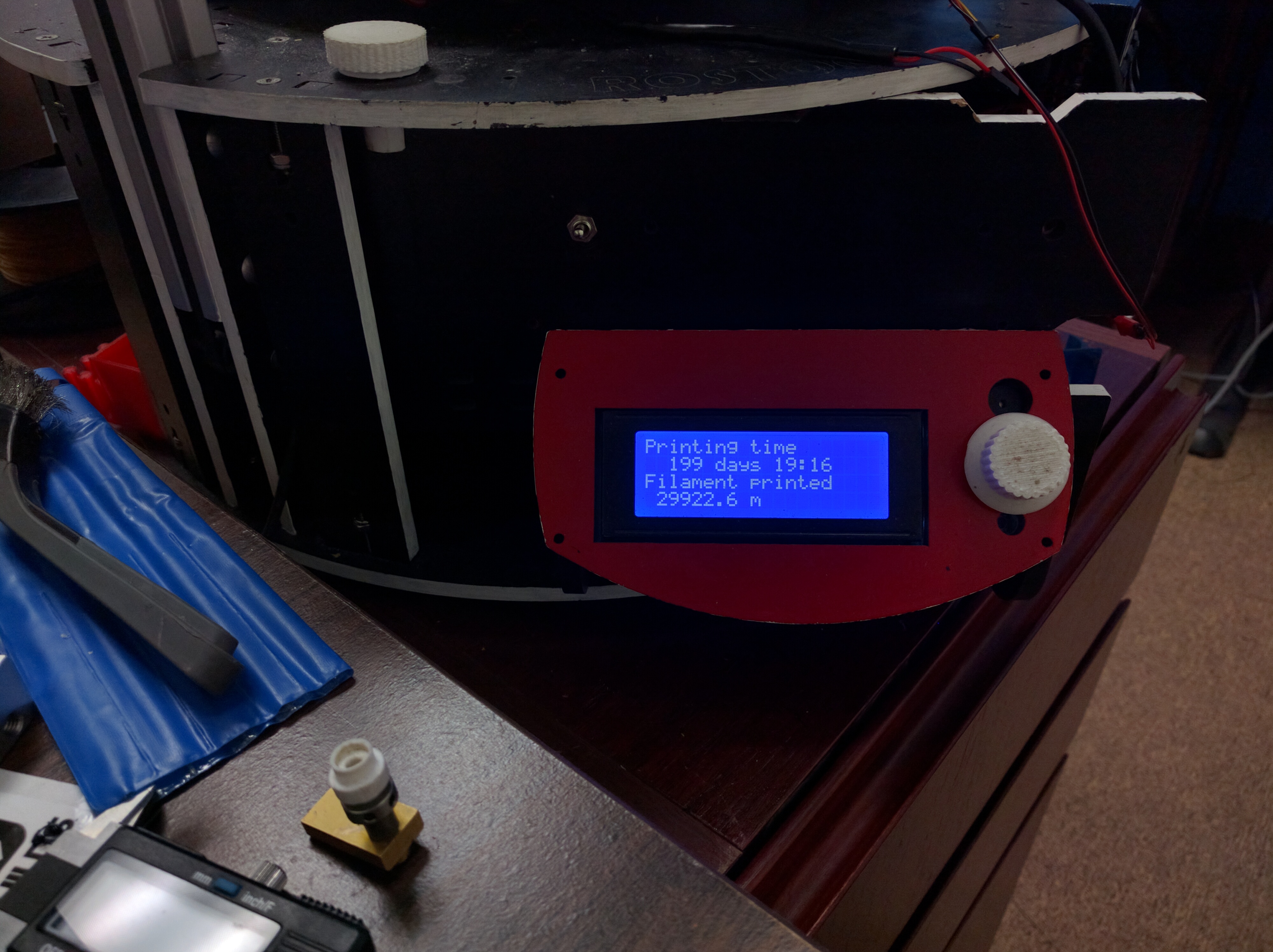

Nearing 200 days...
It's actually a bit more because I was running a smoothie board for a couple months, but my trusty v1 is still chugging along...
