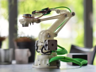

Slightly offtopic, but do you know if anyone is working on an arm solution for "desk lamp" type articulated robots, like this one?
