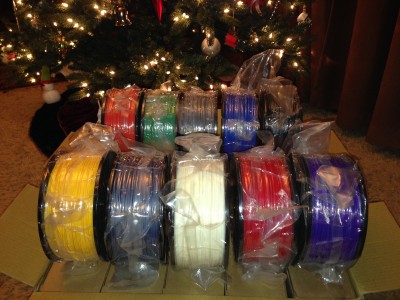

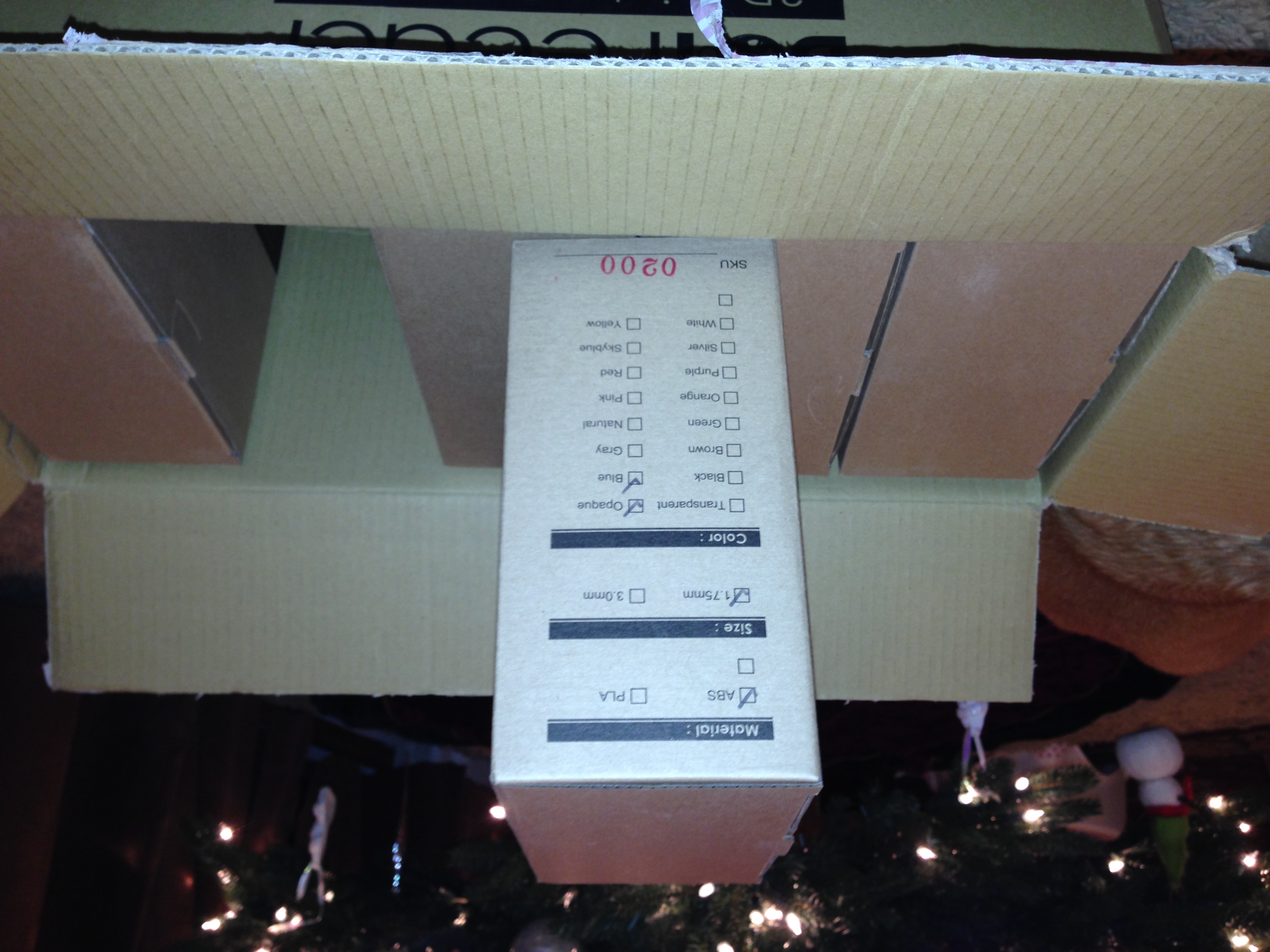

Packaging:
1) The boxes arrived nicely packed in two parcels.
2) Inside each box were 5 individually boxed spools of filament.
3) Each individual box is labeled with its contents in the event you want to store them in the boxes.
4) Each box contains a shrink wrapped spool which also includes a deca pack.
Thoughts…..
1) Botfeeder has done a very nice job protecting the spool during shipping.
2) The individually labeled boxes are nice and make storage easier.
3) The shrink wrapped spool with a deca pack is a nice touch.

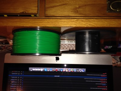

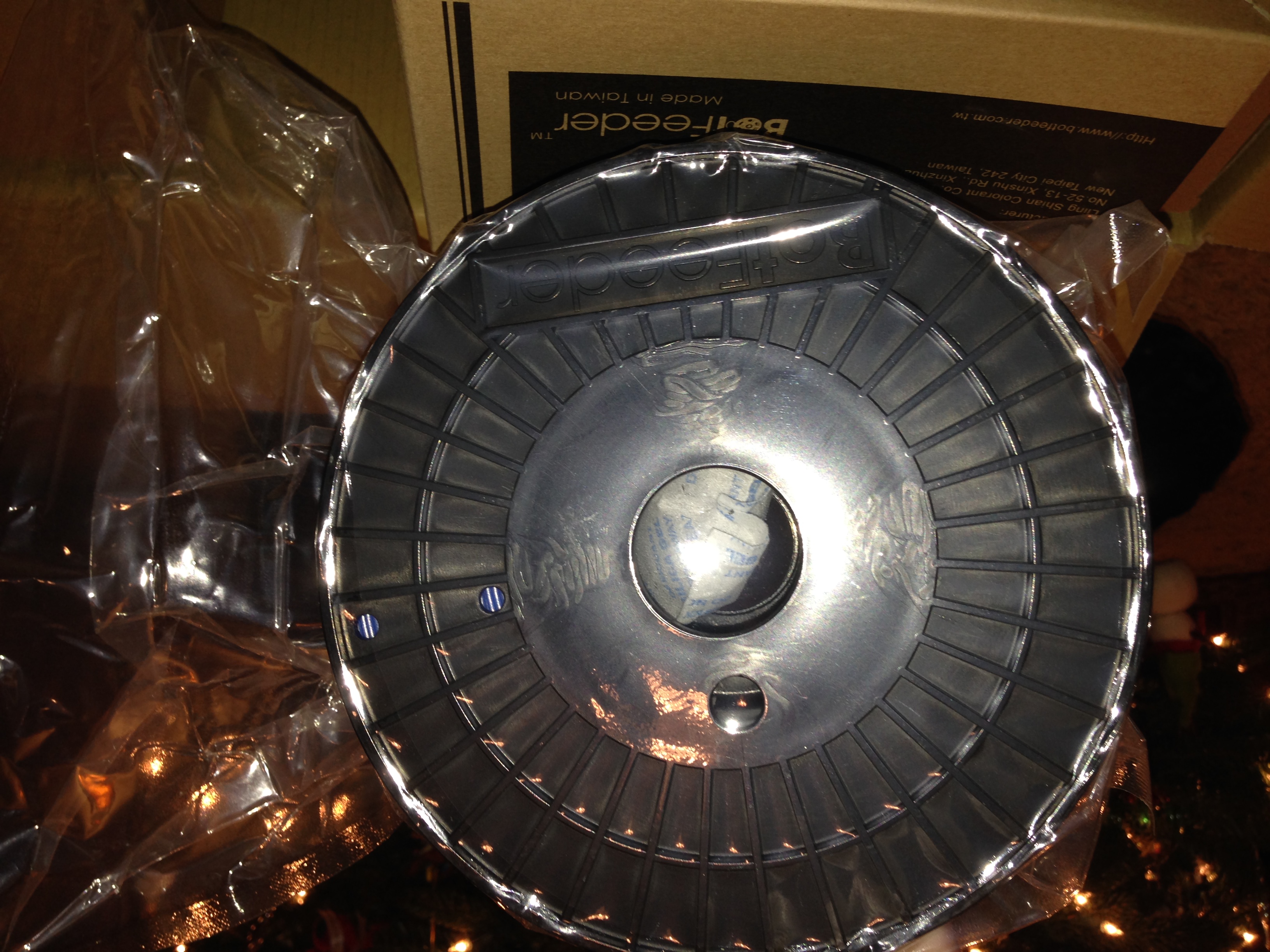

Initial thoughts:

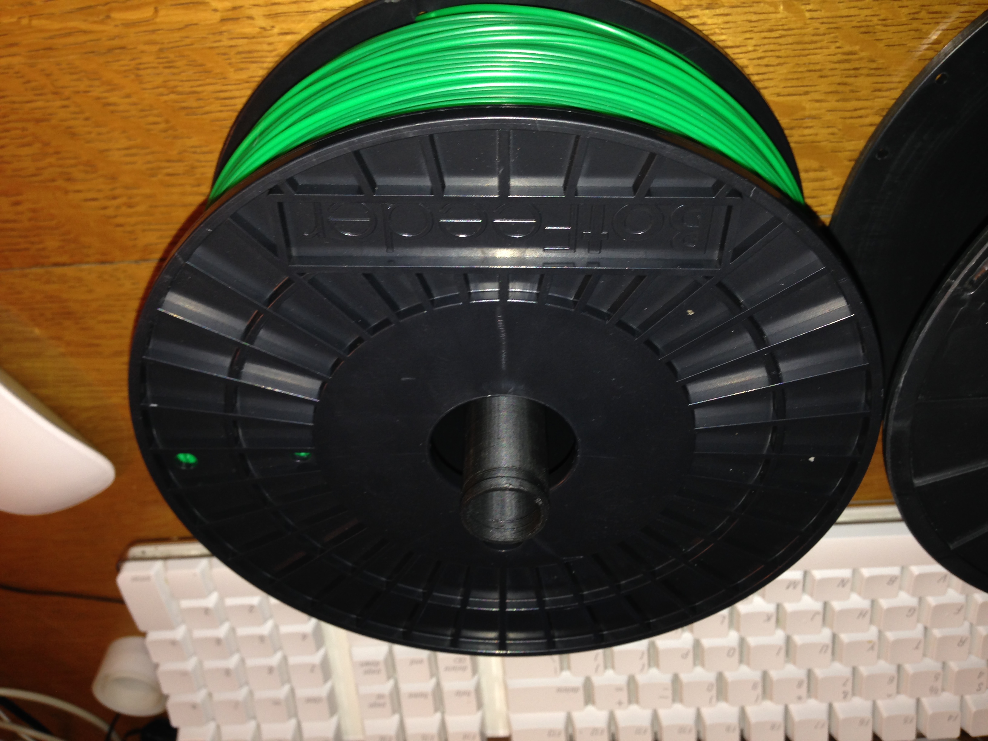

1) The spool is different from what we are used to so some modifications to the max are required.
2) The spool is slightly wider than the SeeMeCNC spool, so the extension pack from thingiverse is required. (Here is an extension made by one of our very own members!!! http://www.thingiverse.com/thing:60322" onclick="window.open(this.href);return false;)
3) The hub also has a different diameter so if you want the spool to fit snugly on the rod, you will need to create a modified hub. (If I create one, I will post it.)
Thoughts…..
1) It is a shame that the spools are not Plug-n-Play for the max, but since there is no current industry spool standard…… It is what it is and other filament brands could have the same issues.
2) Botfeeder posts the dimensions on their website, so I knew about this issue when I ordered.
3) This should not be a deal breaker in my opinion, after all the whole reason you have a 3D printer is to make stuff.

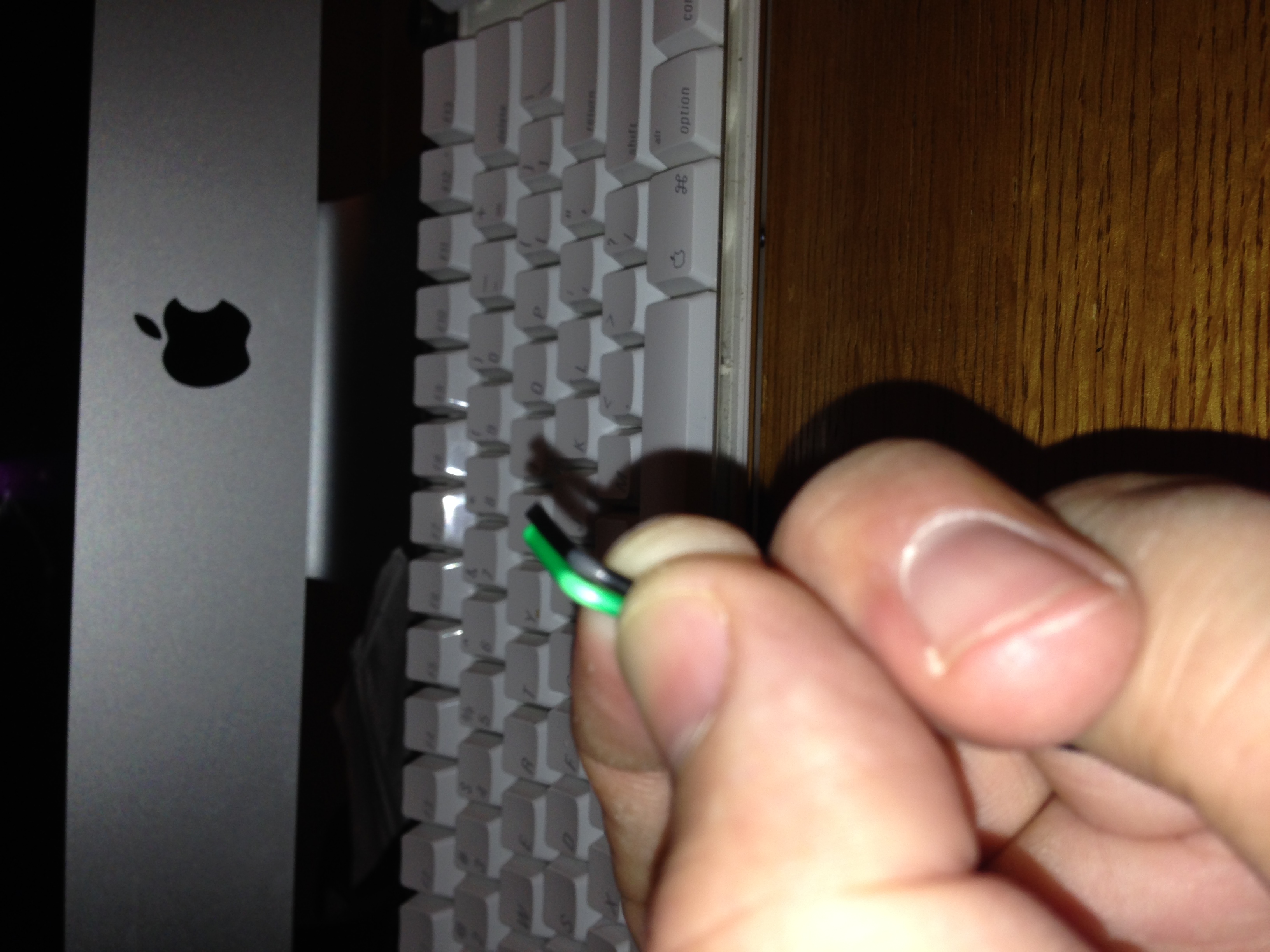

2) Some people have commented that their overseas filament was brittle, so I did a quick flex till ya break test with my SeeMe filament (Black) and the Botfeeder Filament (Green)
3) Both filaments seem to break between 12 and 20 complete 90 degree flex motions.
